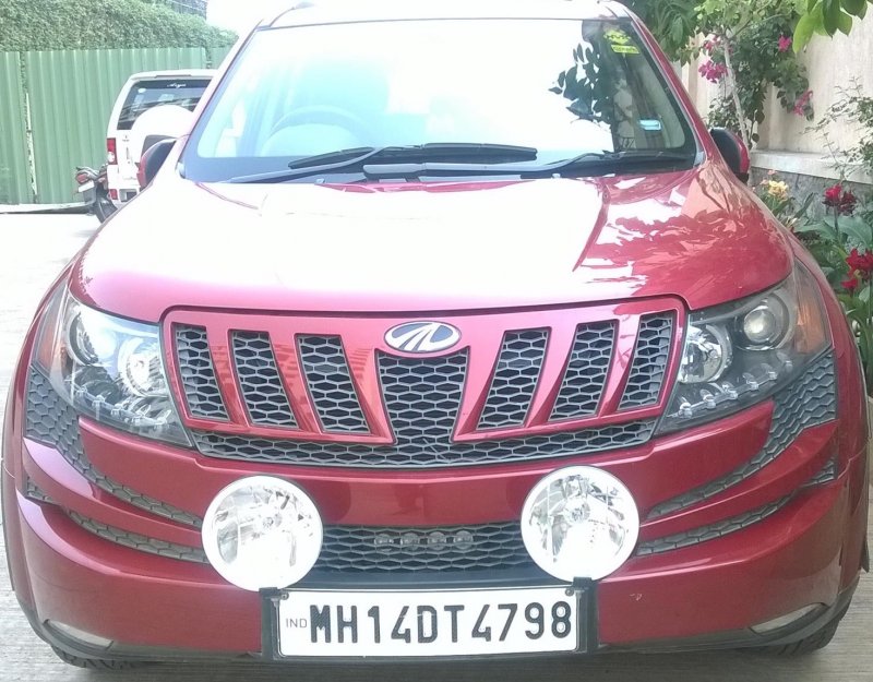

As of now I can say that the range for the stock Hella Rallye 700FFs is close to 400m and good clarity uptill 200-250m.
Cant wait to get the budget approved for the HIDs in the same from Home Ministry [;)]
Post that the effective range should increase to beyond 400m and range to close to a km.

good one Kinshuk, are these too powerful for day to day night driving usage ? how much for hellas?
Also where did you mount it ? closer photos might help.
Thread Starter #276
Feb 26, 2013
916
735

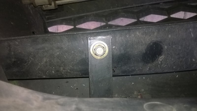

In their stock conditions they are as powerful as the High Beams in XUV when turned ON separately so yes for normal driving in city they are too bright if not focussed properly.
I have mounted them on the Cross member beam behind the lower grill which is accessible by removing the top grill's 6 screws and couple of tabs.
We had to drill the cross member to get the iron strips in place.
Hellas costed me 6600rs for the pair and another 500 for mounting and bracket formation etc.

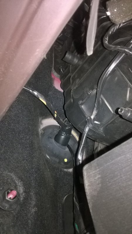

Thread Starter #277
Feb 26, 2013
916
735
Some WIP pics
PLace to get the wire inside the cabin
the rubber grommet which was sliced
Unscrew these scres to lift the upper grill
Cross Member visible
Final mounting of the bracket
