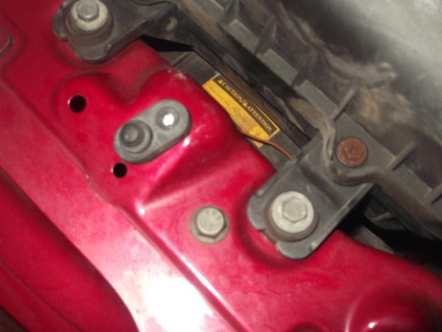

Yesterday finally fixed remote locking. Here I had some confusion. Guys please help me. I have called up Autocop india and ordered for remote locking. That guy told me he will come home and fix it in the evening. Before I go home he started the work. Then I found the box says Piranha. When I asked him about that, he said only for direct fitting in GM's car Autocop will be provided. For others only this will be fixed and showed me the manufacturer name as Autocop India PVT ltd.
Since he had started I did not do anything. And no bill was provided. He told me that it has warranty of 3 years and he can be called anytime. I spoke with KLN guy who gave his number also. He said no problem with him being he is genuine guy.
Cost was Rs.3500 and Paid Additional Rs. 200 myself. He came late home and completed it around 10.30pm.
It has the following features
  • Remote locking
  • Central locking
  • Auto locking in ignition on
  • Auto unlock in off
  • Door open warning
  • Bonnet protection
  • Reverse honking with hazard light
  • Auto re-lock in 45 seconds [When the doors are not opened]. If the doors are opened once then it will never lock until we forcefully lock it. This is to avoid accidentaly locking leaving the key inside.
  • Mute lock/unlock
  • Converting to manual mode [can be used while giving the vehicle for servicing.

Yes I saw him removing it and as well how he routed the wire to both front doors and rear doors.
Wiring pass thru to front door
Wiring to rear door
Wiring from front to back pass thru under the this
I do not know how to fix the light, assume am also getting some side indicators of some cars and fix it, how do I do it? do I need to drill hole?
And also I do not know how to take wire from cabin light
