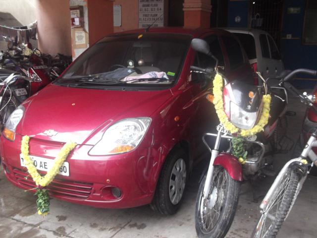

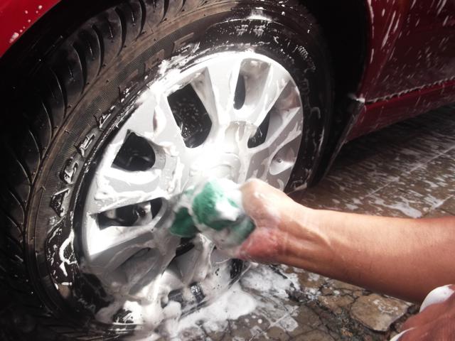

My sparky is getting ready for Autha pooja Celebrations
Before wash
Washing the floor mats
Washing in process
Cont in next post..
Thread Starter #253
Feb 8, 2011
3,863
1,169
The worst part is after our visit to temple in the evening and Dinner while we are returning back it was raining heavily and my sparky is looking very bad now. Tonight I have a meeting for which I need to go home wash her again and go for the meet.
My sparky need to be clean for today's meet since am going to meet VVIP Celebrity of TAI today[;)]
