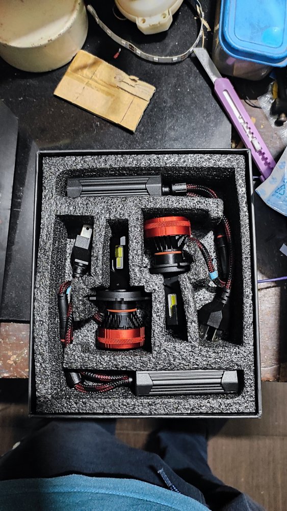

December 2022 - LED Upgrade - Autobahn F5
I wasn't a fan of LEDs with the prejudice that they are not suitable for high beam from their initial versions. Had my friend's Karizma R as long-term safe custody with me, which had an Oscelot branded LED that changed my perception, but never had a plan due to the cost. Unfortunately, that one conked off and he asked me to search a good replacement. After some search and previous queries made by another friend, found this Autobahn model to be decent. Sent him the link. He ordered as a pair and the extra one was my surprise gift.
Model was Autobahn F5 G-XP x3, 55W per bulb and 10,000 lumens each with colour temperature of 6500K. USP was the 2-year warranty. Some more search revealed it to be F5 branded (or model name, like Night Eye), which is rebranded and sold in India by many sellers, with some of them selling at a little over double the price we paid for. We got it for ₹6749 a pair, missed out the coupon code on the top of their website for an additional 10% discount.
The box. No details of manufacturer or importer on the box.

Package.

Initial impression. Beam is so intense that it bounce back from shiny cars and chrome, which can be irritating. Both beams are great, way beyond my expectation.
