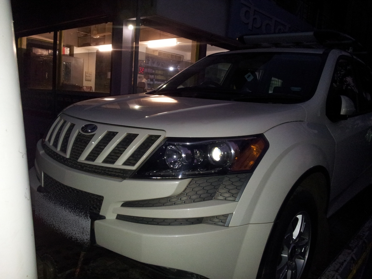

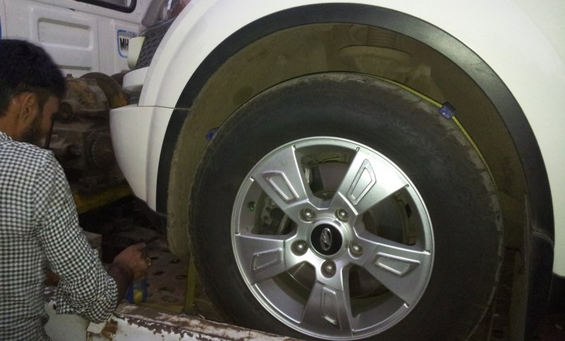

So,
Sent the cheetah in a cage to the zoo.
Well. The Towing guys really messed up the timings. Complaint placed at 10AM, the flatbed came at 6 in evening!
Captured lots of Pics & videos of flatbed for myself.
