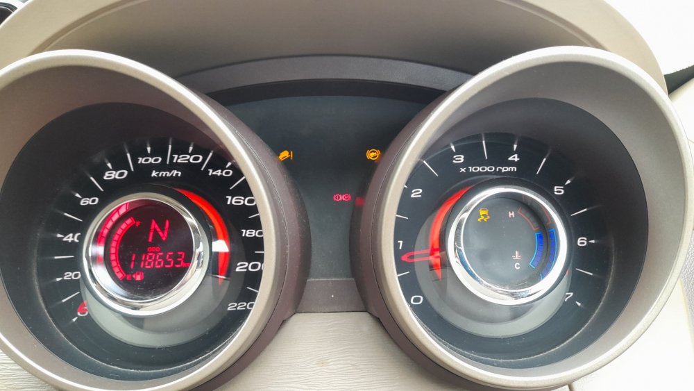

2. The infamous ABS errors-
These 3 error lights are common & famous on Mahindra XUV Whatsapp groups.
After scanning the issue was found out to be somewhere around the cruise control area.
Mahindra ASC asked 2 days of time to open the dash and check the wiring. I have skipped it for now as I can't drop the vehicle for 2 days nor I want the dash to be cracked open.
Currently the Cruise & Hill descent control does not work properly.
