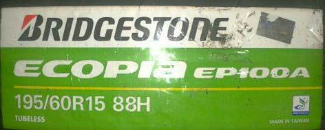

To my surprise , stock B 250 BRIDGESTONE is available at showroom in Pune.
However the owner of showroom suggested me to go for 195/60 R15 , he said for good grip and braking .
Pics are posted but they are not that revealing as one needs to crop them @20kb.while posting from phone.
Trying to post the pics again .
Gurrala pointed out that the ponteza is softer than the ecopia.
They quoted Rs 5400 per tyre for both potenza and Ecopia
