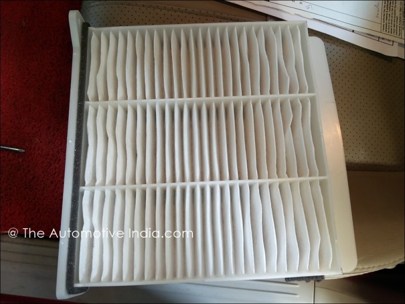

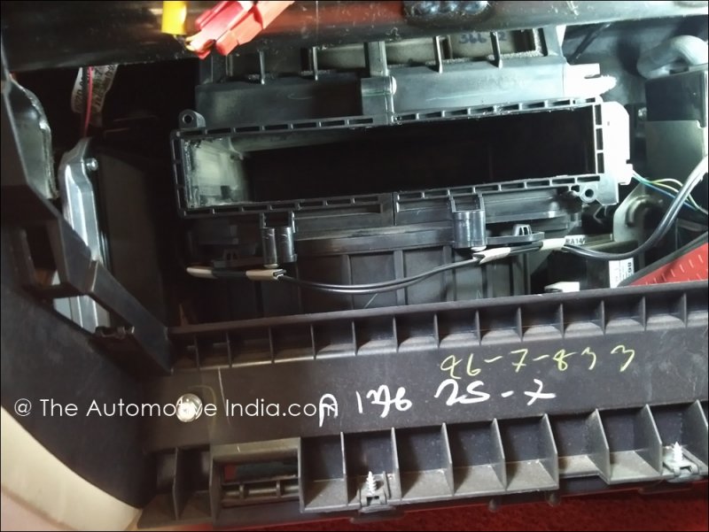

AC Filter installation process :- For some really weird reason the HM has dropped the AC filter in the Pajero Sport, thanks to the tip from A.G i managed to procure it from Thailand and install. I think its now available at dealers as HM is retrospectively fitting it.
Open the glove-box and remove it from the hinges, remove the four screws and take out he black plastic panel.
There is a rectangular AC filter panel, cut the black parts to make way for the filter to go in
The paper based AC filter, Before you install it thoroughly clean/blow the area underneath this panel and clear off all dust from the pre filter era, new PS owners might want to check if this already exists in their cars and if not get this fitted asap. This will go a long way in enhancing the AC life.
Fits, nice and easy and simply bolt it there, mind the direction as per what is marked.

Happy to read that your ownership is niggle free and glad that customizations were helpful. I thought that both 400ms and 800ms settings have only 3 flashes of indicator and that the difference was in Switch acceptance time of 0.4 sec or 0.8 sec to indicate the 3 flashes.
Your post gave me a heads-up to prepare for tomorrow's service as I had no idea (lazy me) about the AC Belt Replacement.
One question - in 2 of the pictures, the red coloured connector with yellow wiring for the passenger airbag is clearly visible. Do you remember how it was mounted? Tips on this would help with the DIY install.

The airbag connector was tucked in i guess, dont remember exactly , can open tomorrow and recheck.
