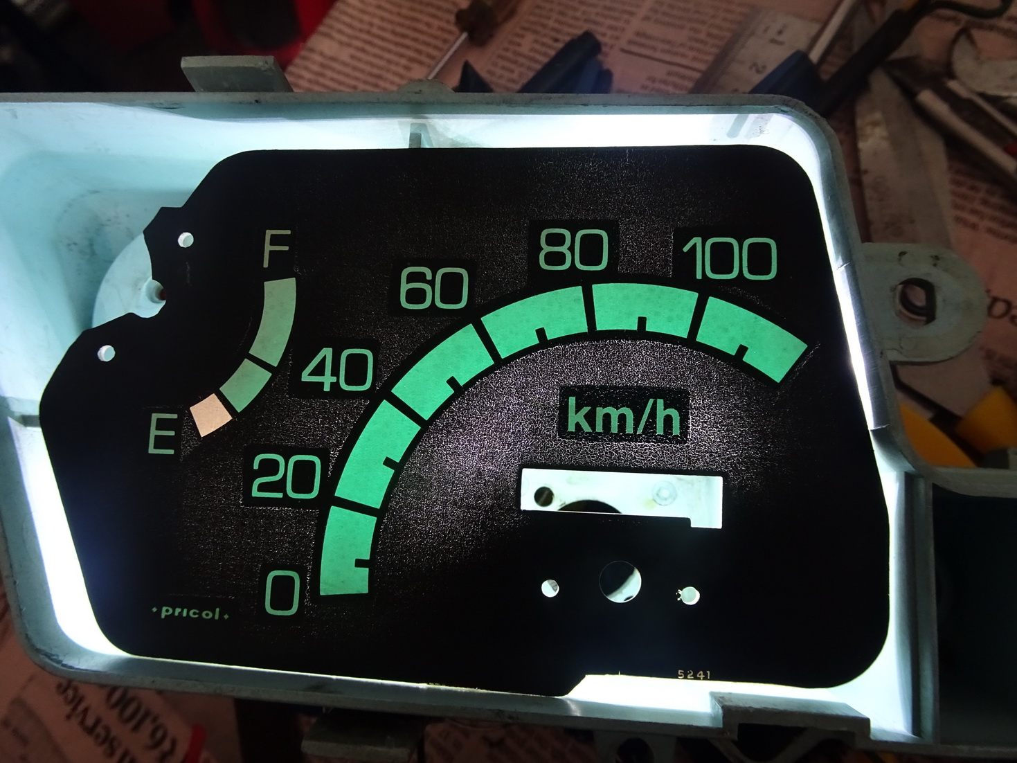

Fixing the fuel gauge.
120 and 220 ohm resistors.
Final. Inspired by @PANACHE
Fixed the broken needle. Wrapped with reflector sticker.
LED backlit. Always ON.

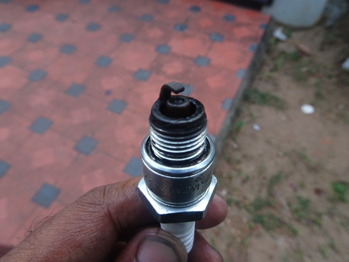

Spark plug was also really dirty. Cleaned the best I could. Barely 4.5k km old plug.

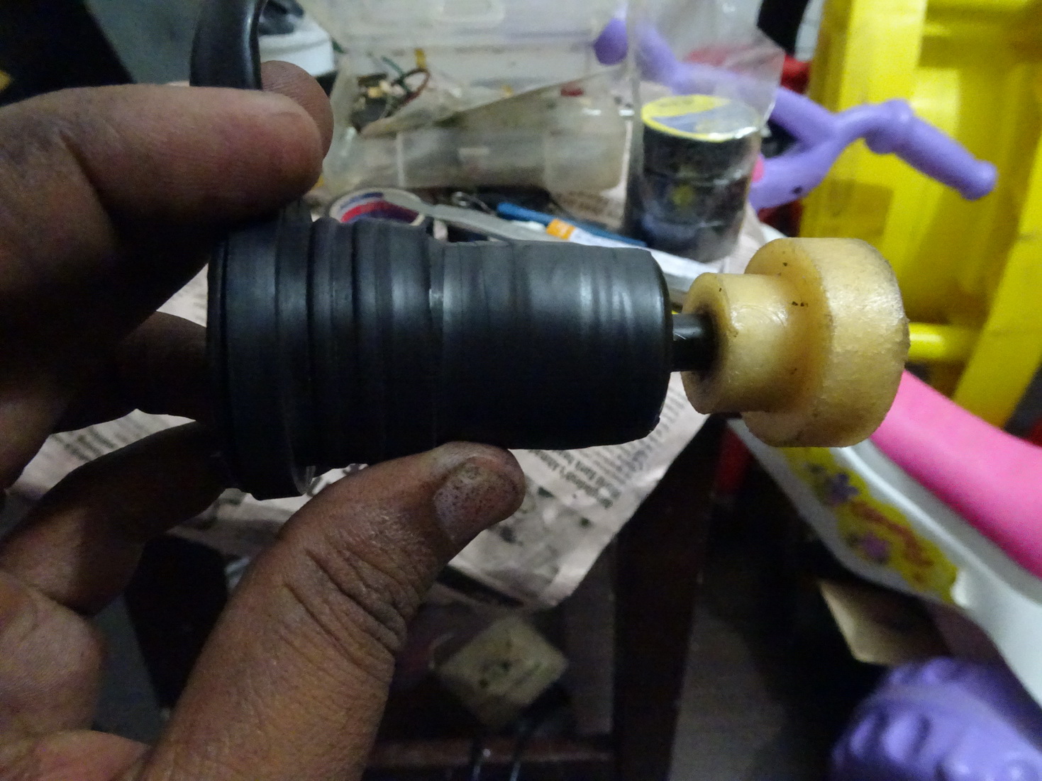

Oil level switch. Had a spare one, so thought of opening one up and see how it works.
Absolute no idea of what is inside.
Cut open the outer plastic shell. First glimpse, its was a capacitor. 4700uF, 16V.
Removed the float. It had the magnet, which operated the switch inside.
It was thick rubbery plastic sealant.
