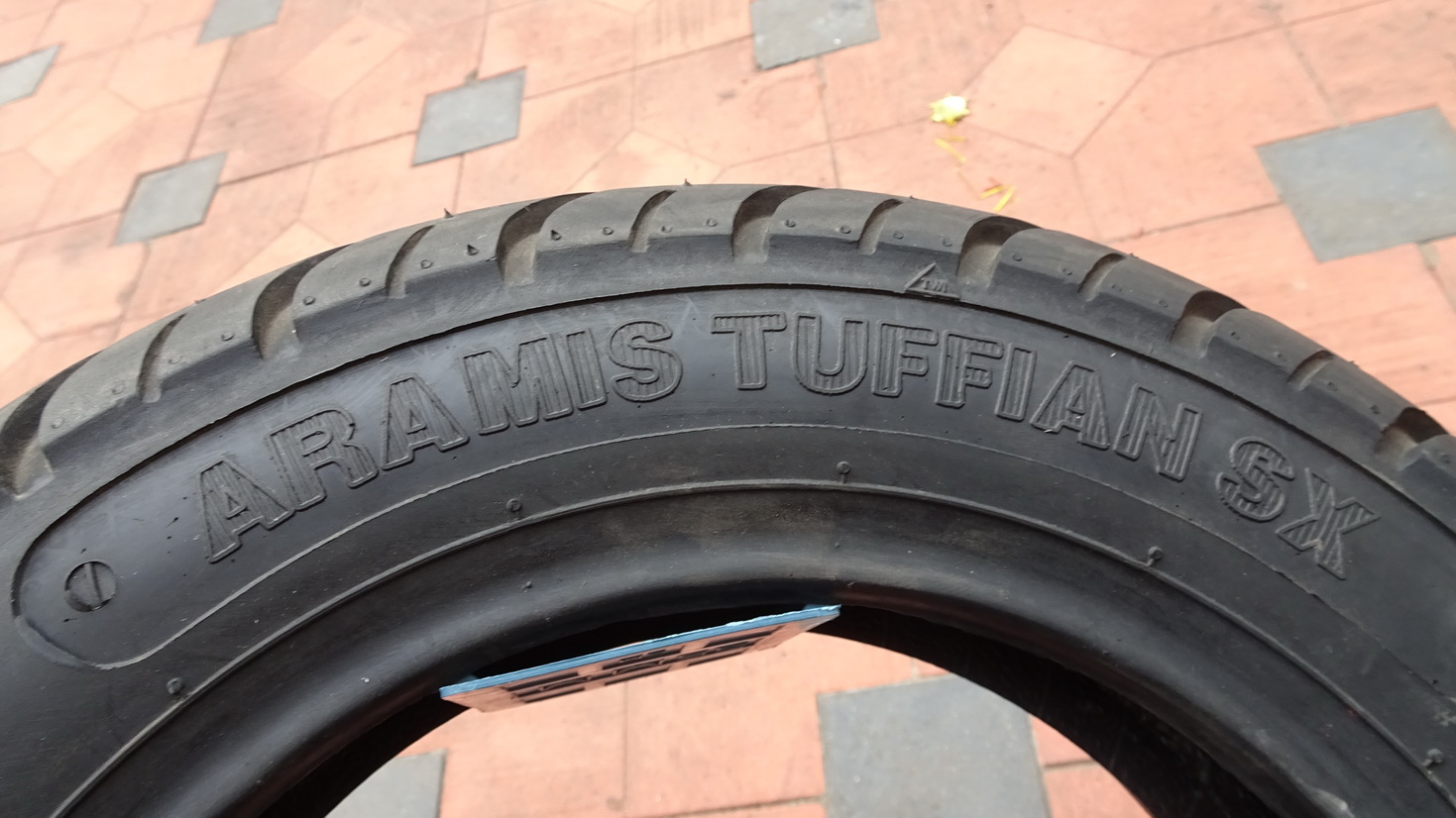

Tubeless dream/disaster.
Aramis Tuffian SX 90/100-01. Paid ₹ 1,400.00. Couldn't find any other tubeless. MRF tube-type without tube was quoted the same. Regret the decision. Tyre is good, but all the efforts gone waste. Had to put tube. Tyre is so hard, damaged brand-new rim during installation. Bought 2 tubeless valves, a cheap rubber one and a costlier metal one. Could have bought MRF and saved at least ₹ 200.

that unconditional warranty still says 'conditions apply'. what irony!
I guess the problems cropped up due to Scooty tyre which is smaller than kiney. and please don't trust 3m tapes for number plate. put a single screw Atleast.
90/100-10 is stock size (similar to 3.50-100)
Tried and trusted tapes. @Vichu's amaze plates run on 3M tapes [lol]
