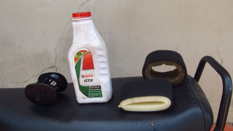

Changed air filter and spark plug today.
The filter box
Opened.
Old filter plus frame.
Filter foam removed from frame. 4T oil for soaking.
Soaked filter.
New filter on frame, ready to install.

After changing the plug and filter, cold start and hot start issues resolved. Today, it started at 1st crank after untouched for 2 days. Normally it would require kicking 4-5 times, now no probs. In recent times, there has been issue that required kick starting when engine is warm. It is also gone. I believe the crap plug caused all the trouble.
