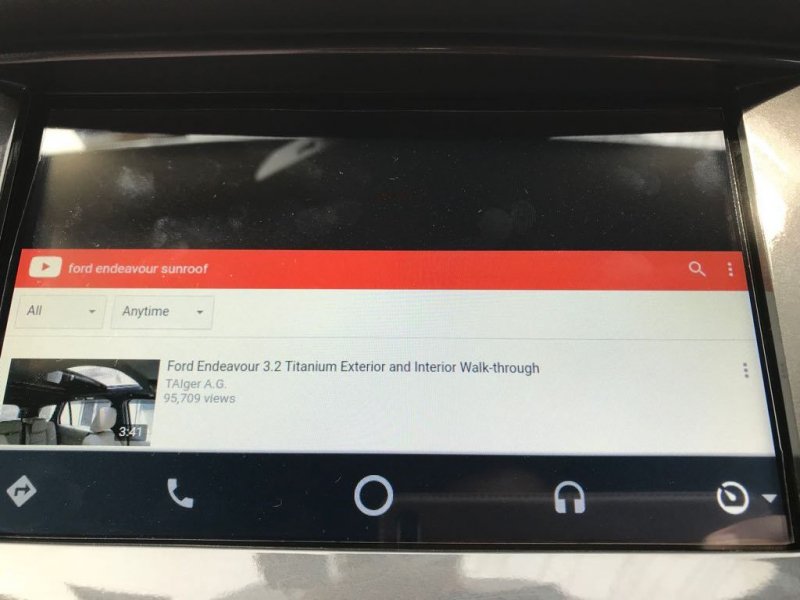

b. CarStream: The default SYNC3 system cannot play videos. This app allows you to view YouTube on the SYNC3 system and can even play the video files stored on the phone. Goes without saying that this app should be used responsibly when the vehicle is not moving.
Screen to search
Searching for my own video
Enjoying the video of my truck in my truck
One more shot of the priceless feeling

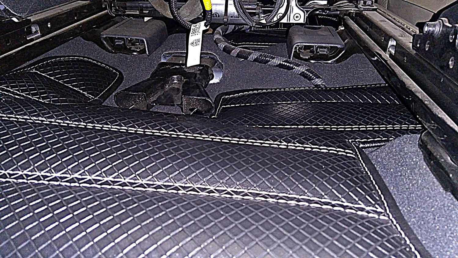

Changing the Foot Mats
The original mats from Ford are good but quite short in size. Found a set online which had good reviews on Amazon.
These mats don't offer any dust absorption due their material but the material itself is non-skid. They cover the carpet completely to the extent that it reaches below the seats too. The fit is good and has properly designed cutouts.
The complete set
Driver's side mat covering entire footwell
Finally middle row mats covering the floor hump as well...
... and below the front seats
The 3rd row mats also extending below middle row seats

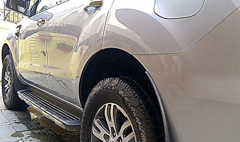

Aggressive pattern on the sidewall
The complete sidewall
Fitting just inside the body
Having covered close to 900 kms on the new tyres in a week, initial observations look promising. The transformation in comfort is most prominent – gone is the sharpness of any bump and it feels like you are literally floating over broken roads even at 32 Psi all around (MRF were back breaking even at 30 Psi). Grip in wet is quite good and it kicks out an exceptional amount of dirt from the road. Noise is well controlled as of now and I hope it stays that way. Only drawback is that it catches small stones very easily and the wider footprint might affect FE.

How is the ride currently as you would have done more kms.How much did it cost you? Does not seem to be available in Chennai.
Having covered close to 9K Kms on the Nexen tyres, the ride is good and grip levels are definitely great. Only downside is the number of punctures probably due to the large gaps in tread pattern.
I am planning to buy one too, however, I have been told that the middle row is too bumpy.. can someone share their experience on how bumpy the car gets? if it is bumpy can that issue be sorted by some adjustments?
Never felt the issue. Also, with the Nexen tyres, the ride is almost close to Pajero Sport and is better at higher speeds. Rest of the competition (especially Fortuner) cannot match the ride quality of the Endeavour even with stock tyres.
