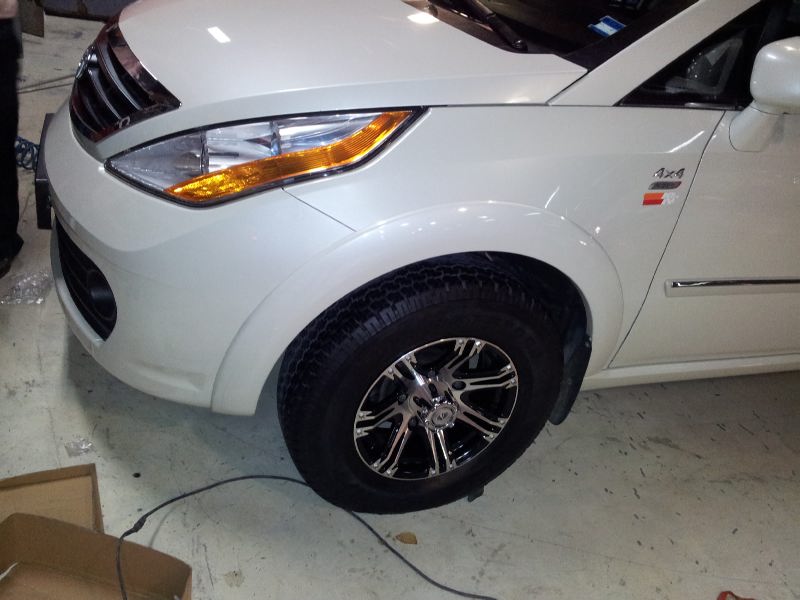

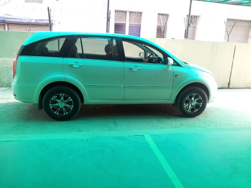

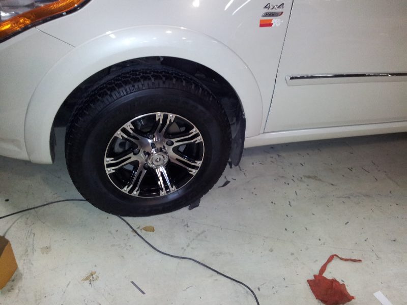

Hi as promised snaps of New Set of Alloy Wheels:
Uneven Tyre Wear
Front Alloy 1
Front Alloy 2
Side Profile
K&N Sticker only
Side Profile 2

your alloys look yummy, dear tornado !! Can you please explain what bubbling at 80-90 kms means ? do you mean to say your car wobbles or something like that ?

Re: Tata Aria Pleasure 4X4 a.k.a. The Chronicals of Saphira
Thanks for the compliment,
Yes it is the wobbling (minute now) at speeds between 80-110 kmph. or while braking from those speeds to 50 kmph. This has started after alloys and tyre swap from rear to front and vice versa. As per autozone mechanic run the car for some 500-600 kms and let the tyres set in properly, as they have uneven wear, so let them settle first and they he'll do another round of balancing.
I have also dropped the message to Autozone that if any brand new vehicle with Bridgestone tyres swap with some other brand tyre than let me know so that i can pick up those new set of tyres.
