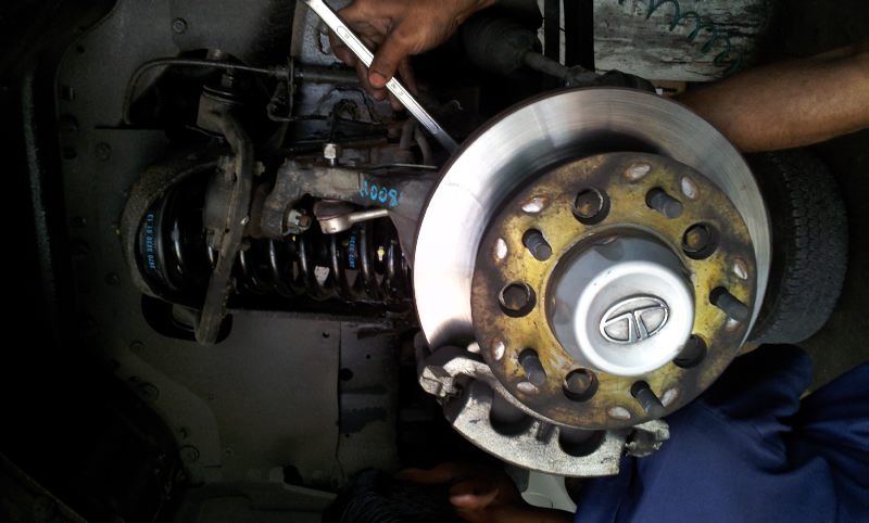

Issues: As i already discussed the issue of Front Left Shock Absorber Leaking problem, it has been replaced under warranty last saturday and other minor issues were also addresed except the issue of Seat Squeaking.

Will update on email proceedings, and also post pics of shock absorber later in seperate post which i clicked on last saturday.

Rest is fine, as promised uploading pics of changed front left shock absorber:

Yes, the shock absorbers (front) were upgraded from TML just 2 weeks back as TML wanted to plonked upgraded shock absorbers in initial lot of Arias.
After a week or so the left one started leaking its oil, no one knows how that happens, as even i dont remember that i have gone into sudden bump or pot hole, But the right one is intact.
Infact, after upgradation of the Front Shockers the ride became much more pliant and controlled than the previous gen shockers.
Now its almost 2 weeks and Shockers are doing good job. May be (thats my assumption) the shocker which was installed on left was not of a good quality (as they are procured from a vendor). It was a sealed packed Shock absorber which was installed.
So cannt say that this is the TML fault as the replacements/upgraded shockers were directly shipped to service centres from the manufactures in a sealed box.
