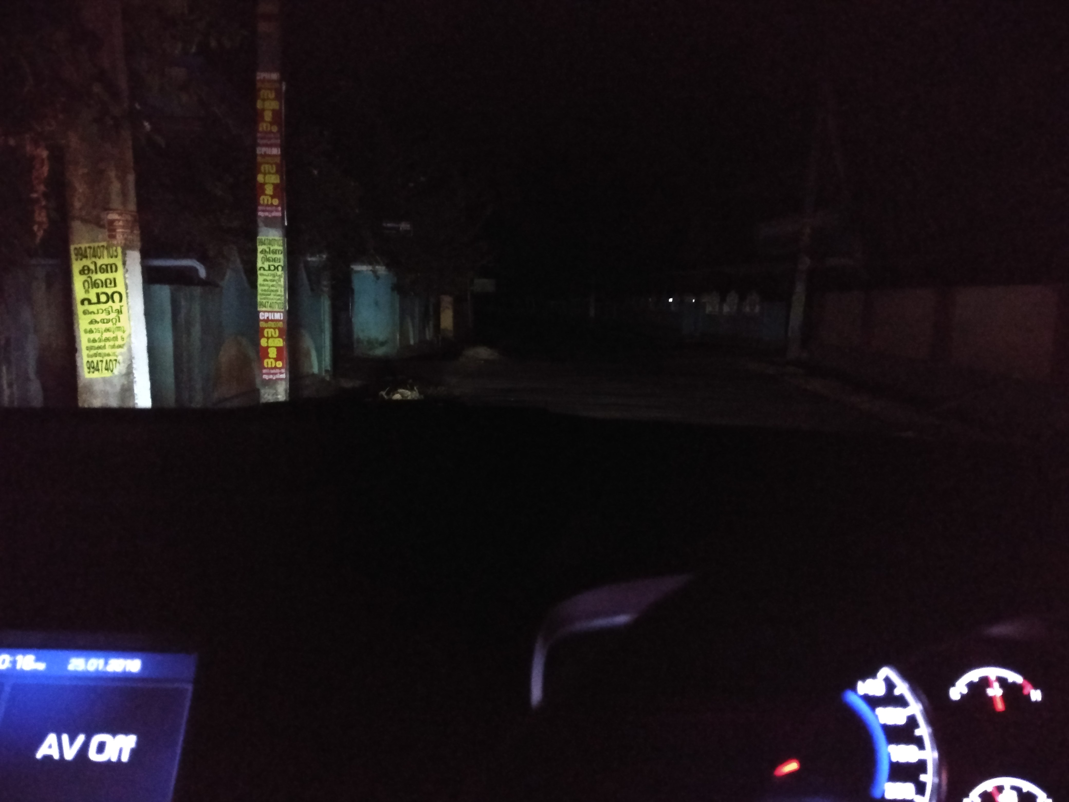

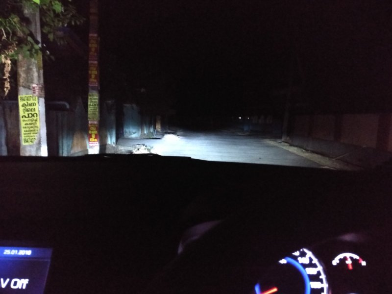

Have put the LED's lights to good use during last weekend. On dark roads, the lights are simply brilliant however on well lit streets, beam is hardly visible. I'm waiting for my LED fog lights to be delivered. Can't wait to see the results. Here are a few pictures i clicked. First 2 pictures are low beam and high beam pointing at a wall from 10 feet distance . Last 3 pics are, nolights, low beam and high beam respectively.

Your car could easily be the best example of LED retrofit compatibility. The both Low and high beam have kept their definition and there is no stray glare. Even the distance in High beam is excellent! Good job
BTW, what car is that?
Thanks bro, it wouldn't have been possible without your valuable suggestions [clap]

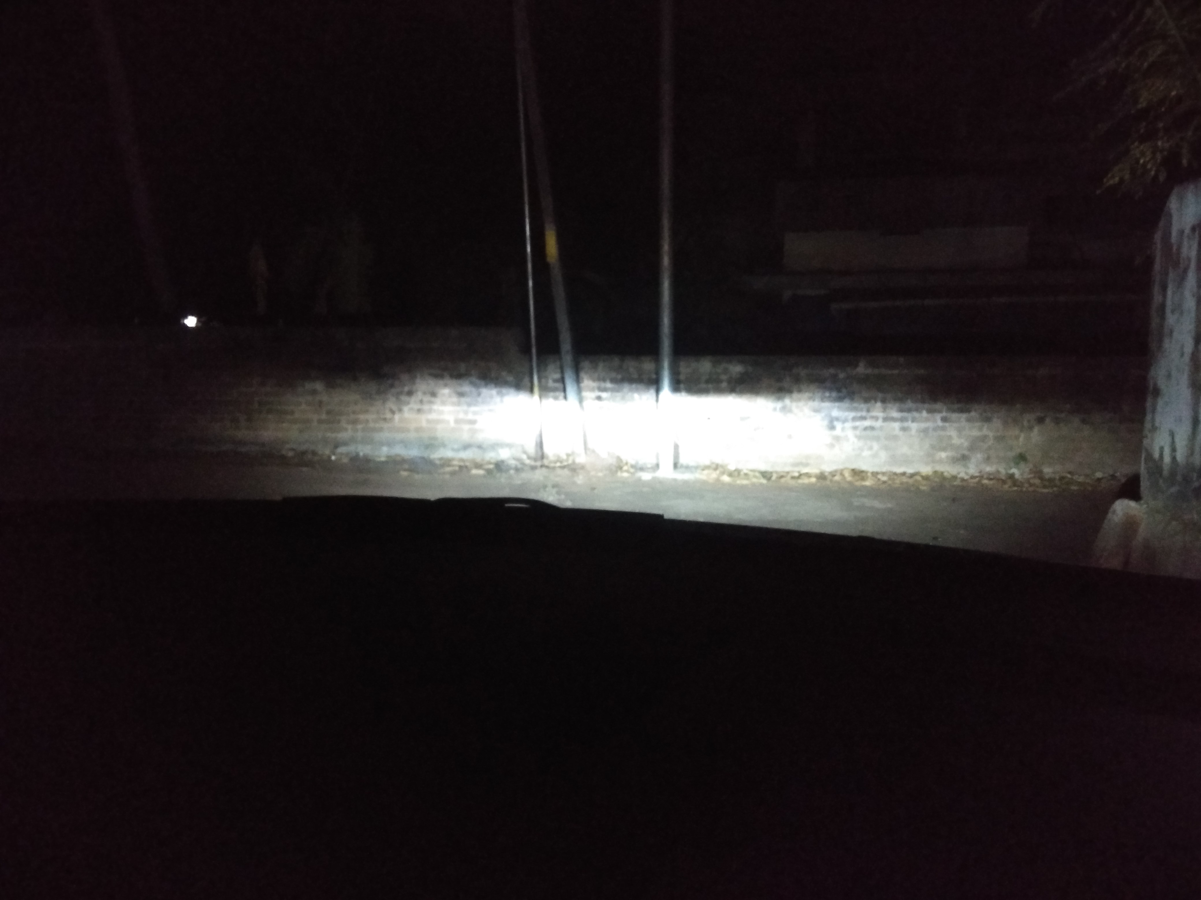

You fixed the HID in the stock fog lamp reflector? How is the lighting? Any photo of the beam?
Yes do post pics.
Hids in reflector fog housings provide a good output atleast in XUV as demonstrated by bhvm sir in this forum.
But reflectors for different case are different. So please post some pics. If it's good many Verna owners may benefit from it.
Here ya go
The photo is not of the best quality and due to auto exposure settings they are not very accurate. The HIDs have a very wide spread. Now this may sound wrong, but the glare caused by HIDs is actually very useful to spot motorcyclist's without any working tail-lamps on highways. Again, I don't use HIDs in the city as XV are enough on roads with street lights.
