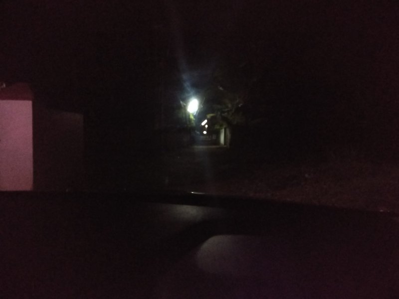

Finally got the LED bulbs from Aliexpress.I choose the 25W, 4000 lumens per bulb fanless model. It took a good 20 days for the product to reach Kerala, India. Please excuse the poor quality of the pics. My mobile cam isn't great at low light. I wanted to point the beams at a wall but could not find suitable location. First pic is just the street light, second with only fog lamps on, third with fog+ low beam LED, 4th LED high beams.I read online that the throw of high beams on LED's headlights can be poor but this bulb has a very good high beam throw, in-fact the throw is atleast 30% better than Osram nigh-breakers. Low beams has a decent cut off. High beams are very bright and lits up the road well. The best part is, only a single flash is enough to make oncoming traffic to switch to low beam.I'm satisfied with the upgrade. These may not be the brightest LED bulbs around but certainly much better than premium halogen bulbs such as OSRAM NB and Philips XV.
These are looking good!!
Please share the name of the car, stock bulb type and the item link from Aliexpress.
Also if you can try to post a photo on a wall for beam cutoff. Shopping mall parking lots are great for this.

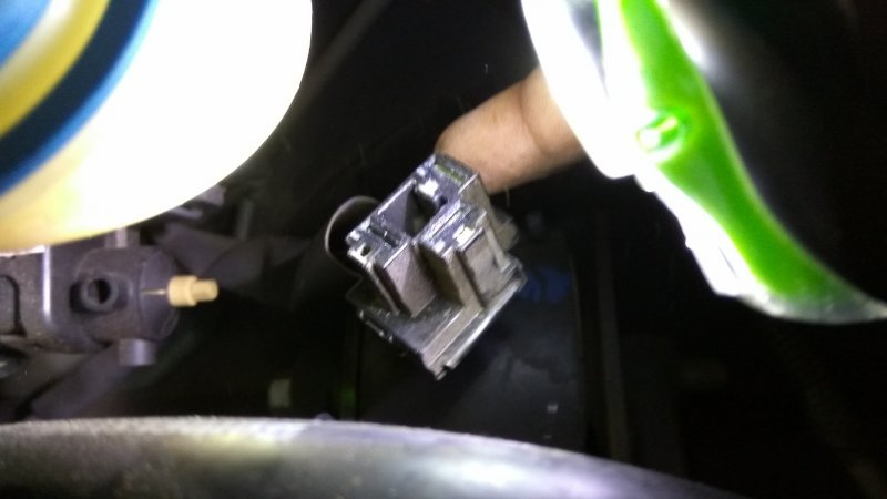

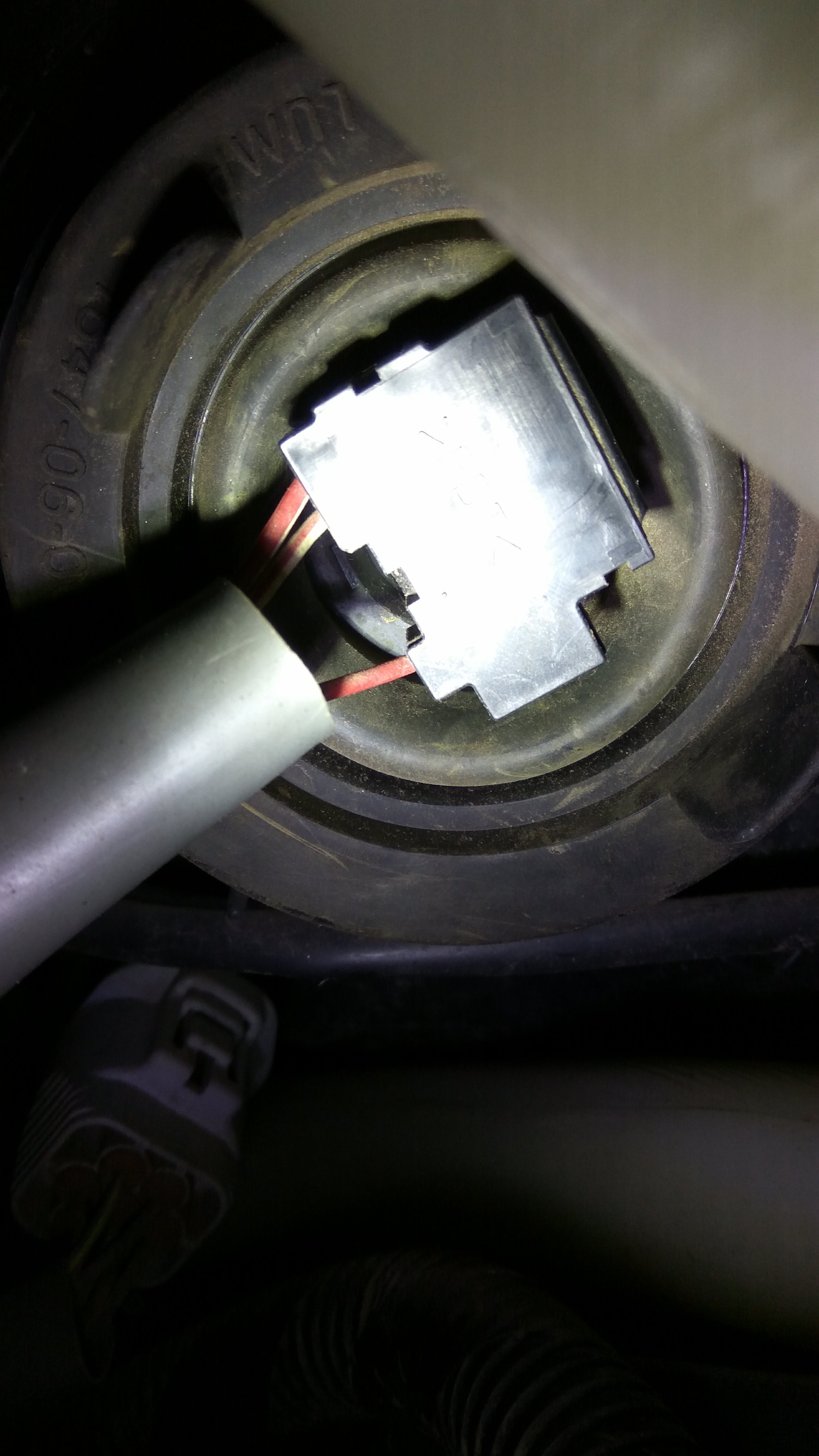

Question to Experts, Is it possible to install the above-linked bulb in MS Ritz? I'm attaching the picture of my dust cover, please find below.
Dust Cap from Lumax
Inside View
Back of Head Lamp
H4 Connector
Connector Fitted
Thread Starter #374
bhvm
Oct 15, 2011
5,289
4,818
Some Village
You are one of the lucky ones where the heat sink can actually seat outside the rubber boot, without cutting. Yes, you may install the LED without any fuss. Just unscrew the heatsink, pass and install LED bulb through the boot. Then screw on heatsink.
