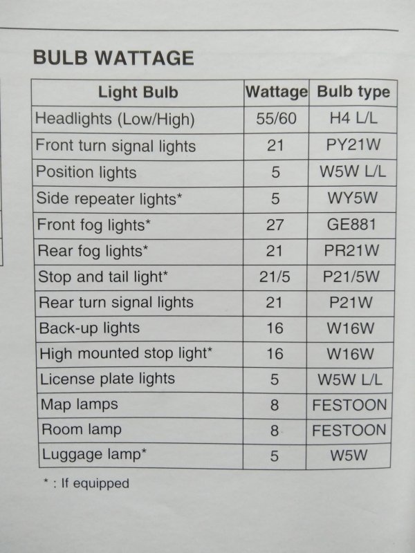

Also, i'm planning to slowly change all other bulbs to their LED equivalents; starting with brake lamps and rear turn signals bulbs. I have attached a picture from owners manual with the bulb types of different bulbs used. if anyone has a idea about where I can buy led replacements for brake lamp and turn signals then your inputs will be much appreciated.
