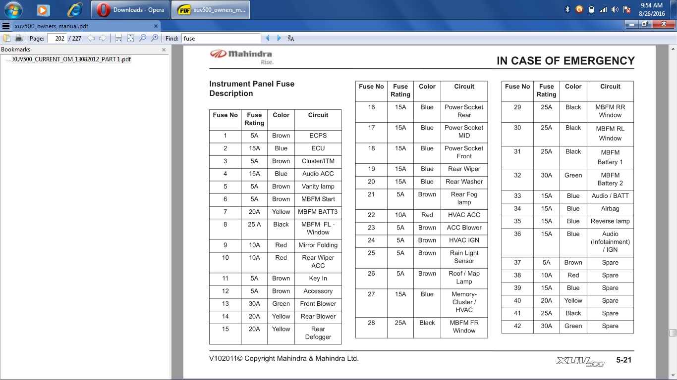

Thanks man. Found the same in the owners manual yesterday night. No idea how it shorted. Found out when I had to test an air pump.
Thread Starter #335
Feb 26, 2013
916
735

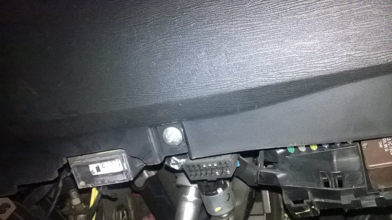

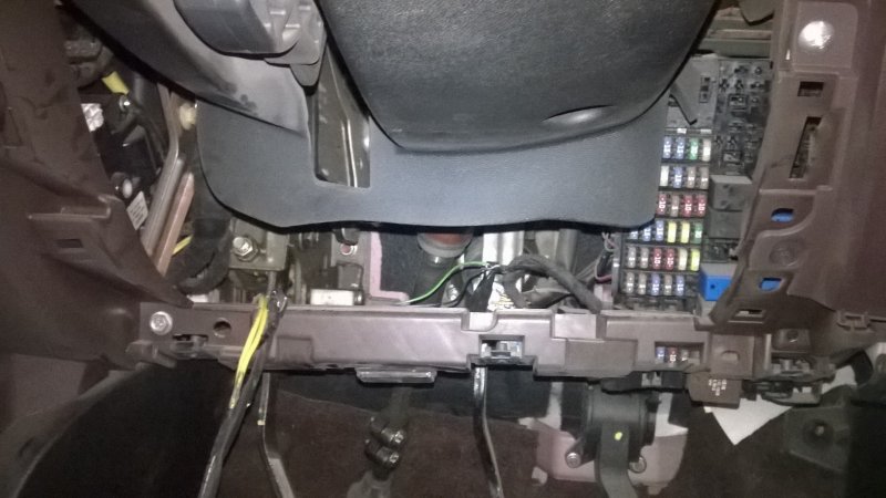

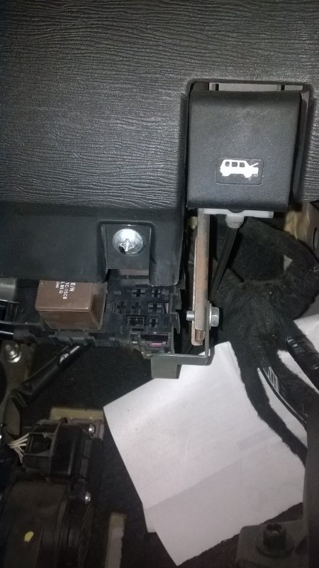

So I managed to reach the instrument panel's fuse box, it is inside the panel beneath the steering wheel. To open the panel you will need a cross screw driver to remove 3 screws and a flat screw driverr to pry open the panel, after you remove the panel you will be able to see the fuse box.
The culprit in my case was the power socket fuses which were blown away may be because of the air pump which I tested earlier, because I havent used the mid and 3rd row sockets any time.
Here are some pics of the same.

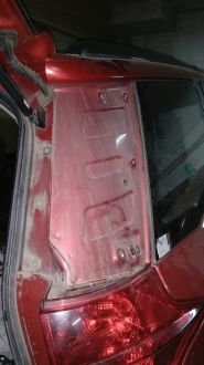

I was finally able to replace the brake light bulb in the Optimus,
It is in no way an emergency repair.
To replace the brake light bulb you will need:
1. A Philips screw driver
2. Number 10 spanner,
3. LUCK
first of all open the 3 philips screws on the black cladding above the tail light, now apply your luck and muscle to take out the balc cladding, it is being held in place with the help of 4 more clips which you will have to pry open, chances are you will break at least one clip while removing.
after removing the black cladding you will see another philips screw holding the tail light in place, remove that and the 3 bolts the tail light should come out easliy now.
once the tail light is removed follow the instructions in the owners manual to replace the bulb and the above process in reverse to put the whole thing back together.
