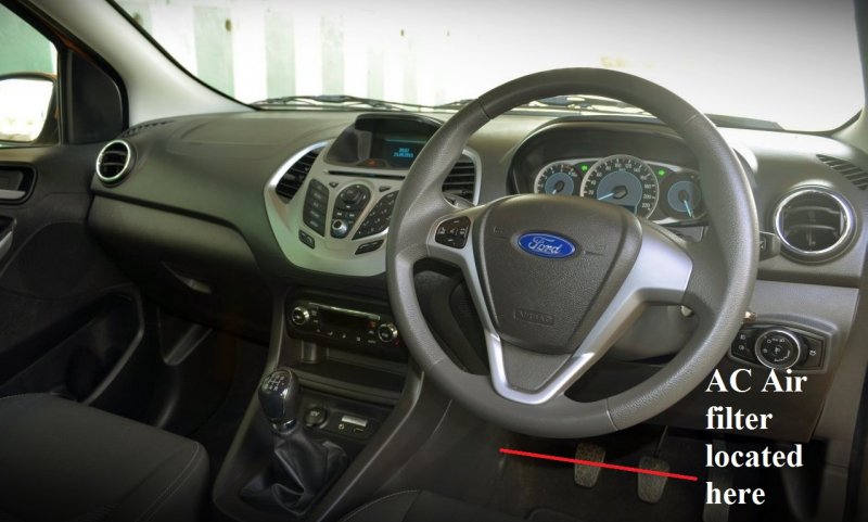

The AC filter cost is 130 rs/- only. The process is very difficult. It is located under the centre console right side and adjacent to C pedal. Ref below image.
Unscrew the bolt then bend the plastic sheet with little force and hold. Then you will find rectangular slot with cap of 4 corners screwed. Unscrew them then you can find it. This is very difficult process compared to other cars I think. Even I too helped him in that process by holding plastic sheet to tilt in a position.
