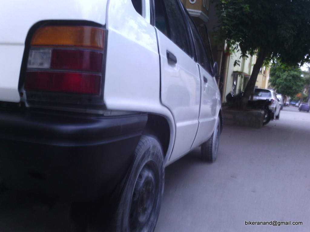

i suggest new head lamps and tail lights bumper polish they are not very costly
which paint you used ? how much paint you used and what about price of paint
did you used 2000/1000 grit sandpaper after painting or clear coat?
Thanks Raman,
as of now I do not want to spend on replacing anything that is working fine (I know new HL, Tail lamps etc make the car look better). I want to use the car for 1km before I spend 1rupee on it, literally thats how I have started to think, if not I will end up investing a lot on spares and never use the car at all.

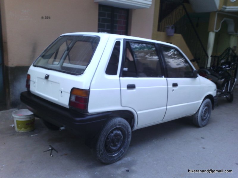

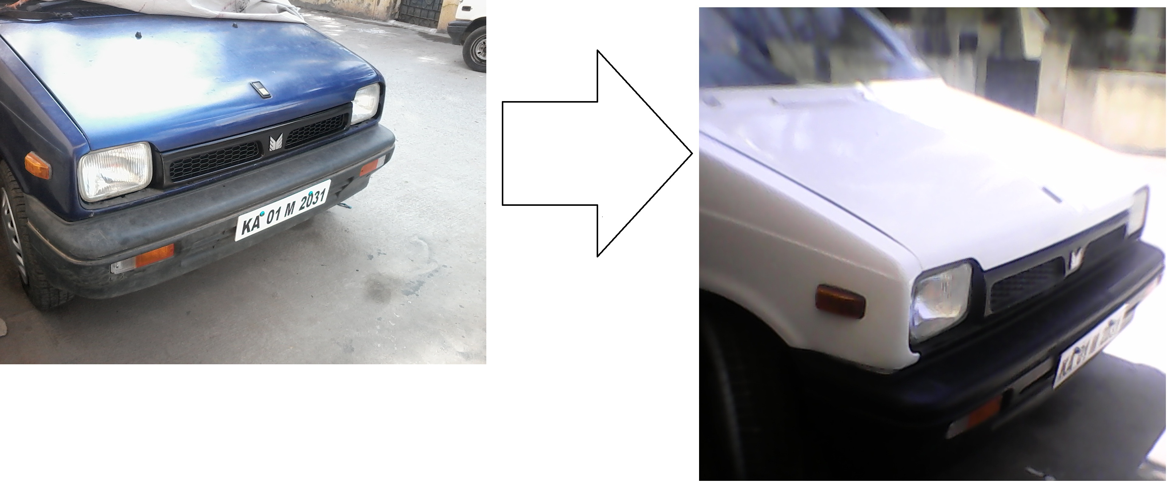

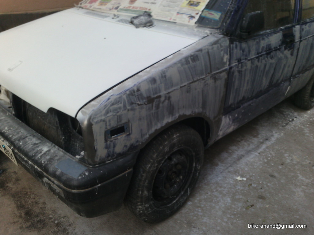

I used PU paint, ESDEE brand, pure white, non metallic solid colour and no laquer done. For final rubbing and polishing I used 1500 first and then 2000 sandpaper. I will have to respray the roof sometime later to get a better finish as at present roof is not looking good.

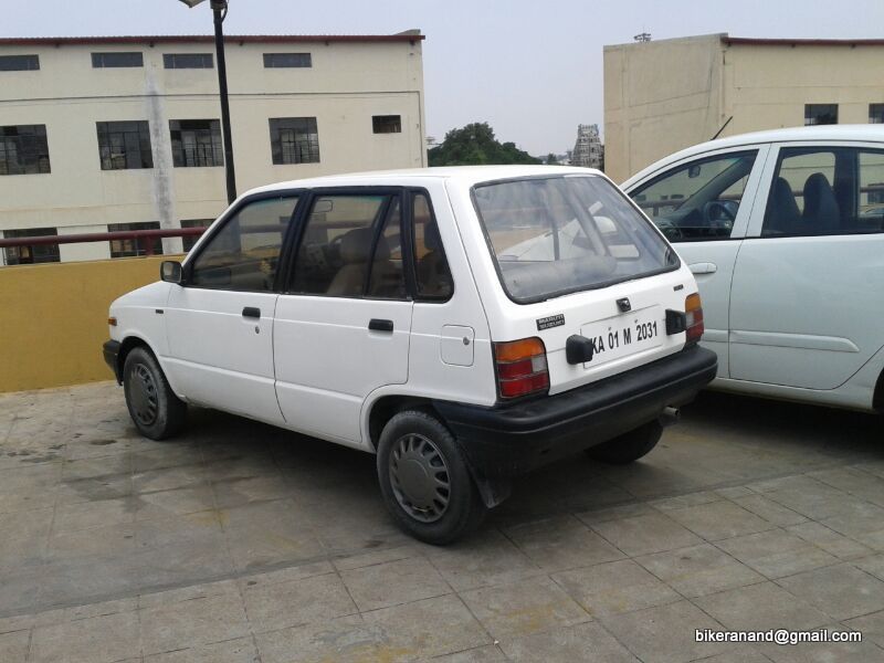

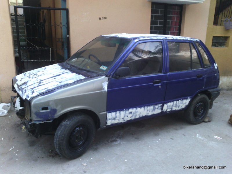

Actually, its a lot of time and effort put in, but end results are not that great, in pics car looks good, in reality it is a bit different (but anyday better than the blue colour it had
Your car is looking fresh now !!
Its time to enjoy driving it around..

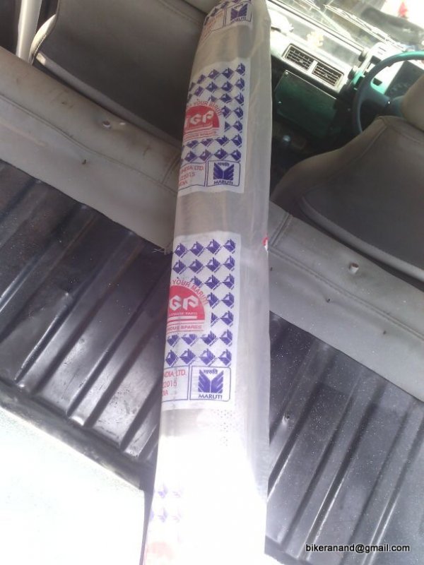

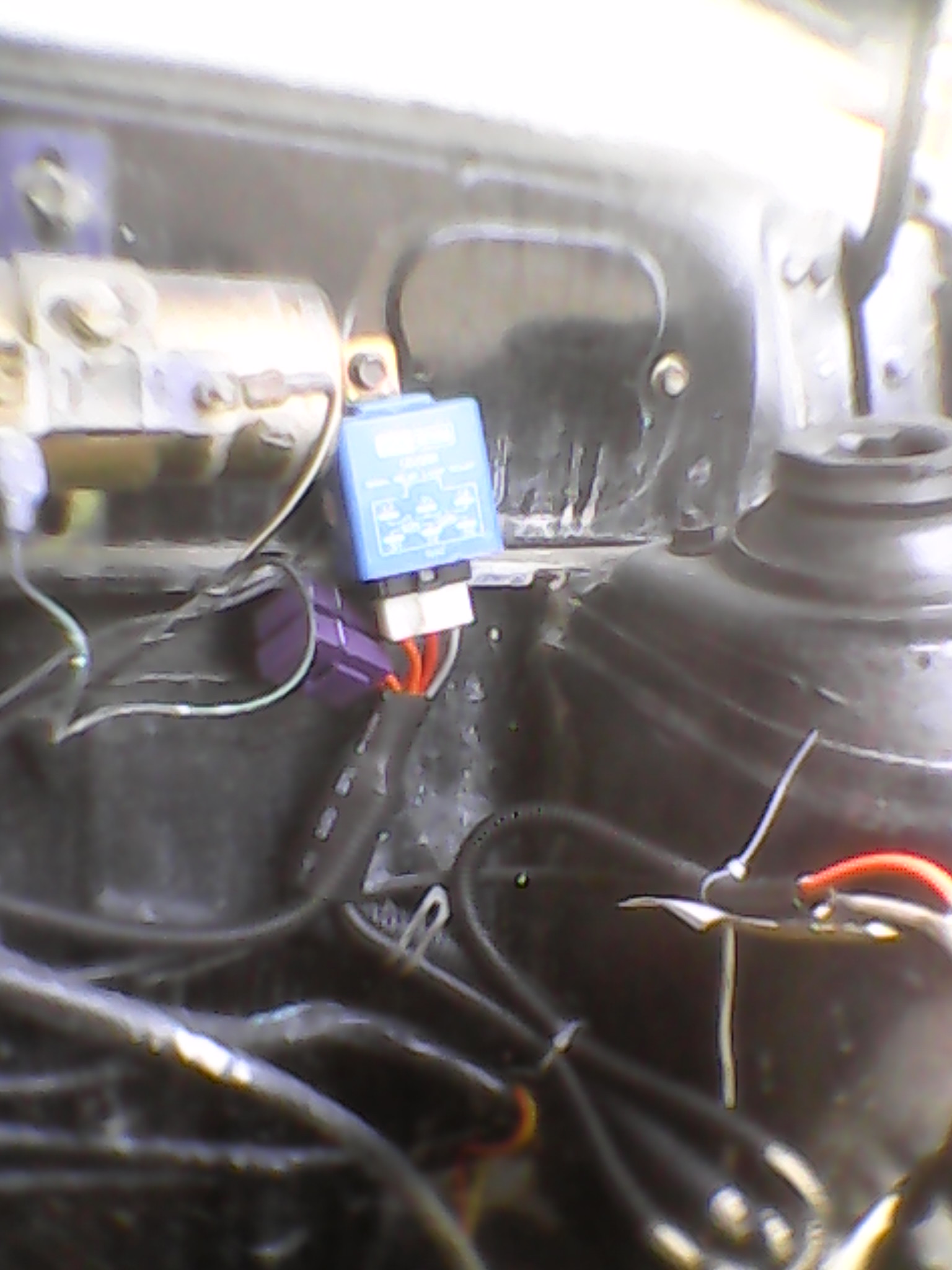

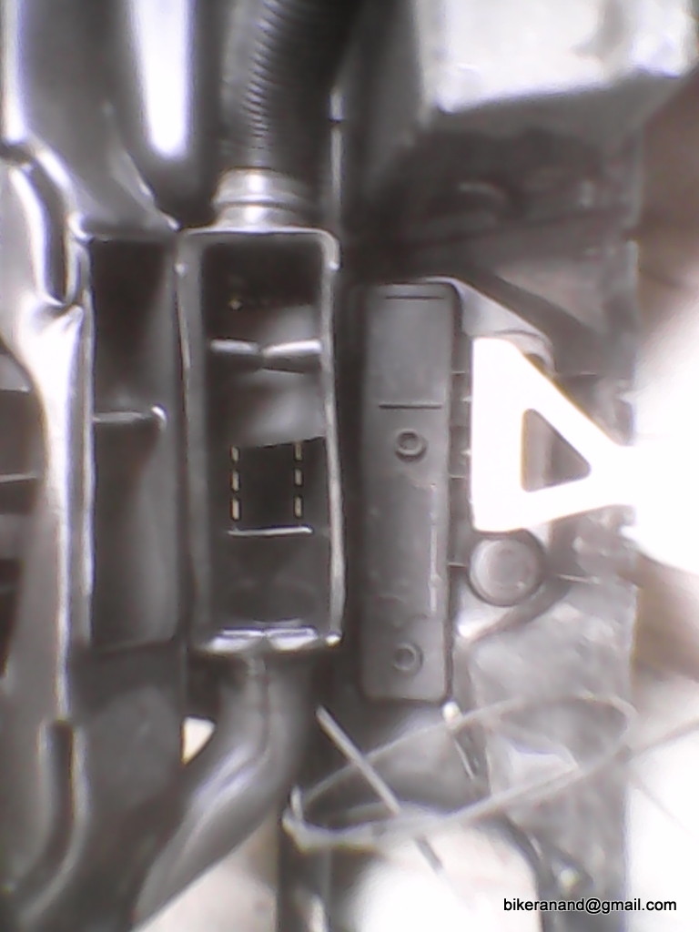

Replaced a few things, that are zero compromise areas like horn and headlight wiring kit, next in line is clutch and windshield beedings.

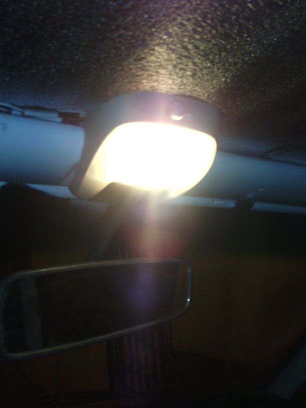

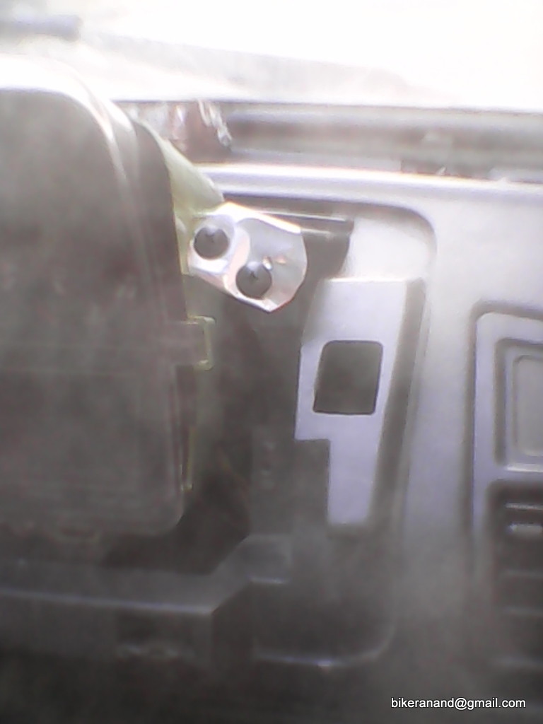

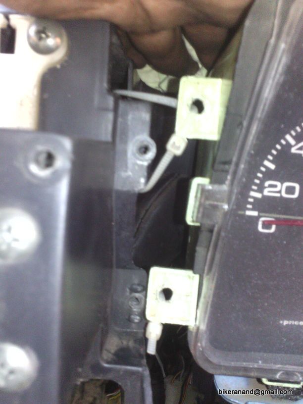

New Zen cabin lamp, instead of the stock ones

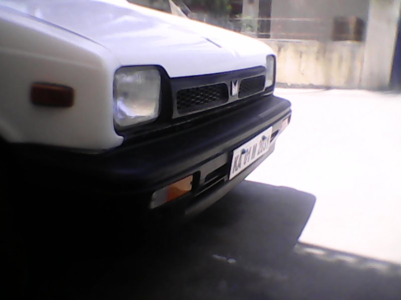

The old dual horns - Vibro mini, gave up so just bought a single disc type Roots brand 12V 3Amps horn, a simple horn with just sufficient loudness for city usage.
New Headlamp wiring kit - Minda brand comes with Relay and costs about 100 less than Bosch and does pretty much same job
Just added the 800 monogram on fenders just for a change.
Just started using the car a bit more than usual, Been to a temple - Shiva Gange about 40kms from Bangalore and back with family and well the first trip in this car, felt pretty much good with zero issues and no breakdowns anywhere.

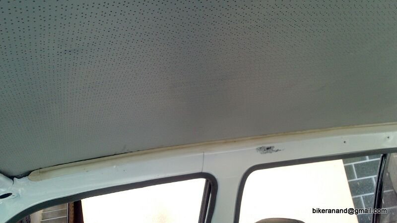

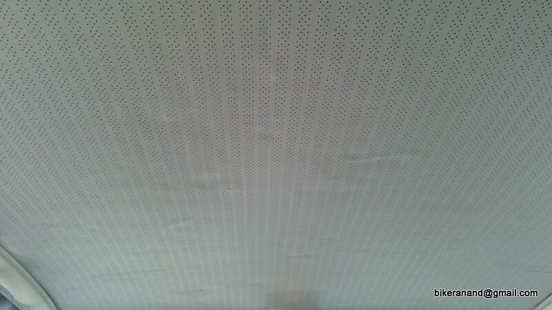

1. New roof inner lining

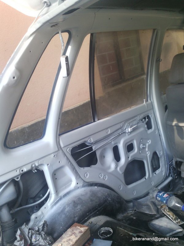

5. If you dont do pre-spray work properly, you will end up doing a lot of post-spray work
