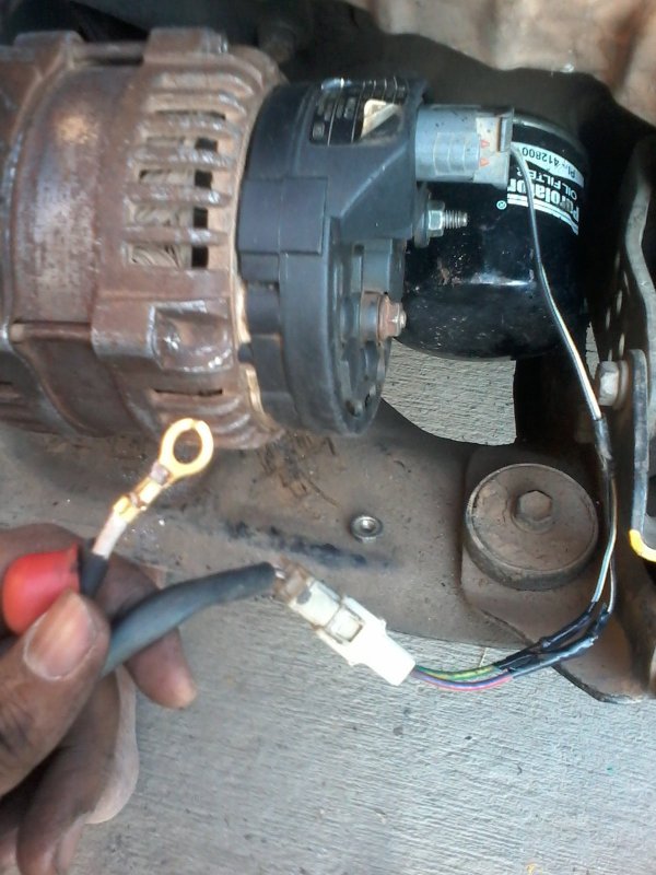

Update:

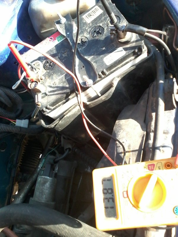

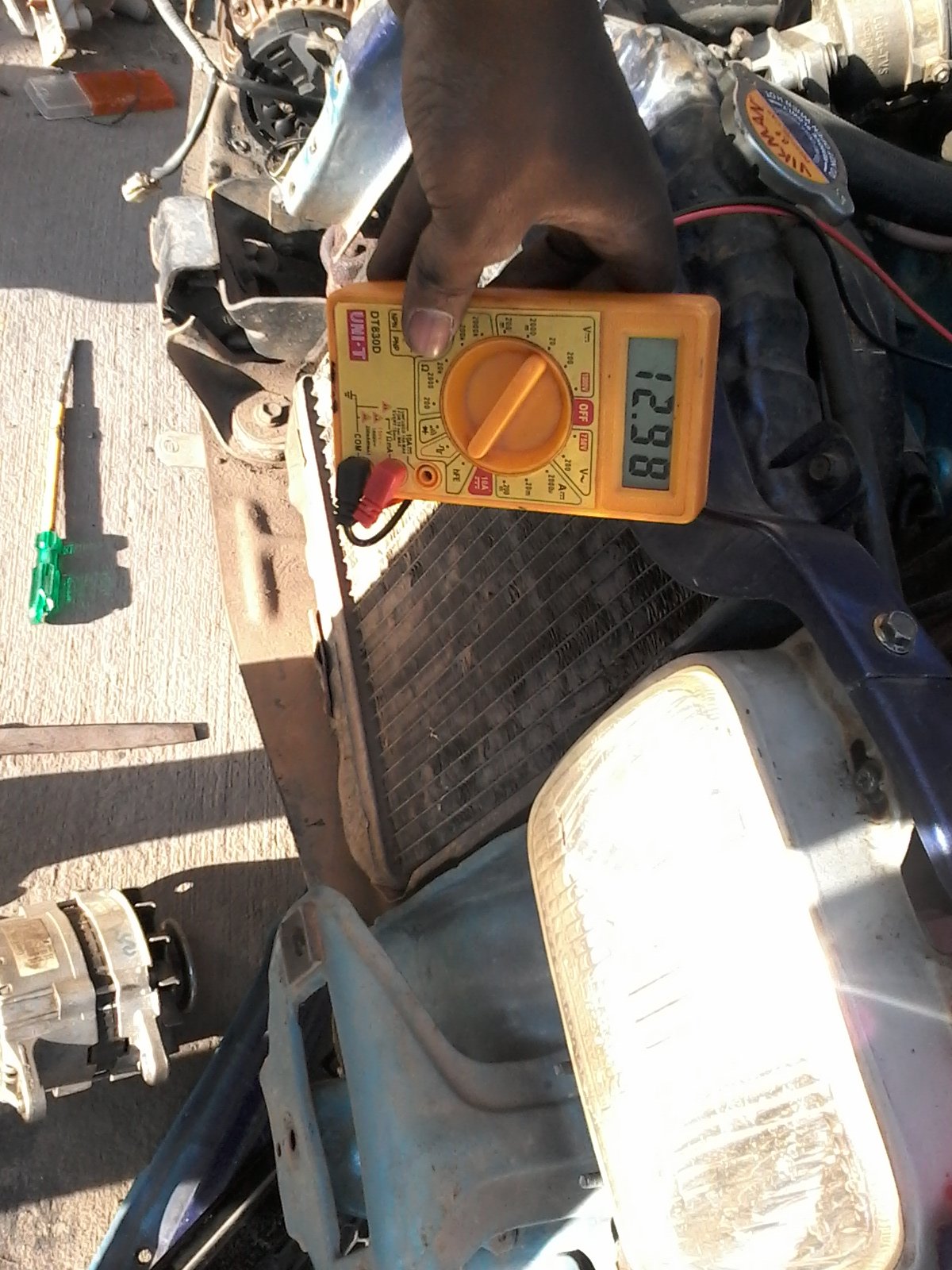

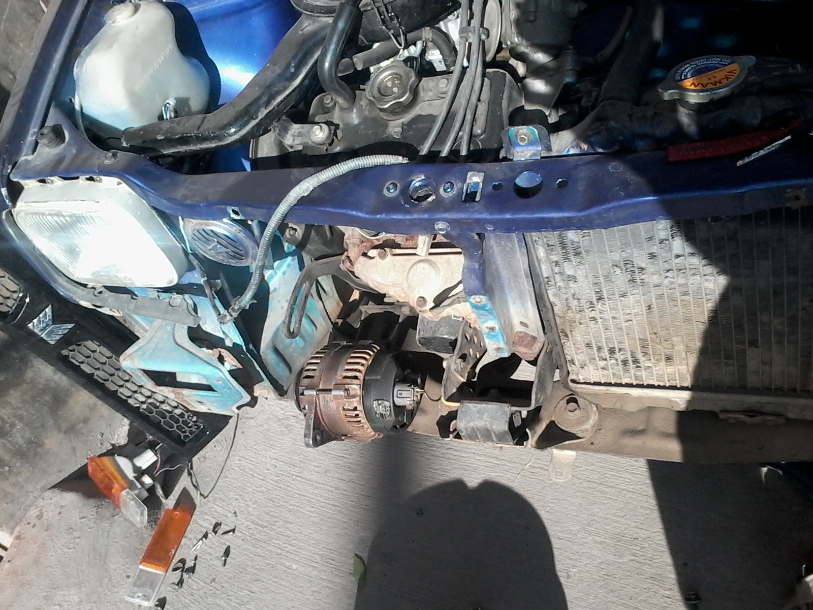

Finally the 60Amps alty is ready, with new windings, new pulley and fixed in the car :D
Brighter headlamps= yes
battery charging = yes
smoother idling = yes

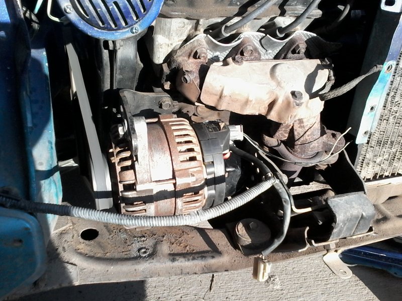

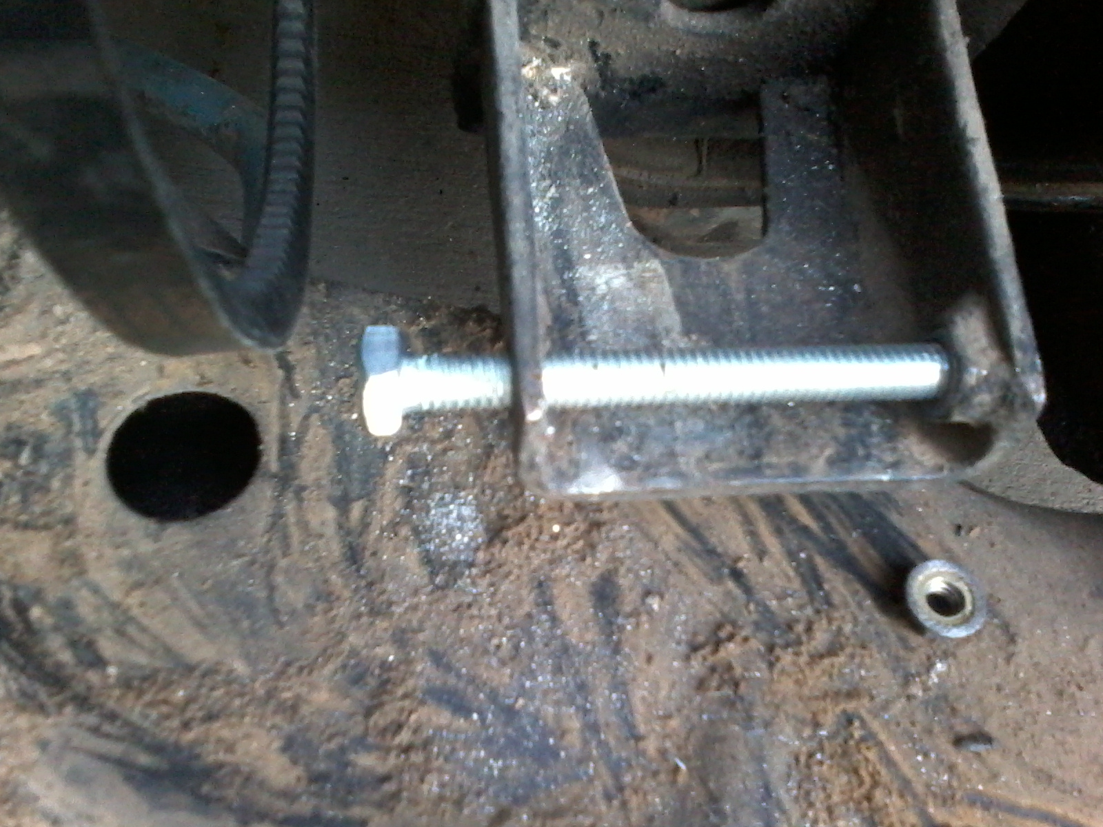

few pending works, with regards to the alty = the belt is not aligned properly due pulleys not being in straight line, so I have to cut and modify the mount to suit it, needs a bit more time. Postponed it till the current belt gives up. Few pics. Also the heavy duty wire is yet to be installed.
This gap will also increase once the alty mount is modified
New connectors as old ones got cut

Cool ! In my car I have totally grinded off the nuts on the mount. I have used a long bolt to secure the alty. Also you can bend the top mount so that the alignment is perfect.

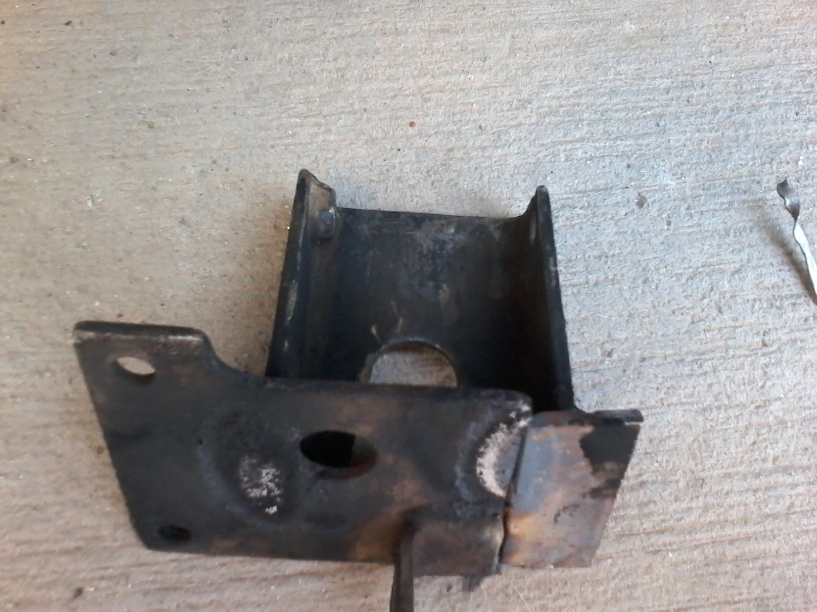

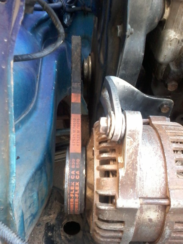

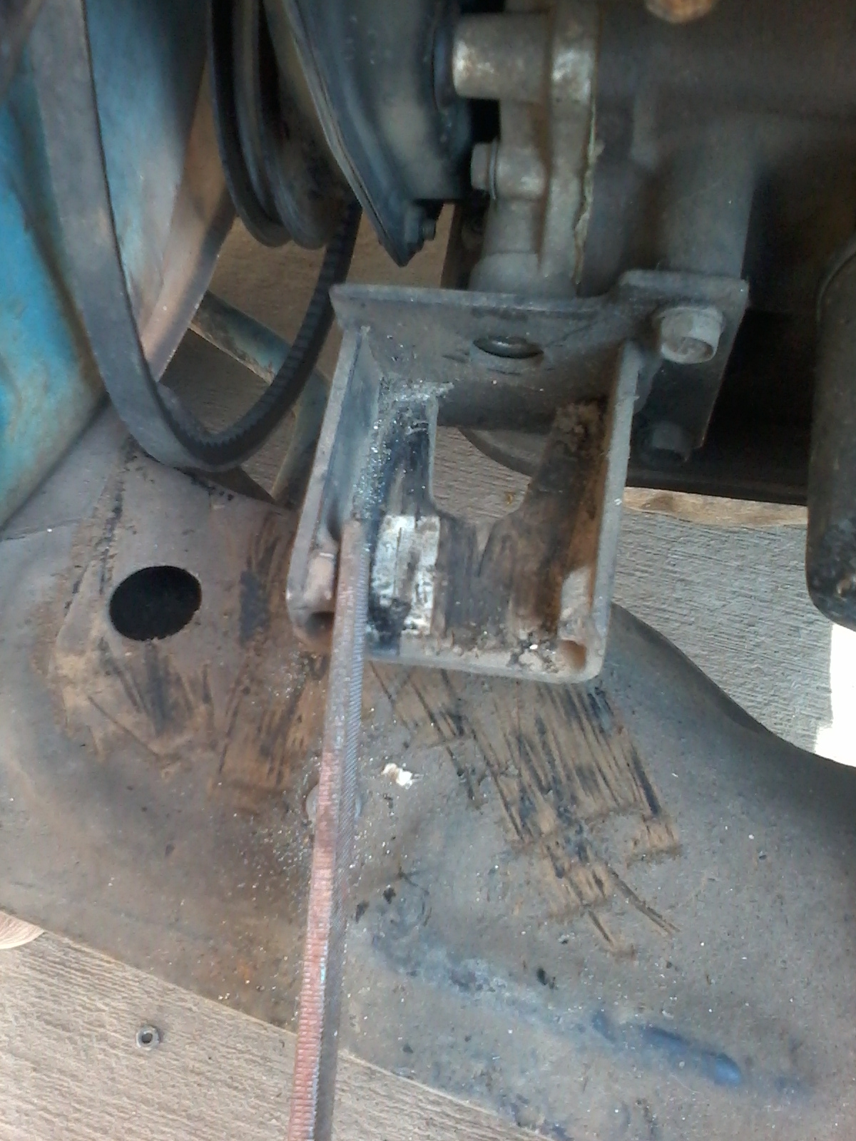

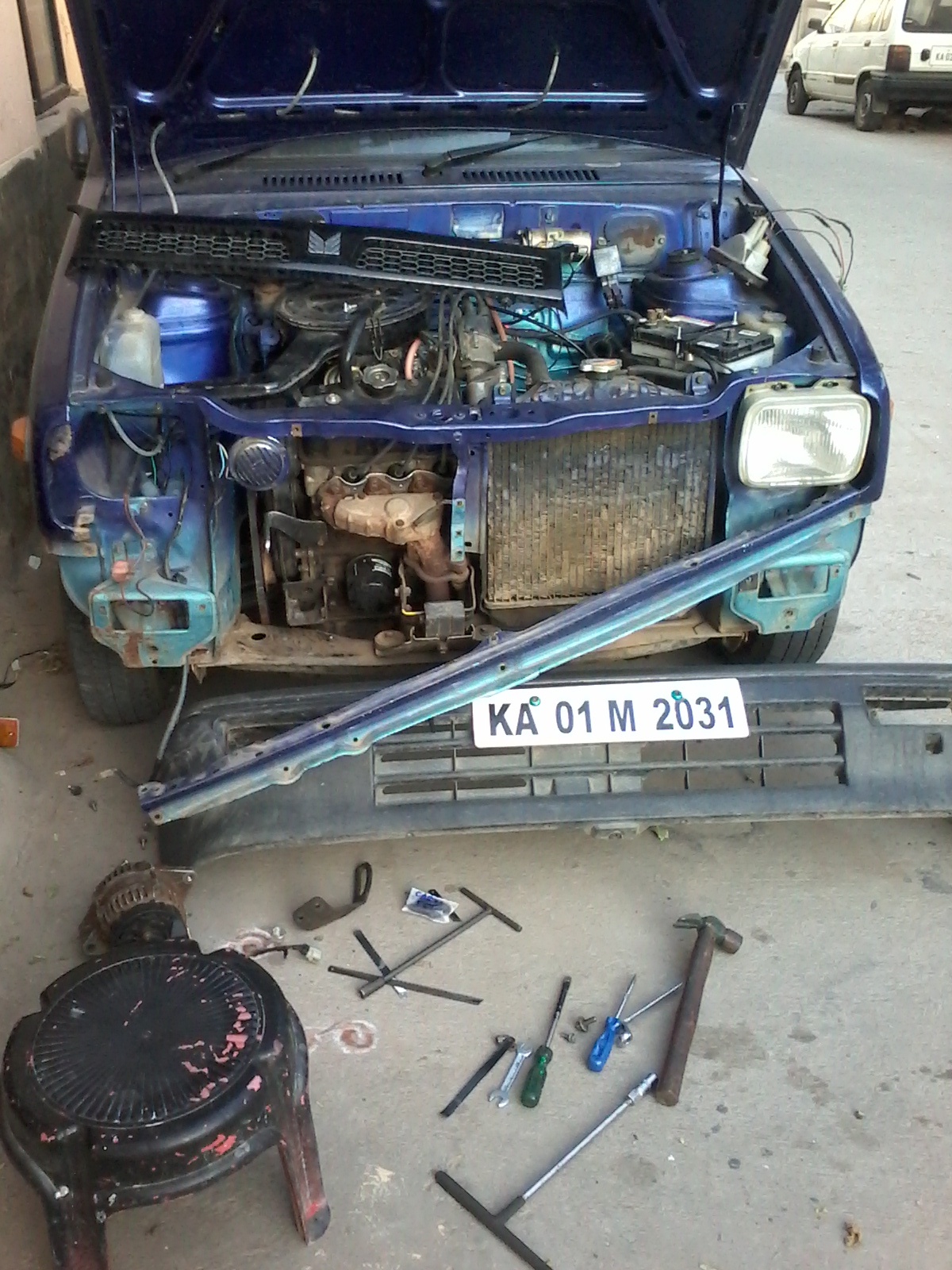

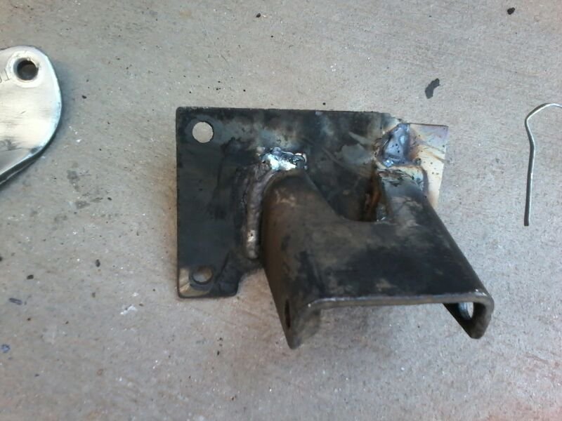

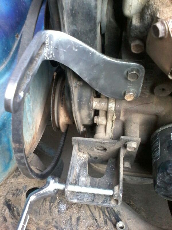

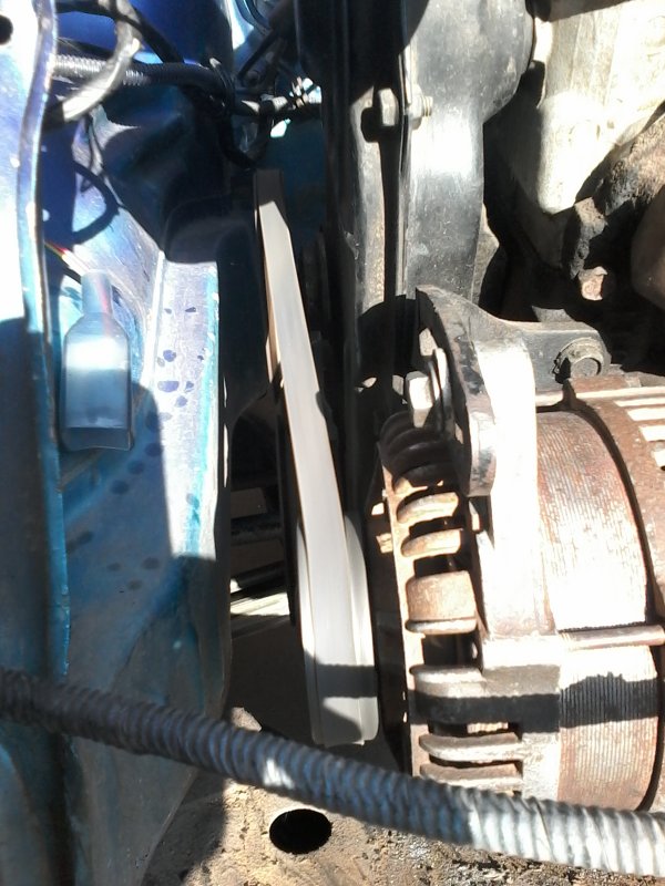

The alty belt is not aligned properly with the rest of the pulleys, hence to rectify this I did a lot of jugaad and got the top mount slightly bent, that is again faulty and hence both top and bottom mounts needs to be cut and rewelded so that the dynamo sits about 1/2 inch towards the Right side headlamp. Welding shops near by home are reluctant to do any such mods, as they are too lazy. Have dismantled everything and tomorrow morning I will have to try with a different welder.
Thread Starter #233
Dec 13, 2011
1,714
1,083
Re: Restoration of Maruti 800 1991 (Tonnes of Pics Uploaded)

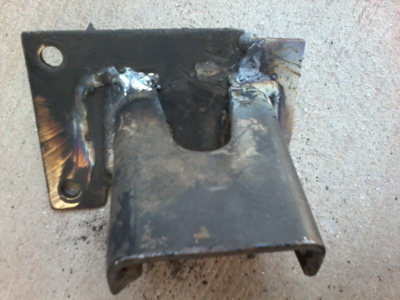

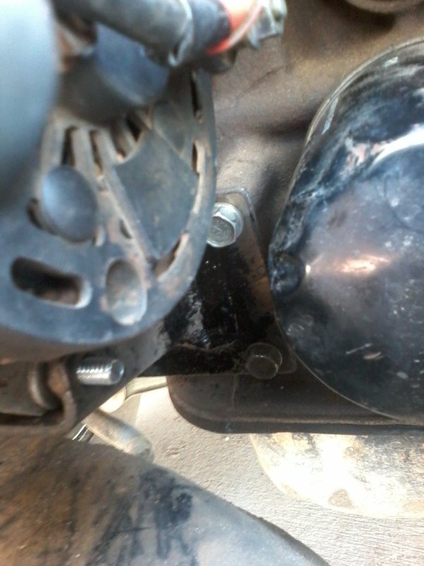

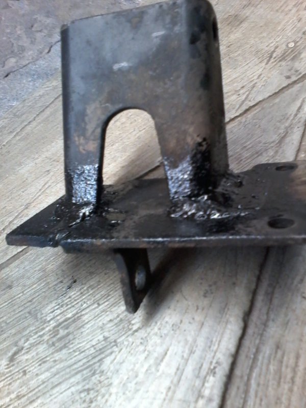

Finally the mount cut and welded pushing the alty towards the RH headlight. Success [thumbsup].
Painted the welded area with cotton waste and some old black paint, just to avoid rusting etc
Also the gap between oil filter and alty is now better,

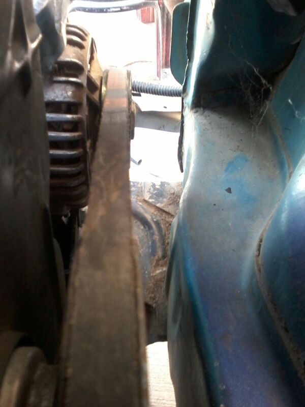

alignment of belt is 95% (slight variation still left. Will deal with it in the future. Belt needs to be a bit shorter one now[frustration] sa tension is less as the alty sits closer to pulleys.

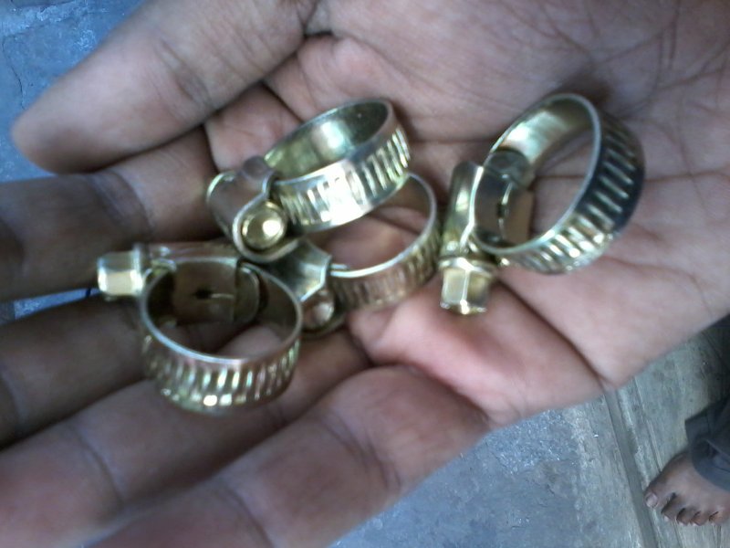

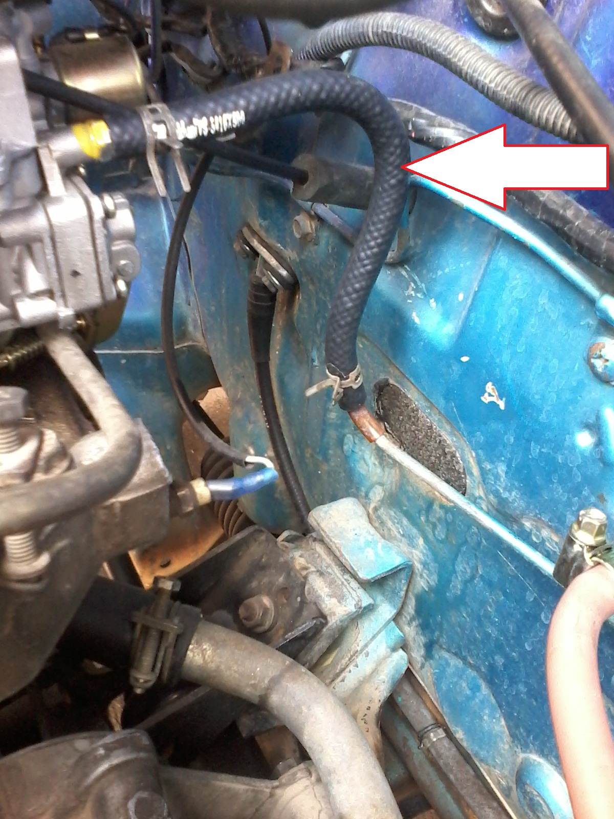

Final thing left is to fix a fuel leak from return hose of carb, tried different size pipes, clamps all of no use.
Will do something about it tomorrow.
Thread Starter #235
Dec 13, 2011
1,714
1,083
After wasting about 200 rupees finally a shop keeper helped me out by giving the right pipe (MPFI fuel pipe) and fel leak is solved.

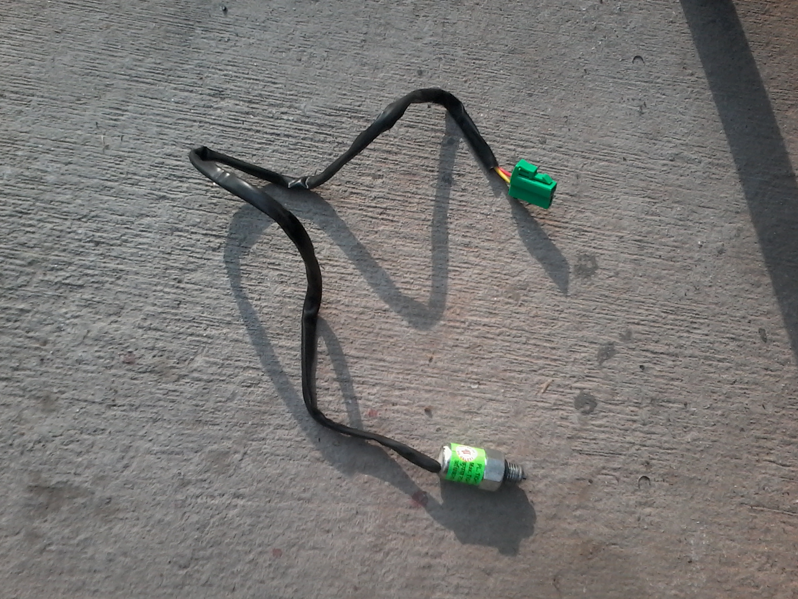

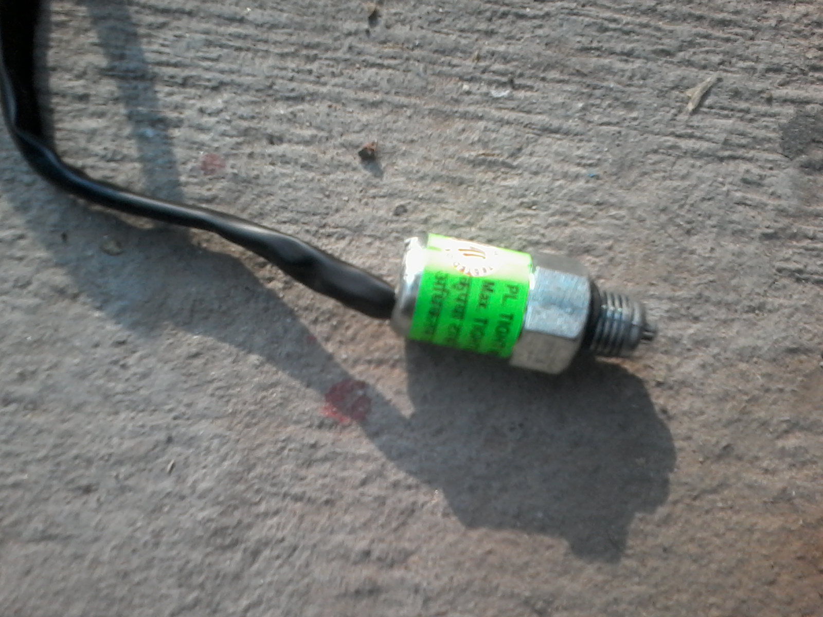

Reverse gear switch wires have come out of the switch, no point in repairing these, so just bought a replacement one, yet to fix it.

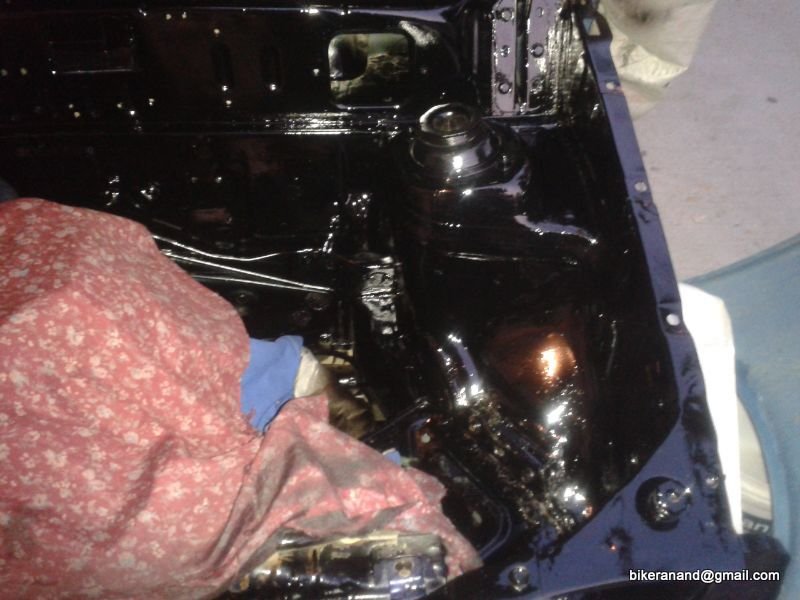

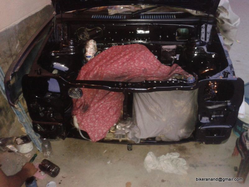

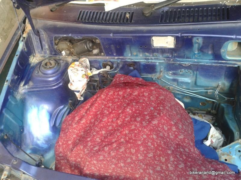

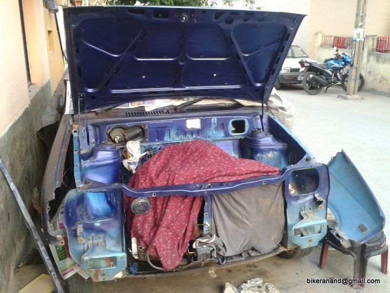

Repainting begins :D

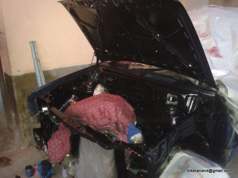

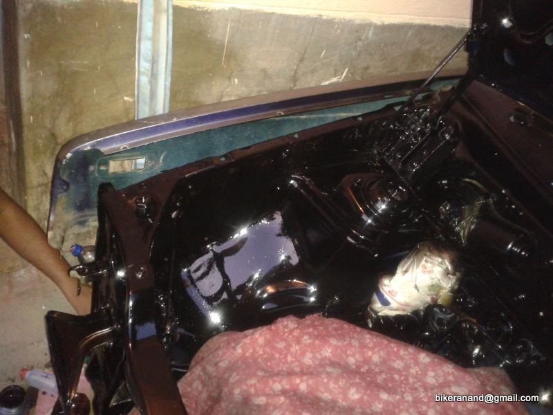

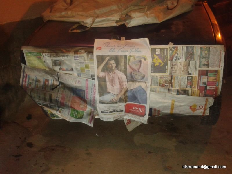

After a lot of thinking, finally I have decided to change the colour of the car, I painted one fender in Orange and one fender in Metallic Grey, both seemed to be too extreme. Finally the colour is BLACK!
So started off today ripping entire engine bay and bundling wires and covering them up in cloth. Took special care for the new carb though. Used body filler in places to cover the old LPG kit holes etc and also near the rusted battery tray,I used a PU paint with a bit more hardener and here is the result.
The front area covered with newspaper just to avoid dust on the wet surface, as I have done the painting outside my house.

Nice work SS80 !! Where are the cables, wires etc. Engine bay looks empty.
Make sure you paint the battery tray it gets rusted soon.
Do we need to apply clear coat on the inner surface too ? Whats the reaction of your neighbors ?
Waiting for the end product !! A shiny blacky 800..
