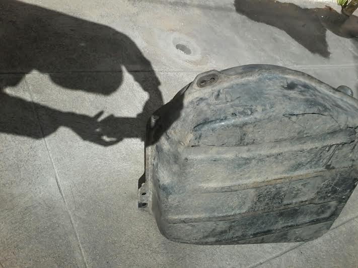

It is not a hole/small crack, it is more like a weakened spot on the surface of the tank. So when I wipe the leaking petrol, no big drops are formed, but within seconds the area gets wet with petrol again.
Satish:
The car is 21yrs old and I dont think its worth repairing such an old petrol tank, repair will cost about 200rupees atleast, used tank is about 500 - 700 max, so I opted for the latter.

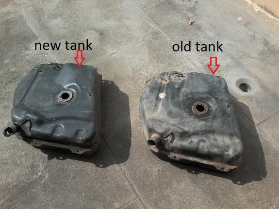

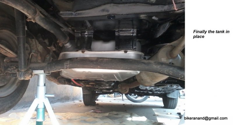

I guess the type 2 tank looks different due to suspension setup.
You could paint the tank.

Tank painted and fixed back
Update:

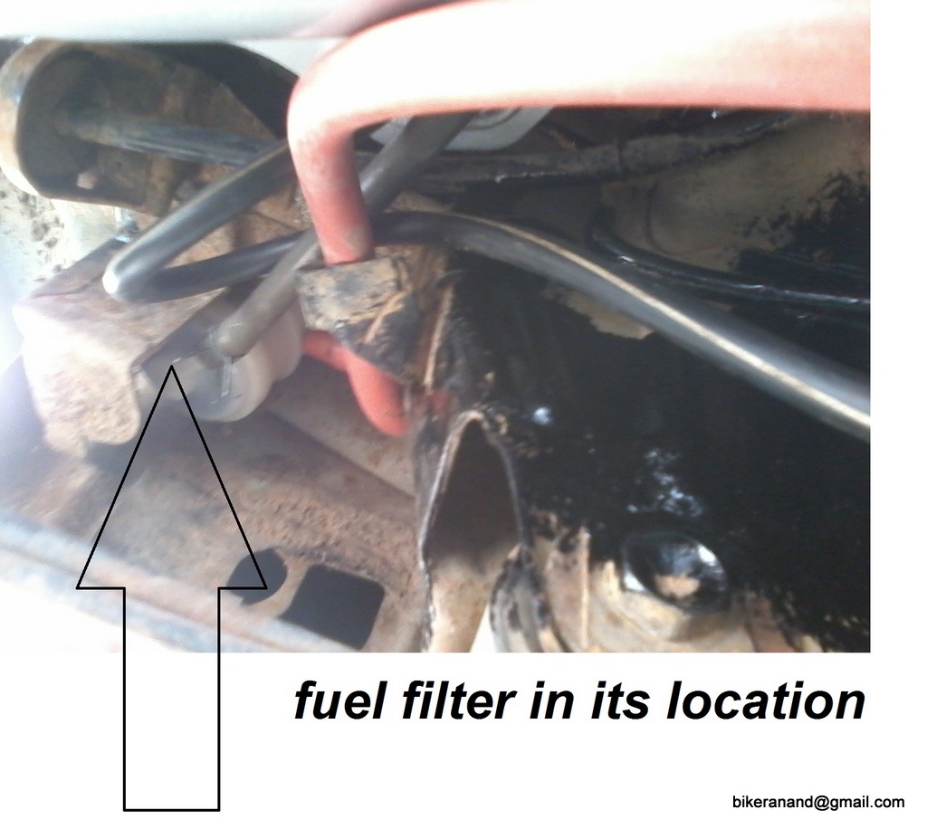

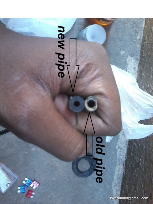

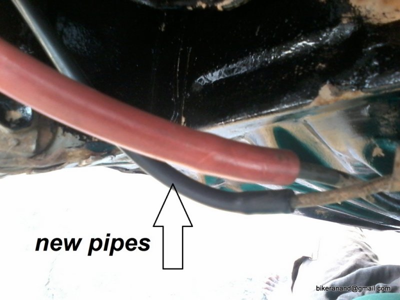

Fixed the tank back, installed new rubber hoses and carb removed to be repaired.

Make sure you use any insulation material (like those found on the electrical wires) to protect these flexible pipes from rats.

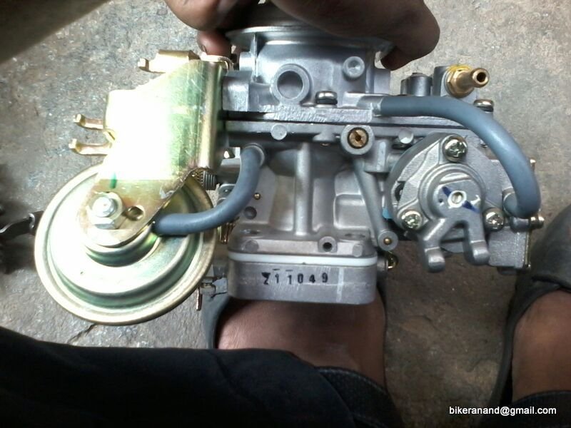

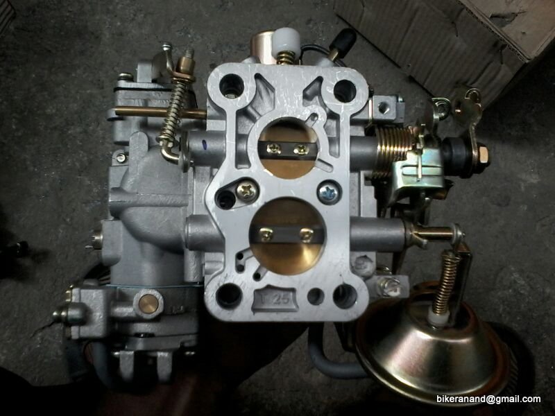

I guess the part shown in the pic (carb) is available at MGP or try at Manu at JC road.
BTW why does the carb has 2 butterfly valves, in my 800 there is a single one.

Varun:

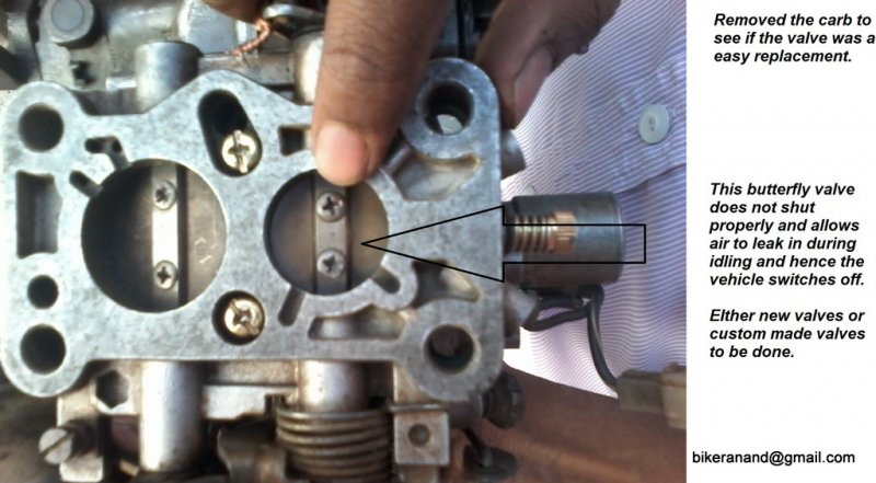

I got to know from Wikipedia and Jarpickle that M800 Carburator is a double barrel Carb. So there would be two butterflies. The first butterfly (small one) works whenever you use the throttle pedal, the secondary butterfly opens only when engine is in high RPM for quite sometime. A clever piece of engineering indeed. The secondary butterfly is vaccuum actuated and the bell shaped thing in the carb is the one which opens the secondary butterfly. The mechanical connections are such that the secondary one will not open unless the primary is atleast 80% (min) open.
I had painted the tank and forgot to upload the pics.

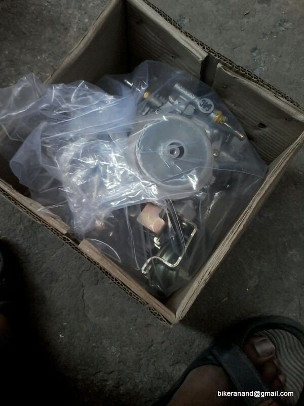

Today after thinking a lot and having a few discussions with friends and my trusted Auto Parts shop, I skipped the idea of buying a throttle body for the existing carb and instead bought a brand new UCAL Carburator (non AC) from J.K.Automobiles. Brought it back home and fixed it to the inlet manifold and poured about half a tumbler of Petrol in the smaller barrel and cranked a few times, hurray perfect idling, took it for a test drive and topped up the tank with 500rupees petrol.
It was a tough decision to take as month end is approaching and I am already cash strapped, but then I am addicted to spares, bills, car, thinner and credit card [frustration]
The minute I saw the new carb, I was drooling looking at the super clean aluminium alloy colour :stupid:
Cost of Carburator: 4.2K
I was fed up of answering everyone that the car has a new heart but wont run, finally I am at peace :D

The new carb looks cool. Why not change the fuel line pipe too I can see it has some small cracks.
How was the test drive.
Thread Starter #206
Dec 13, 2011
1,714
1,083
Re: Restoration of Maruti 800 1991 (Tonnes of Pics Uploaded)
Crack? Where did you see it? please let me know ASAP because I don't want to lose another 5+litres petrol leaking here and there.
The carb is good, idling was a bit less so increased it for time being, accelerates well till 60, after that car is slower than before, may be A/F ratio needs to be adjusted for better pick up.
