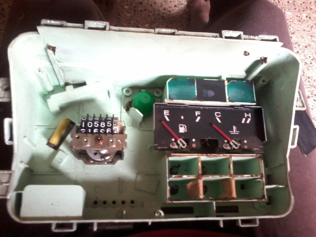

Gear issue fixed, wheel cap painted, speedo repair in progress
Tried adding a SMD light buld to the meter board and cut the top portion for better illumination

I dint get what you are doing with the speedo console [confused]. Also the placement of the tripod stands should be towards the wheel arches (behind the wheels) as the main chassis is supported and doesn't slip.

I just cleaned the speedo and tried to get better lighting. the chassy is not that good in shape to hold the car at the running board end/joint place.... I am 100% sre when ever I add booster the wheel alignment will go for a toss as well.

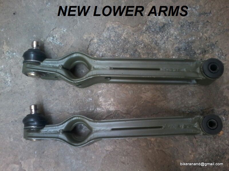

New lower arms + bushes + coolant installed
Yet another weekly off and here I am with another major shopping for essential parts and a good 5hours under the sun diong this DIY. I had this indicator issue on one side so checked everything, so replaced the Stalk/combi-switch...Severe play in front wheel while braking and also horizontal movements during start offs....so changed a few suspension parts...the pics will explain the rest..... [sleep]
New probs discovered.

great work sir.i think u must replace all the rubber parts of the suspension in one go.its better then doing things one by one.and is your axle fine??And one more thing jst soak all the rubber parts in brake oil before putting them in.it makes them little soft and prevent them from cracking.
