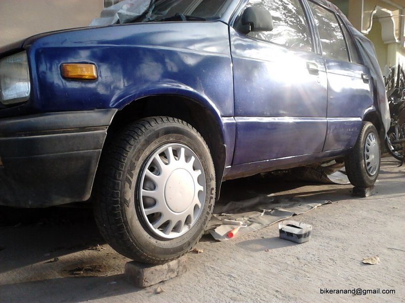

A very Happy New year and congratulations on the purchase of the tools. Please share the cost of the jack.
Thanks a lot and wish you the same Shantanu Bhai!
Jack cost is 1450/- [bottle jack is superb and starts from Rs.500/- (for M800) and Rs.1050 for Ikon kind of cars, but the only issue is in case of puncture, GC is too low for the bottle jack to go underneath at the right place.
Axle stands (planning to buy next month - a pair)
- Imported ones with easy height adjuster is 750/- each
- Local ones with manually inserting key/pin to lock the height is 400/- each

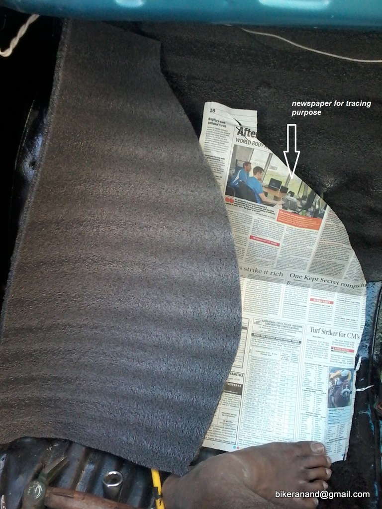

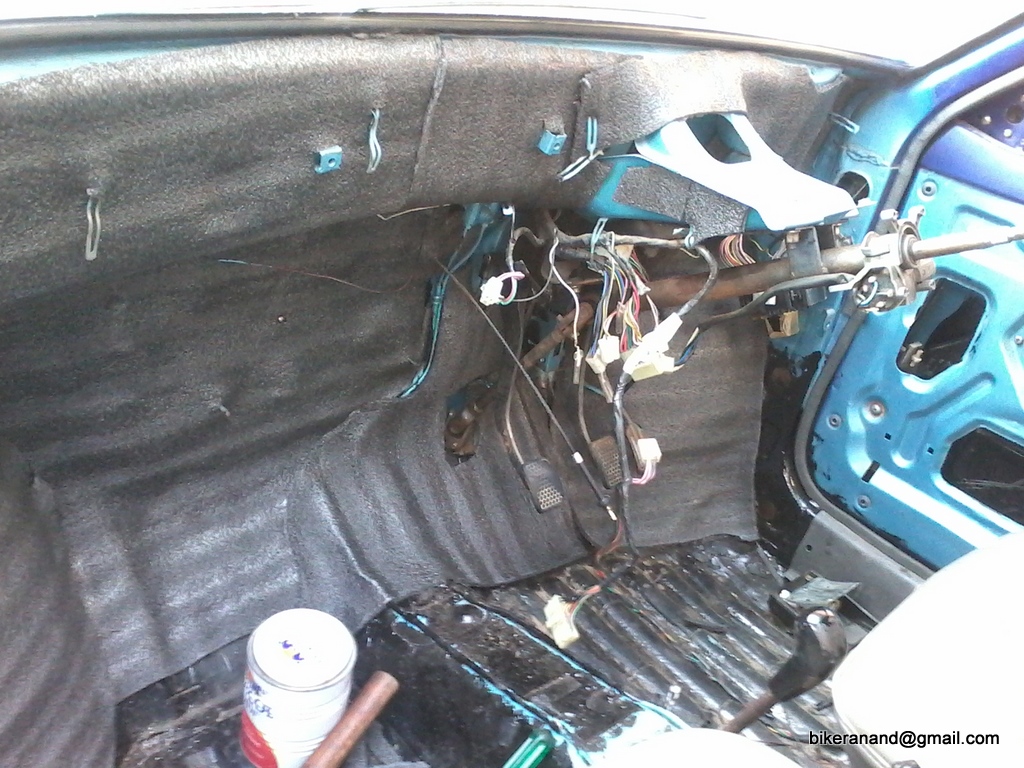

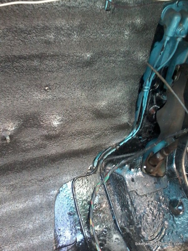

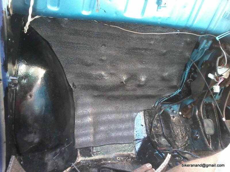

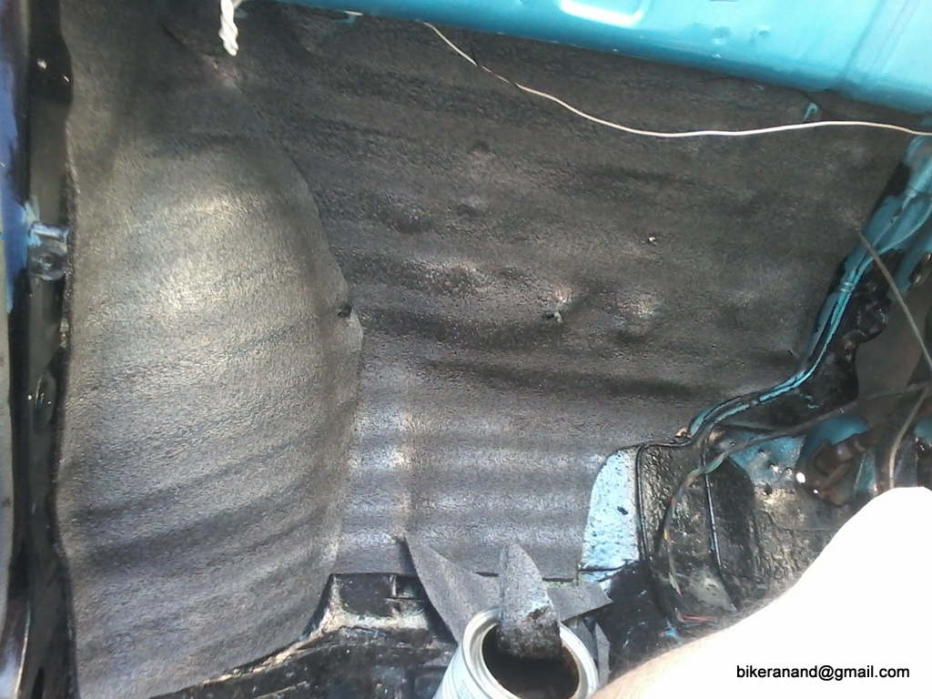

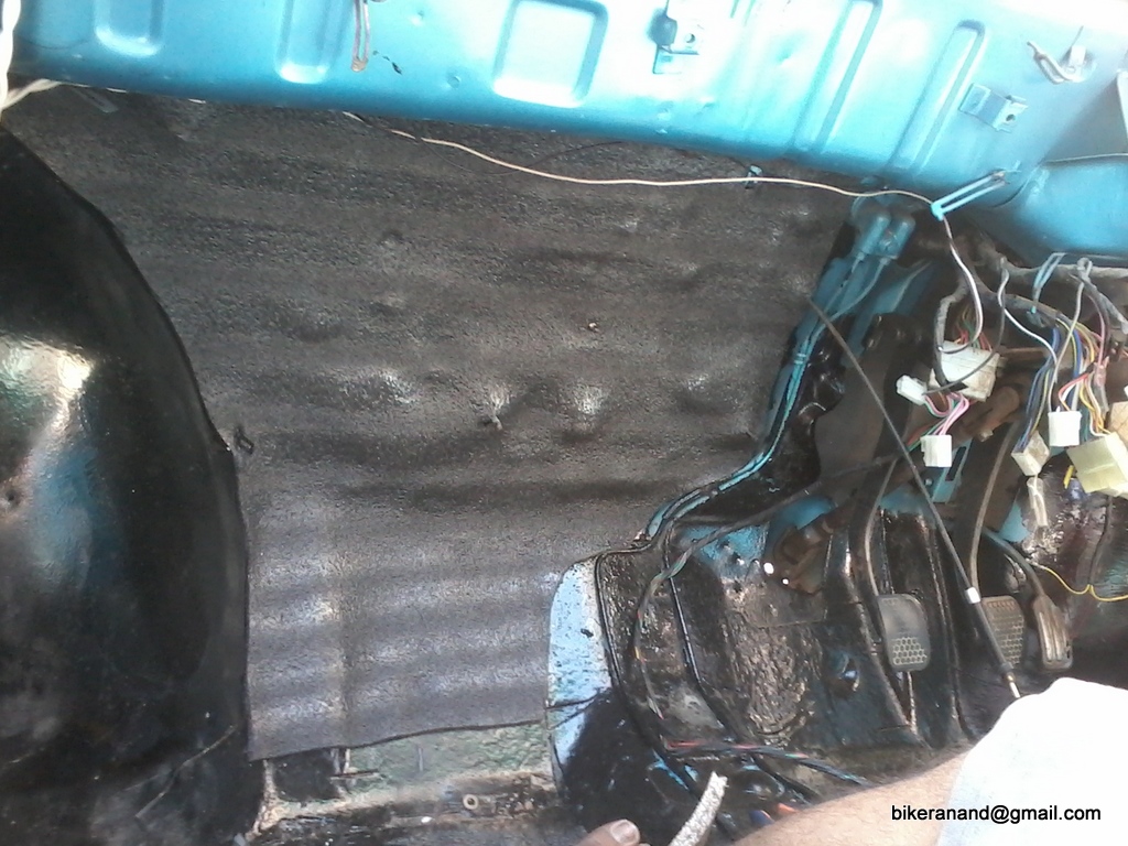

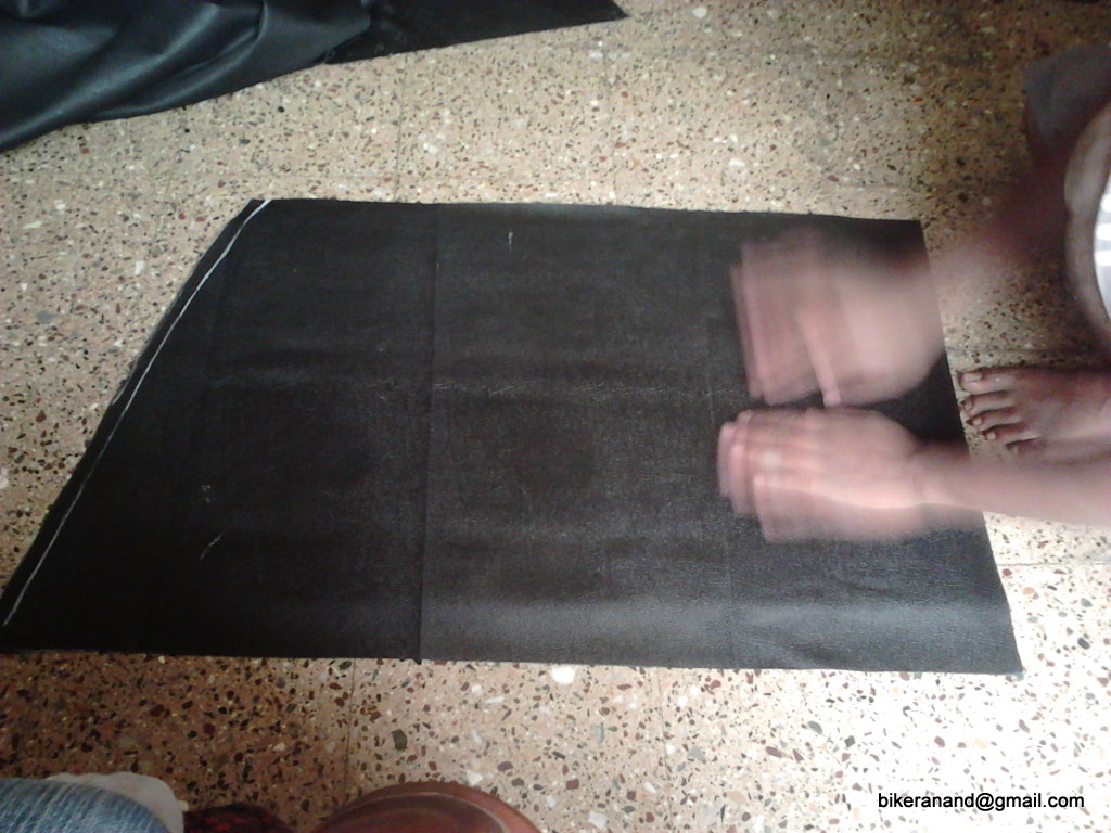

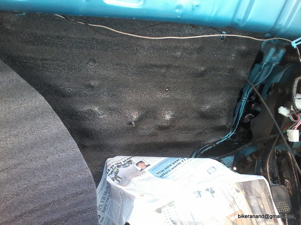

Update - Car damping complete
Today's hot afternoon was dedicated in removing the dashboard and fixing the foam sheet. Used newspaper to trace the exact shapes and cut the foam accordingly. Much cheaper and better finish than yoga mats. It is a 8mm foam sheet cot = 70/- per meter.
210/- for 1 litre of fevicol adhesive (used for footwear products), cheaper than SR glue and seems to be good. For firewall we need approx 1 meter of this foam sheet.

I am not sure if that sheet can withstand the heat from the engine bay. For the rust you could have at least used body filler.
Any way good progress hope to see it on roads soon.

Its a nice attempt to reduce noise and heat inside the cabin but I too doubt that it will withstand the heat. I hope, you'll use the original firewall insulation too. BTW, if you visit the local scrap yard you can buy 2-3 maruti 800 insulation sheets and use the insulation material to make one sheet.

The foam sheet is mainly to reduce the noise, not sure if it can make a difference to heat from engine bay.
This foam is known as Heatlon. So I guess it prevents heat coming in. I have put the same below the carpet in my Uno. I have even applied it on the firewall inside the engine bay and then covered it with a foil sheet. Same thing will be done for the bonnet.

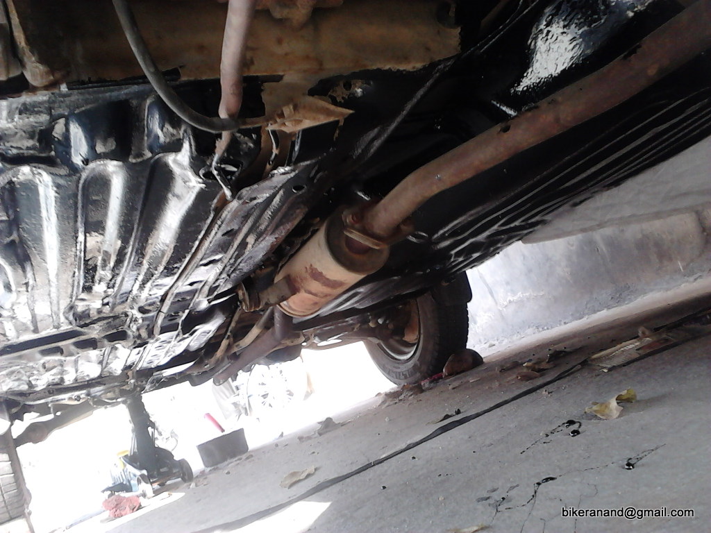

OK, I dint know that this is only for heat, thanks for sharing the right info, because the guy at the shop mentioned that its for sound absorption etc. Can this also be pasted to the floor on the underside to avoid the heat from the exhaust pipe?

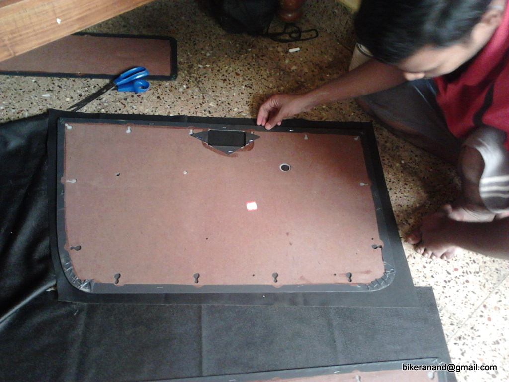

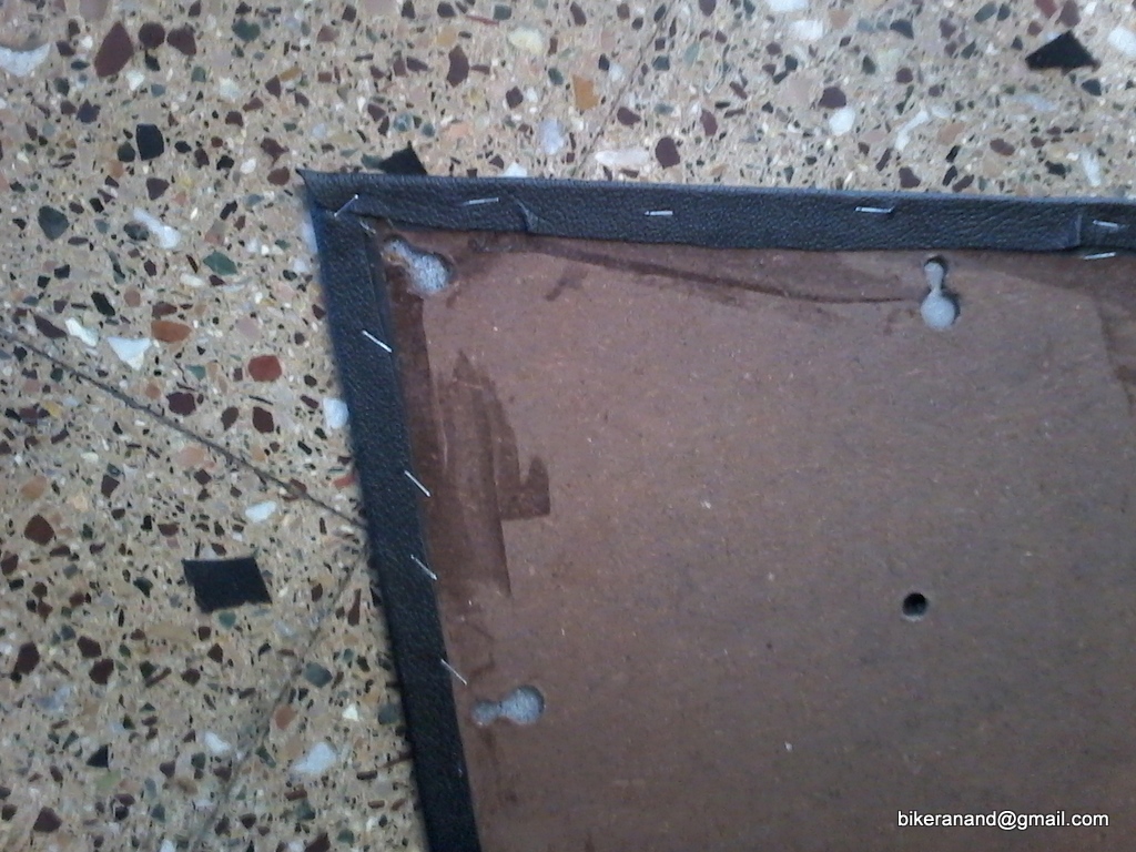

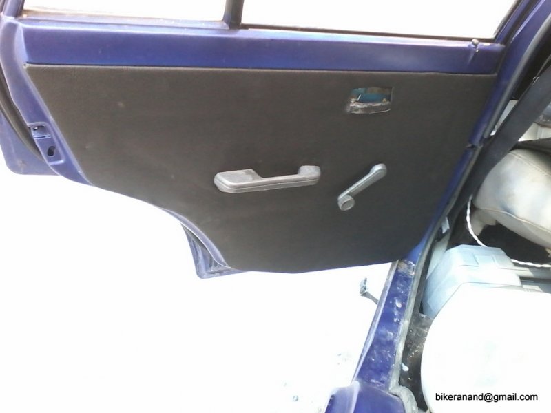

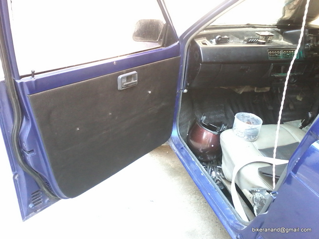

Update:
Completed work on all door pads and now I am searching for the handles and screws, not sure where I have left them. The finishing is not great/ close to pro kind. But it looks a bit different from the usual polythene the OEM stuff comes with.

Pics of door pads
Gstar:
Please check the rubber pipes that connect the carb to the fuel lines and also check if there is any fuel leak anywhere in the car (near fuel filter). If issue still persists then I suggest you open a new thread, upload clear pics of engine bay and underbody. May be we can get some solution based on pics. All the best. [drive]
Pics of DIY Door pads

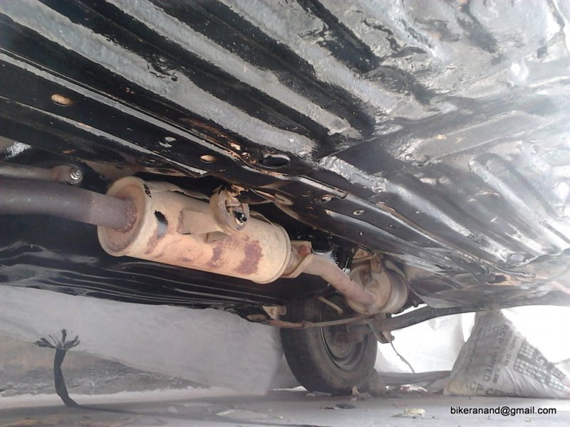

Fuel tank leak -
Jarpickle: After our chat, I began to worry if the tank in my car would have some issue? and it turns out to be true. [frustration]
Latest issue: Fuel tank leak.
Aug 30, 2013
45
29
Re: Restoration of Maruti 800 1991 (Tonnes of Pics Uploaded)
Can it be welded or would you have to change the entire tank?
Its a pain to discover one problem after the other. I can relate to this. Had the same kind of problems with my 800
