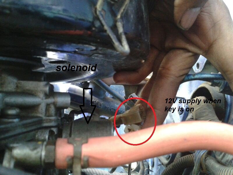

As some one to key on and observe if you hear a click sound from the carburetor. There is a small solenoid (Anti-dieseling solenoid) to allow fuel while idling, but not any if engine is turned off. If you don't hear any sound, you have identified the cause. Check the wire / connector and see if it receives power. IF this part is okay, doubt the solenoid. Simply replacing it would solved the problem. But these solenoids are bullet proof, still check and share your findings.
A friend has the same problem in his 118NE which has the same carburetor. The connector to this solenoid had come part. He crimped it properly and the problem went off.
All the best.

It would be really helpful if you could post a picture of the solenoid or mark where its located on a picture.

Ilangop & Jarpickle:
Thanks a lot for the information. I did check the connector to the solenoid, it has 12.58V when key is in ignition slot and there is a mild click sound when key is put to the ignition slot. Here is a pic of the same. The click sound is loud when I gave the solenoid a direct 12V connection from the battery, however still the car does not idle.
