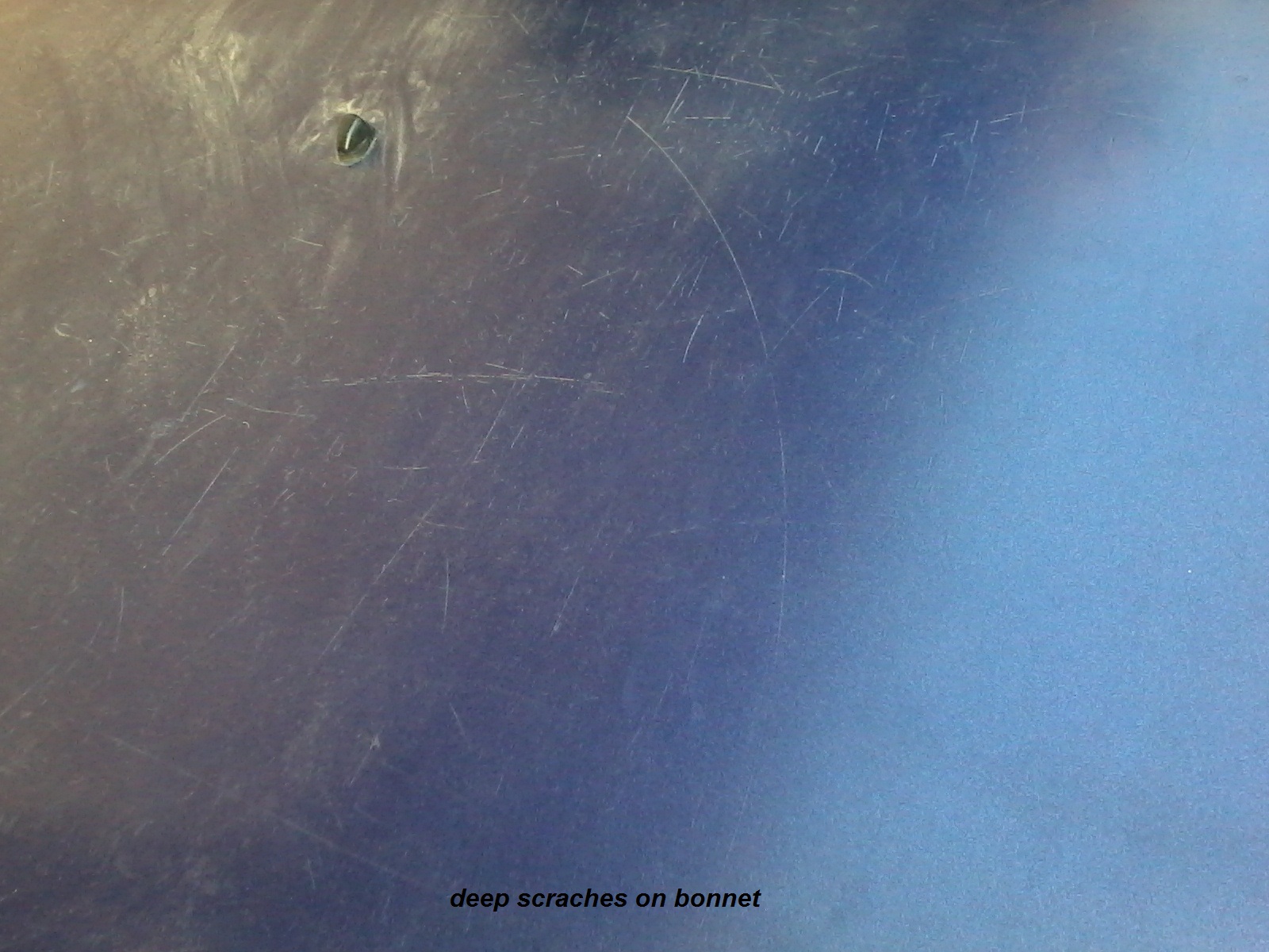

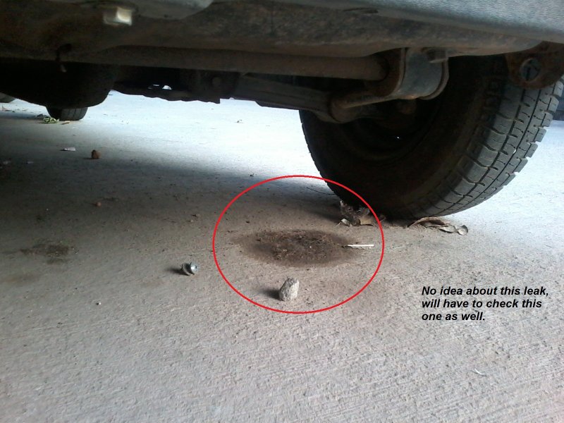

Today just started the car and was shocked to see the no:of scratches in the car by the street dogs, also a new oil leak.

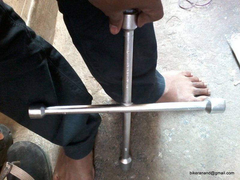

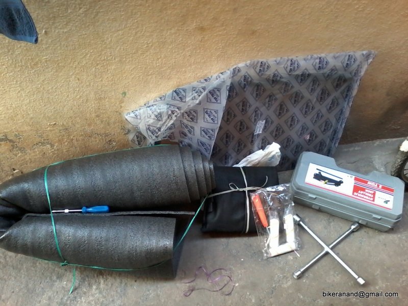

Started off my new year with half a day of J.C.Road shopping for my car and tools. I wanted to buy the bottle jack, but I doubt if that it would be too big to get below the car in case of a puncture, also I am planning buy a few axle stands next month.
Since I do a few wheel rim and wheel cap paintings in the weekends sometimes, so I prefer a bigger jack easy to use and also to suit different cars (sedans and hatches). Also bought a Taparia wheel spanner (plus type) this should be enough to unbolt atleast a dozen different car wheels.
Foam sheet - 8mm for firewall insulation
Fuel filter - to be relocated to the engine bay
grommet/ rubber covers for holes in floor etc
New door pads - type1
Art Leather 4 meters - black with grains type texture (simple one)
Speedometer cable
A few pics of the same
