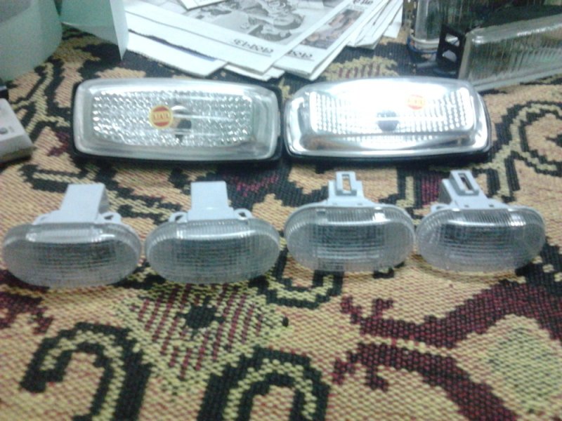

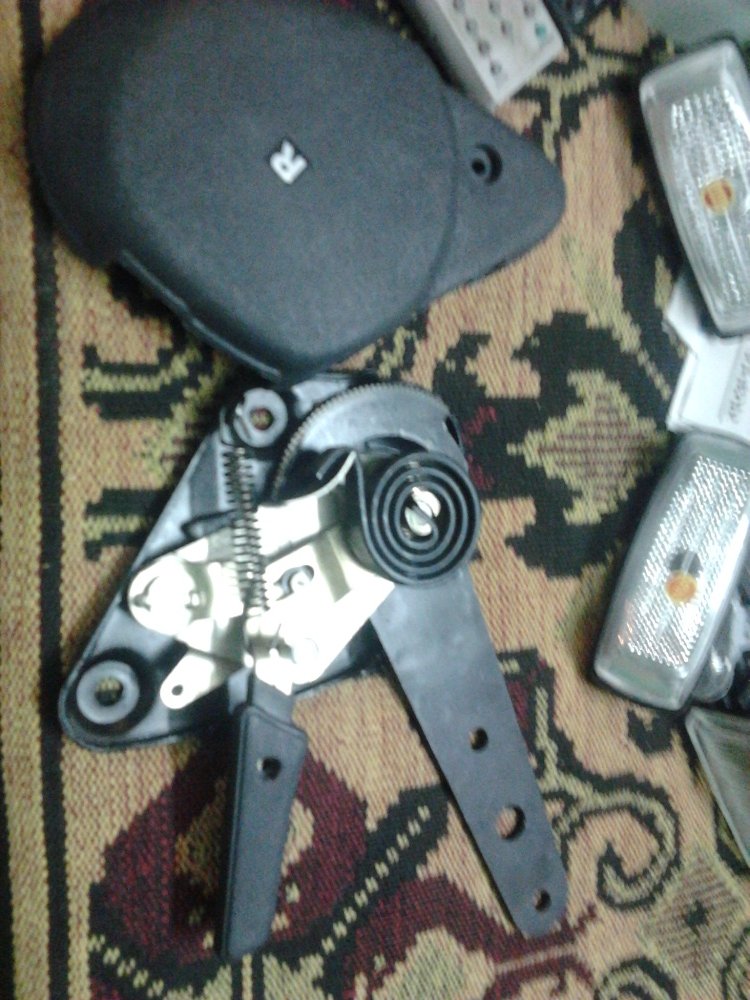

Today went for some shopping (for my car) and bought the following:
1. Seat Recline Lever Rs 350/-
2. Stickers Rs 1200/- (more pics will be attached soon)
3. A pair of Rectangular Driving Lamps Rs 250/-
4. A pair of Tata Sumo Indicators Rs 150/-
5. 2 pairs of Alto Indicators Rs 120/-
6. A headlamp relay Rs 180/-
7. 4 door light switches Rs 60/-
8. Brake Light Switch Rs 55/-
9. A packet(100pcs) of Hard Board Buton Rs 75/-
10. Front Bumper Brackets Rs. 110/-
Also bought Red LED strip and fixed in the rear window (attached to the brake Light)

Hi Shantanu.lko, you are back in action ! BTW why 4 alto indicators ?
Why again driving lamps (its looking good).
Is that body graphics from AUTO GRAPHICS ? You could have bought some thing like what I have on my car, it would look good on white background.
I myself don't know why I am adding so much lights. I just saw them, liked them and bought for adding it to my car. My friends say that soon my car will turn into a decotora
Yes they are from autographics, these were my friend's choice.
Even I had some wild guesses am waiting for your work done. Some Ideas I have also got after seeing some items you have bought.
Oh even I got to know those wild guesses ! It will be door warning lamps I think.
Yes sirs, they are for the door warning lights. Soon I'll re fabricate the door panels.
