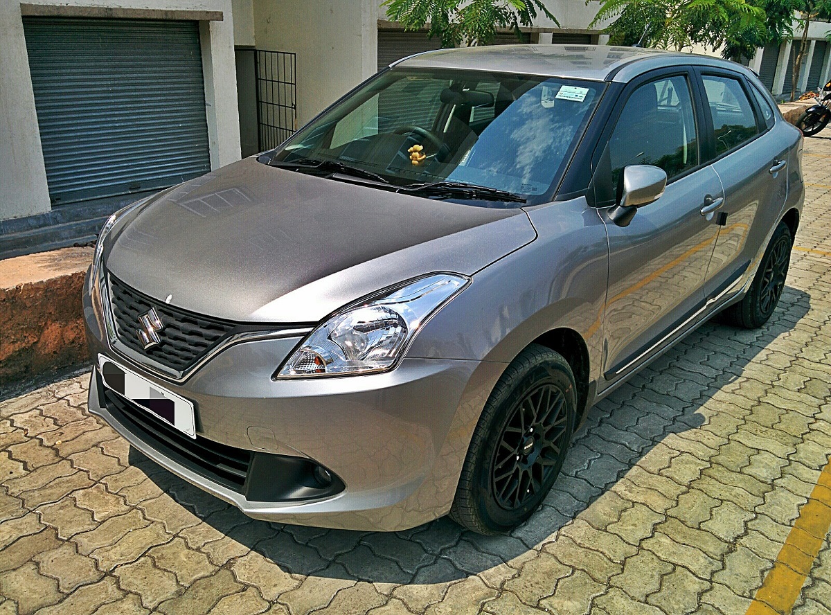

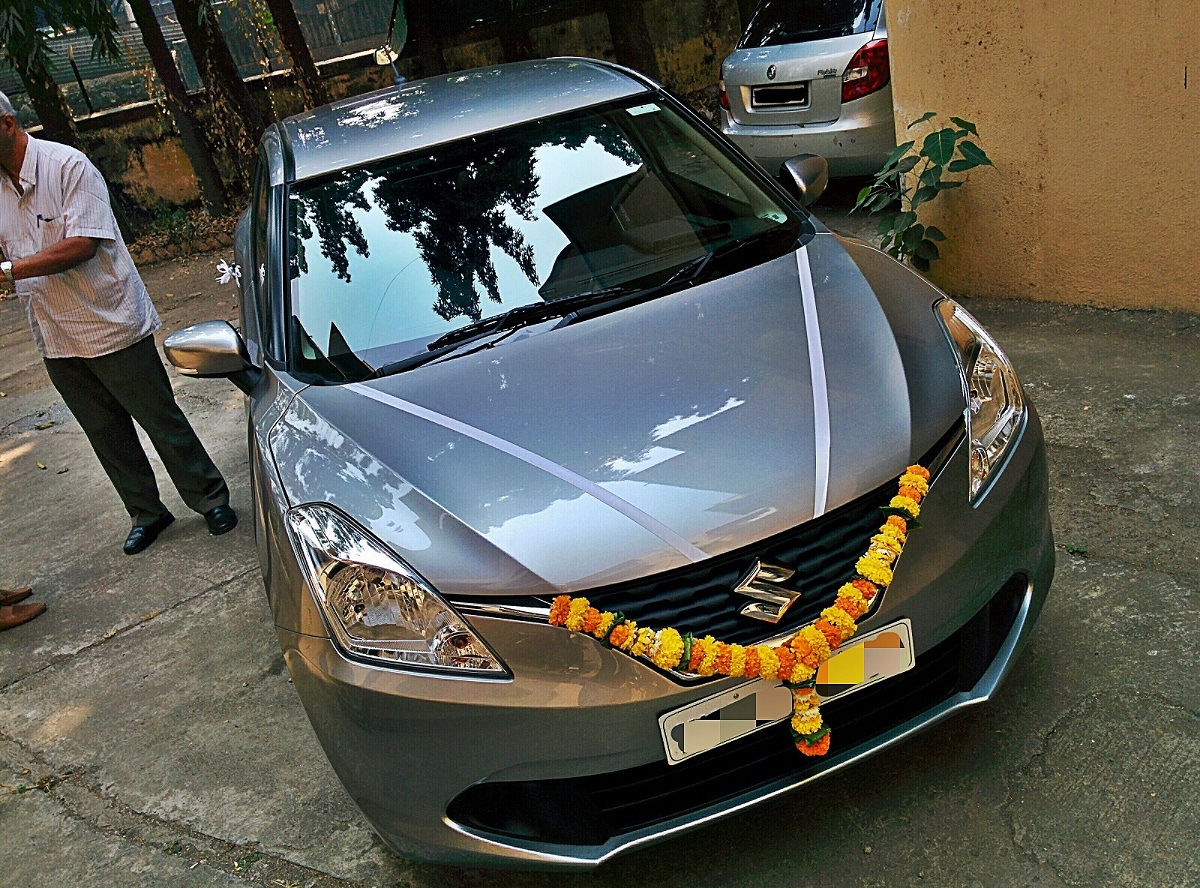

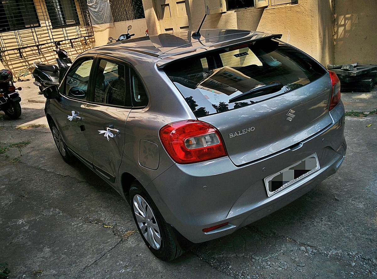

I messed up with the images if the car. Posting them again as I am not able to edit the current post.
Following are the pictures immediately after the delivery.
Following are after the Alloys were fitted to the car
Sorry for the multiple posts.
Superb alloys Bro.loved it to the core,some how the liquid flow design of baleno does not suit some kinds of alloys available in the market.
