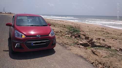

wanted to share my recent experience on a long trip with my xcent S(O).
i covered 2450km mumbai-vadodara-somnath-porbandar-dwarka-ahmdbd-mumbai with 3 pax and 4 bags. regarding the tak sound, i used to get it sometimes before this trip hence didnt give it much importance. in this trip, this noise started coming very often. apart from this didnt have any issues, the 185/65 r14 michlein xm2 gave great control and smoothness and the mileage ranged between 25-27kmpl with AC on always (speed being 100-120kmph max time)

Wow!! A 2450 kms long trip..! Sure you had a great time driving your beauty.. I have the same size tyres on my Grand (Yoko 185 65 R14).. Couple of things -
Post installation of wider tyres, do you feel your car's steering wheel has gained additional weight which feels a little heavy at times? Not too heavy but a tad heavier than how it should be? I'm a little unhappy with the amount of weight it has gained while on slow speeds in city traffic conditions though the steering feels pretty planted on highways and on high speeds. Please share your experience and thoughts..
About that annoying"TAK" sound, have you got it checked or planning to get it checked?

regarding the weight, yes, it feels much more planted and it does feel bit heavy or i should say appropriate. on city traffic, the steering is still light, no major changes in the weight.
regarding the clutch sound, will go to HASS soon.
