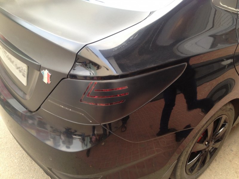

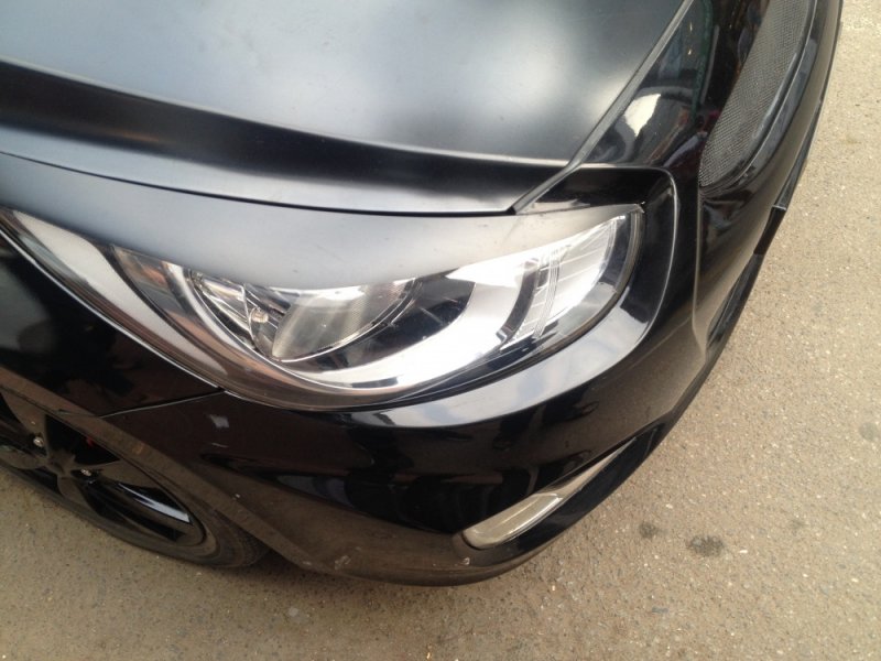

Hi Guys..I am having a black Fluidic verma. Planning to change the stock alloys. My plan is to put white alloys. What you guys think ? Will that match with the black car.
Or someone can help me to give an idea about rim painting ? Or if i can put 3M stickers on rim. I heard something like that. please help me
I too have a black verna and I happened to see this car while I was out for shopping today. I guess this is what you were looking for..
Adding pictures....
