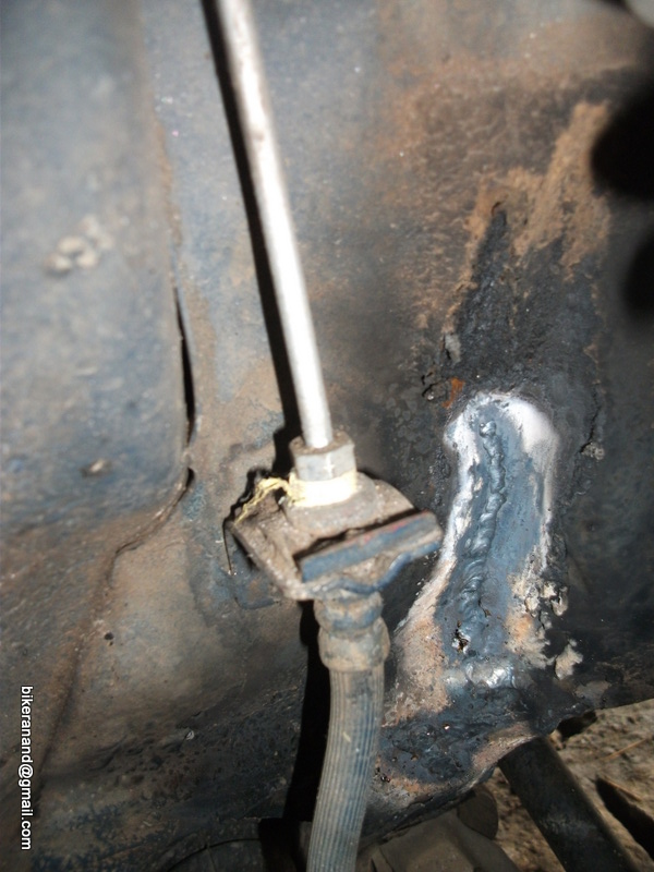

The apron crack welded at a Tinker shop for 100 rupees! The crack was longer than my observation. Bought new transparent floor mats 600rupees - Universal size, it can be cut to suit any car.
I will post pictures tomorrow.

Anand, that welding job does not seem to be done well.I hope that it lasts long enough and doesn't give out cause of bad roads and road vibrations.
