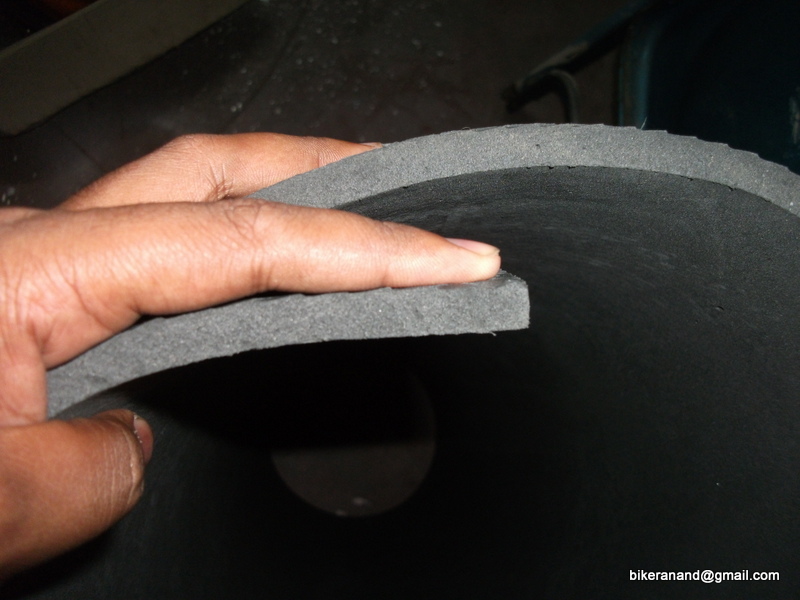

Here are the pictures of the mat. Guys please do suggest if I should add some thick soft cloth too, so that noise cancellation is more. Otherwise I would not be able to enjoy my new ICE, if the engine is roaring inside the cabin [:)]
Thickness of the mat
The sheet looks thick enough to give you nightmare while fixing, but i am sure you'll figure it out.
For insulation try using 25kilo jute bags of rice (bora in local lingo). Use 2 of them, place it in between the firewall & this rubberised sheet. Have experimented this on my older cars, works to quite an extent.

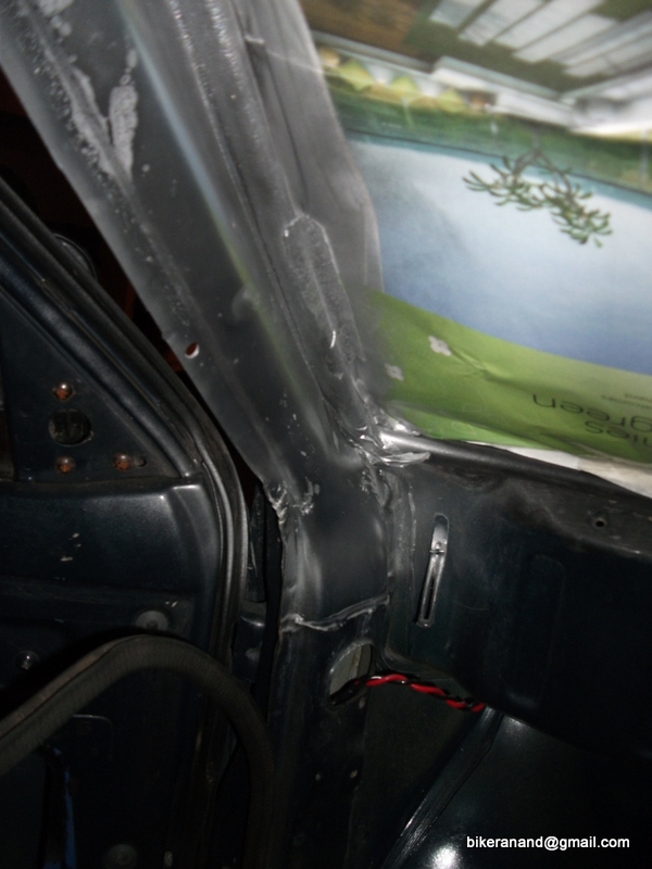

Painted the A pillars today with a "F1 chrome spray" just wanted to hide those tinker works done previously (a month back) I am working on a DIY plastic trim for the A pillar so that this paint is not visible.
Covered both sides of windhshield to avoid the paint smoke getting in contact with it.

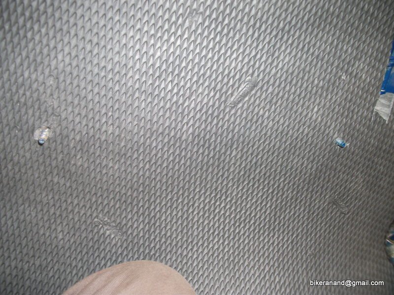

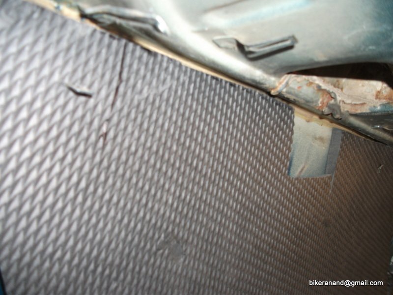

DIY Damping of firewall completed:
Let the photos do the talking :D
1. Stripped the interiors fully
2. Stuck papers to the firewall using masking tape & traced (cut) out the shape I wanted
3. Placed the paper trace on the rubber sheet & cut the rubber sheet accordingly
4. This thick rubber wont bend much so I had to leave the wheel arch as it is
5. Thanks to the newspaper method, I could leave space exactly for the blower mounts & some hooks already used in previous factory damper cloth
6. The rubber sheet has cuts at the bottom part where the exhaust tunnel starts
7. Hole for the steering thing to fit
8. This area I did not explore much as the brake pedal etc comes here & I do not want to spoil any of them
9. Time to check if everything is alright

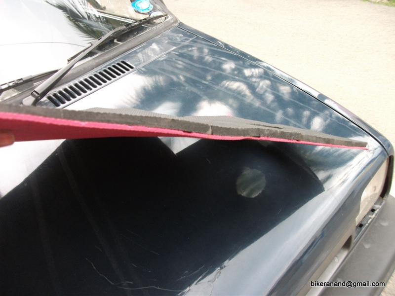

10. One layer of Yoga mat to protect the rubber sheet from heat & also the yoga mat is sort of water proof. The rice bag idea is risky as 800 has too many holes on FIrewall any water leakage will be soaked in the rags & rust might start.
11. Completed sticking
12. Finally applied SR adhesive on both surfaces & left them to dry for a couple of seconds before placing them.

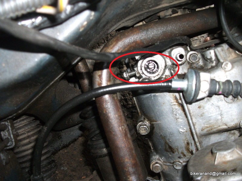

Also today I changed the speedometer cable in my car.
The old cables point (connecting part)
The new cable
The speedometer cable's one end fits the gearbox & there is a 10size bolt which needs to be losened to pull out the cable. Here is a pic of that.
