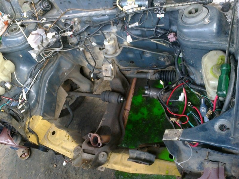

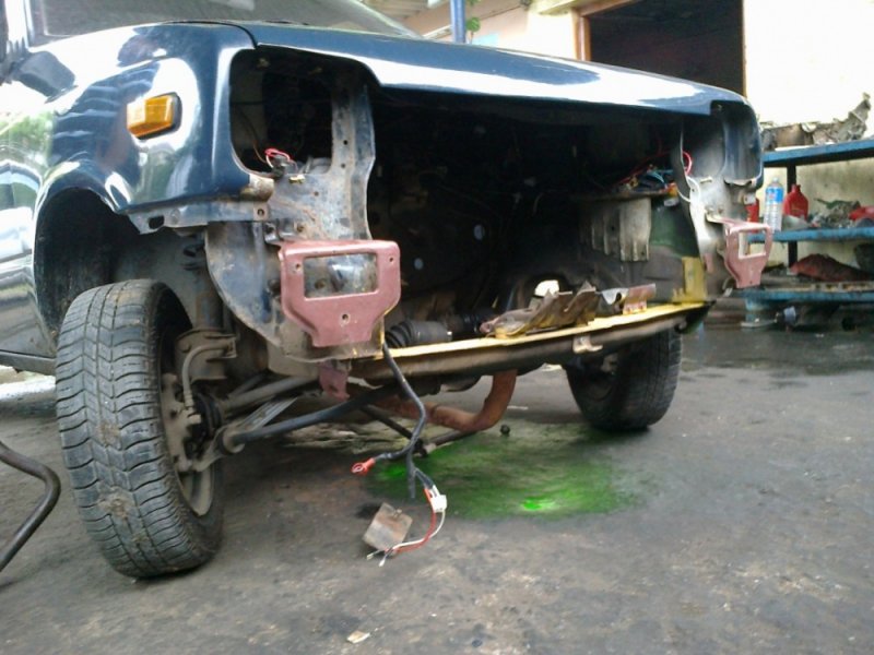

THE BIG SERVICE! Gearbox Overhaul, Oil Sump, hose kit etc replaced
Hi everyone,
Here is a BIG update,
Finally after lot of delays, I managed to take my car for service to our trusted mechanic, for these repairs
1. Gearbox Overhaul (Replacing all bearings + new 3rd gear part)
2. Oil Sump/Pan replacement
3. Coolant Hose kit
4. Fuel filter & adjoining pipes
5. New Clutch Cable
6. Steering boots replacement
7. Drive shaft boot inspection & replace if necessary
8. Front Cross Member (Chassis part replacement)
9. Carb Tuning
Here are some pictures of the progress on Saturday.
The engine seriously looks tiny next to the car (but although small packs a good punch)
My Car Gearbox opened for inspection [I must admit that I am confident about this honest mechanic, my car will be ready for delivery may be by Monday or Tuesday & I am not really worried about it (safety/parts etc)]
The third gear is damaged & hence a new replacement part will be fixed soon.
Our Mechanic opened the Gearbox right in front of us & cleared all our doubts on how it works, whereall the damage is done, parts & their job etc

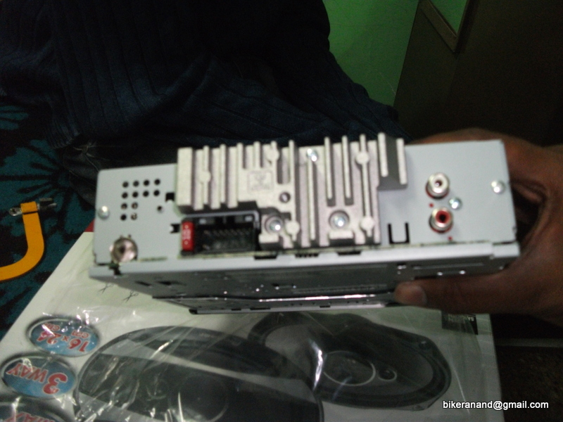

Bought the below items for my cutie today
Moulded Roof of Maruti 800 Type 2: 1700Rs (including clips)
Alto fuel cap opener : 37Rs.
Pioneer Headunit 1490UB (No cd option, only USB & AUX): 3300/-
Pioneer speakers 400W x 2Nos : 2100/-
Pictures will do the talking.
