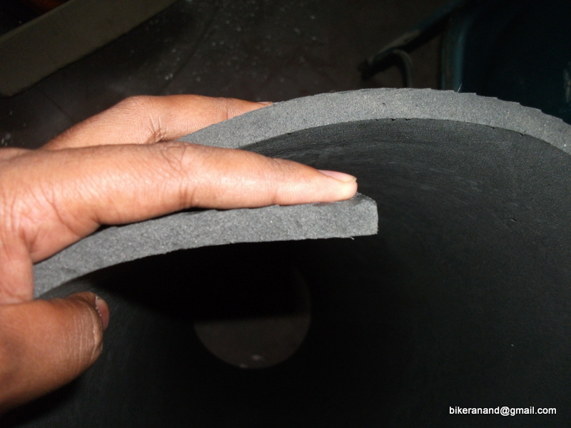

I have removed the damping material on my car firewall long back as it was in bits & pieces. I threw it thinking I will get a new one, to my horror most shops dont sell these! MGP has no supply of this thing!
In my last trip to Vellore, my cabin was literally an Oven with no roof & naked firewall (its pretty hot after sometime). So I bought the thick (almost 10mm) rubber mat used in Auto rickshaws. I will take measurements patiently & cut it where ever required & will fit it tomorrow. Dashboard too will be removed & fit back with blower connections etc.
I will post the photo tomorrow. It costs 330/- bought it from Kalasipalya (near Basappa circle). Shockingly the same mat (same material & size) costs 600/- near my home! A friendly Auto driver guided me where to buy & also gave a sample of the one he was using. Hope this DIY helps in reducing engine noise & some amount of heat shield on the firewall.

Here are the pictures of the mat. Guys please do suggest if I should add some thick soft cloth too, so that noise cancellation is more. Otherwise I would not be able to enjoy my new ICE, if the engine is roaring inside the cabin [:)]
Thickness of the mat

Please do click pic of installation I am too interested to lower my gypsy roaring to enjoy peaceful cabin
Thanks Mastersquall,
Surely I will click photos & upload here. This sheet alone wont absorb the engine bay noise, hence I need to add something softer than this in between this sheet & the firewall & glue them together. The blower unit will hold them tightly once fixed. There are much softer variants of this rubber available (it is used in large commercial vehicles like Tata Winger & Tempo Traveller. However those rolls are much larger & costlier too. (If you plan to use similar thing in gypsy then this roll wont be enough) I will post pictures of measurements & installation by tonight.
