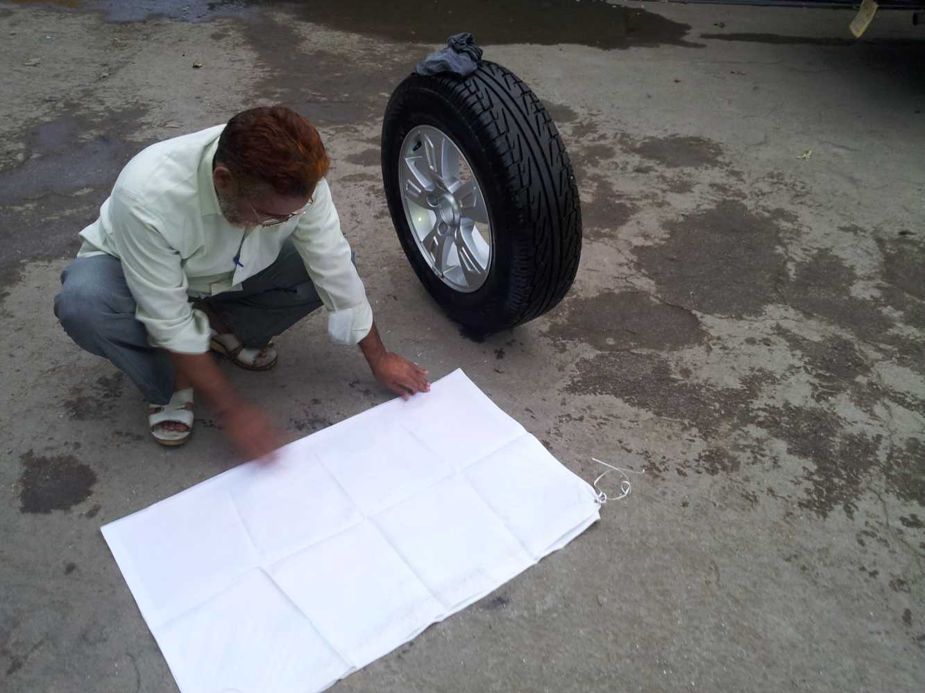

Spare wheel Tryre Rubbing Problem-
When I revealed the Spare wheel to check air (TPMS was throwing warnings), I found that the spare wheel mounting Mechanism was slightly rubbing against the sidewall of tyre, as seen in Pics-
Worst thing is, its also abrading the alloy rim!
The Solution was to take a Thick plastic sheet, cut it along, and fix it when mounting the spare wheel-
