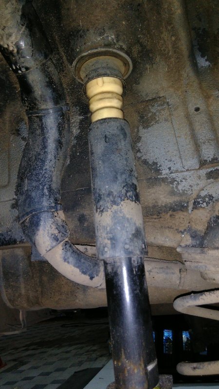

Some rubber bush in rear shocker had degraded causing suspension cover to fall over and make irritating noise. Thought have to change whole shocker due to Chevy part policy, but luckily subpart was available. They call it jounce bumper.

The so called jounce bumper.
