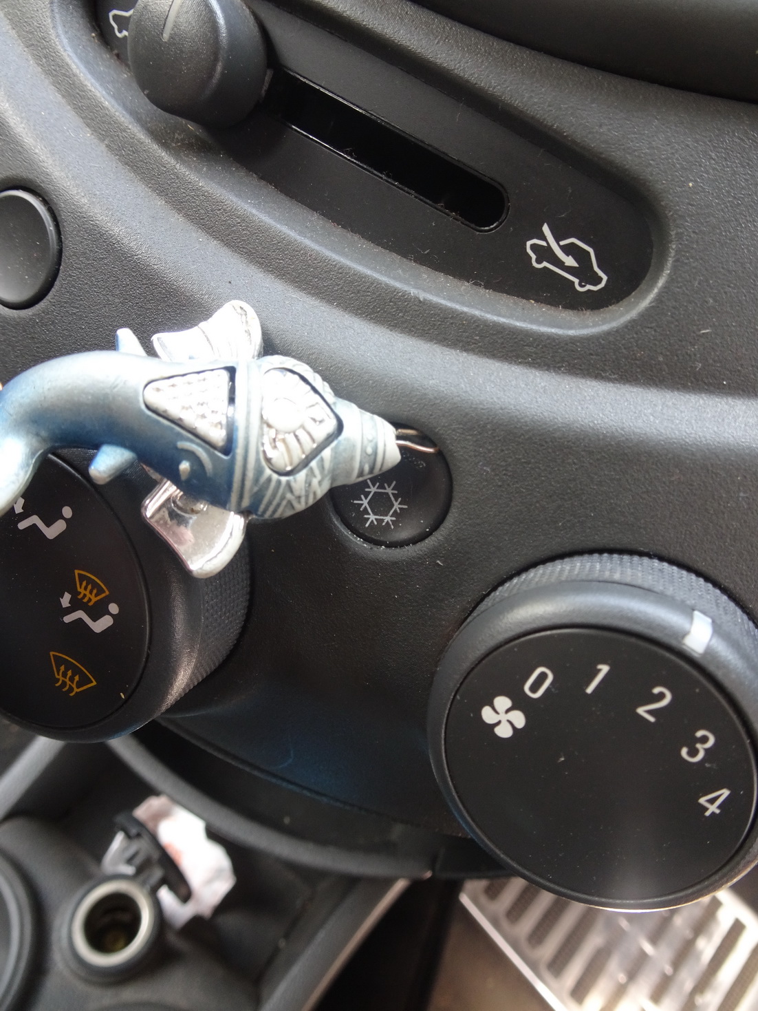

New issue. AC switch packed up. Not user replaceable. Dunno how much crore they are gonna charge for it. In the meantime, Ganapathy Bappa for rescue. Switch always ON, stuck with the pin. ON /OFF controlled via the fan control knob.
