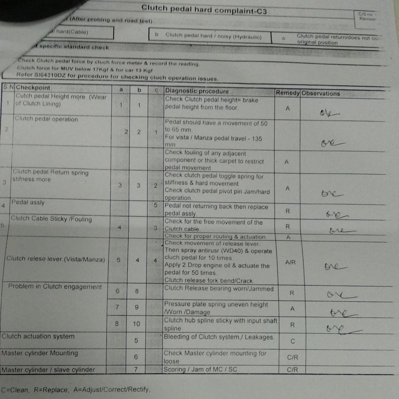

My Tiago crossed 24K this week and serving us as faithfully as always. I had to visit ASC to check the below:
- Clutch felt hard, especially after driving a new batch Tiago. I guess it's just greed. They did some tests and declared it worked fine.

Off late I have been noticing uneven power delivery (kinda like jerks) between 1700 and 1900 RPM range, very much noticeable in 3rd gear. This is evident only under sedate acceleration (or holding engine between said RPM range) and won't be felt with strong acceleration. ASC folks checked the spark plugs and found slight traces of oil. Initial impression was to replace cylinder head but after they opened further, it was decided against replacement. Instead, all spark plugs were replaced and they test ran my car for a day. They were also going to change a minor part that is out of stock and will call me once it arrives.
Next day I was called around 4pm for pick up but I could not do a test run with them as it was late to leave for my native place. Had I done a test run, I would not have taken the car back at all. The jerks are even more evident than earlier and felt annoying to drive. Called them up about this and will have to visit again for further troubleshooting, once the out of stock part reaches them [frustration].
Here is the invoice copy. I had requested to change the clutch due to its heaviness when compared to latest batches. As expected, new clutch has a better biting point and softer play.
