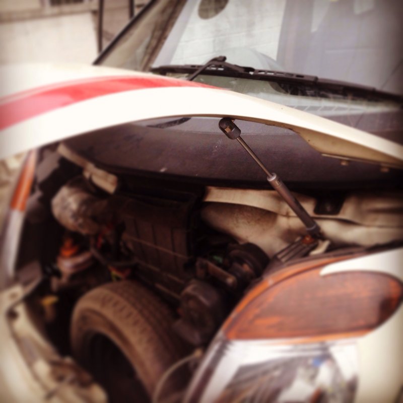

Some thing is cooking under the hood
Unique Idea. I hope you figure out how to close bonnet completely with this thing installed.

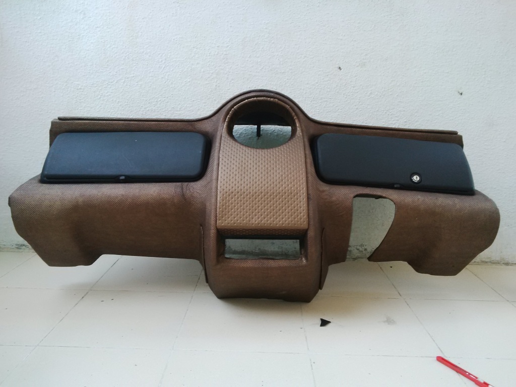

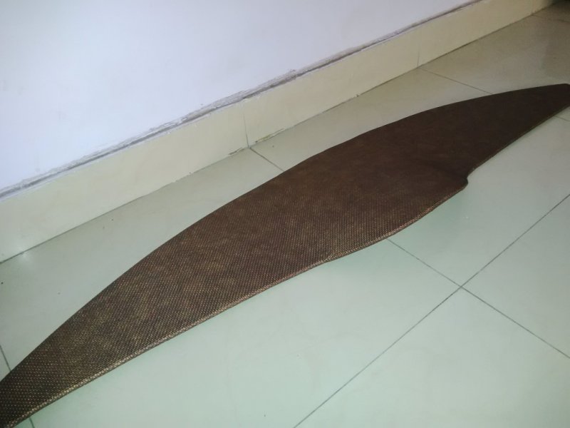

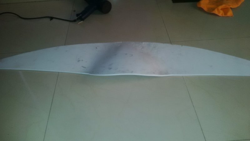

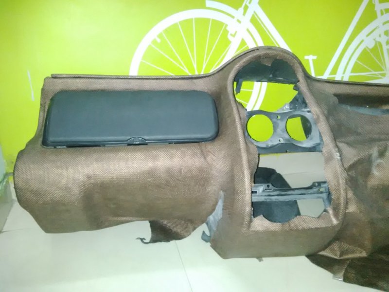

Done with PU Leather wrap on dash board, wanted to do in black colour material, but I found extra material lying at house from last year's sofa works so decided not to buy new material. I am not professional leather worker or anything.
This was just DIY attempt, results are good not perfect, but I don't mind having those minor problems. Hope you guys like it.

Not only good. but Very very Nice diy. I liked it really.btw which solution you used to stick leather?Is it possible to use sunmike or formike which we use on plywood?
I used Loctite General Spray Adhesive and locally available rubber adhesive. sunmica is not mouldable so it wont be possible to put it in one piece, you can try wood finish vinyl or matting i guess, even PU leather is avaialble in wooden patterns.
wow shibu, i am glued, this will be like too good deck opening with struts.
i wonder if the same can be applied to the boot? just the metal part below rear glass, more so if it can open like the engine cover on volvo buses, should give it a try.

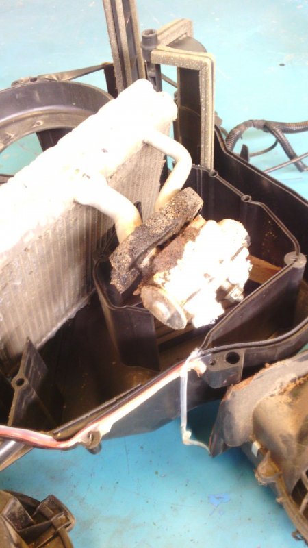

AC not working in my Nano
Service center guys confirmed no warranty for Air - conditioner.please confirm friends?
I have 6 more month warranty period,

Hi Friends,
which part is defective? no warranty for tubes and pipes. if you have any leaks in condenser or evaporator coil, that part will be replaced in warranty and you have to pay for AC labour and AC Gas refill

Thanks Saishibu

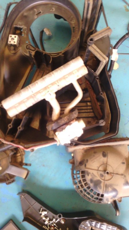

I gave it to another ASC (KRS Car care)
They confirmed coil is gone.
they asked me to wait as They are in process of warranty checking.
Attached pictures of coil,It is totally rusted and very bad condition .
I will post further updates here

Thanks Saishibu
i have changed the same , the coil costs around 5k, made by Behr . TASS took around 5 days to do that job.
The coil got rusted and that made a small hole.
The condensed water stays on the coil causing it to rust. this is a common problem in nano.
Before turning the engine off. switch off AC and let the blower alone run. wait for hot air, then switch off engine. this will avoid rusting.
also ask TASS guys to check for any blocks in the water drain pipe.
Change pollen filter also
after the work ask them to spray AIRCON cleaner in the vents, this will avoid odour
