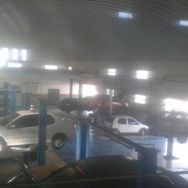

30 mins. back , I reached Naw (National Autowheels) pune, workshop, found workers including SA MORONS preparing for DIVALI,got a pic .I wish they gather around a car, when it reaches the workshop with a nigel.[cry]
Two hrs.back I called NAW workshop, came to know clamps including ARB bush are available with NAW.
SA Rahul attended me.I asked him to check the cluth, He said it is 'too hard', promised to get both the problems solved by morrow.
I told him to check the oil , he said it isi less viscous, and get the history checked, as oil was changed 3kkm back.
I told the lady incharge that I will not leave the workshop till my car is taken on ramps.
then I entered the waiting lounge to find cabies utilizing it as seen in the pic posted. .....here

first pic show s entrance of NAW TASS PUNE
second pic shows diwali preparation .
third pic shows waiting lounge.
Fourth pic shows car on the ramp.
