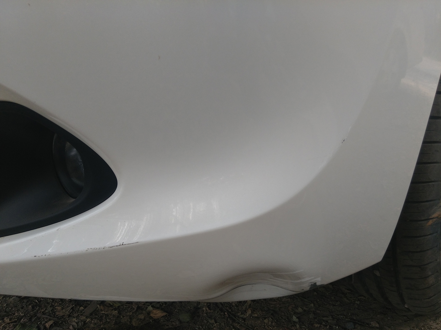

Sorry, guys. got busy with something so couldn't post the pics of scratches and dents earlier.

Don't go to the repair shop for such minute scratches. Unless there is a big dent which definitely needs to be repaired. Scratches are part of Indian vehicles and should be ignored. Also don't feel sad about it. If your car is going along fine then its ok.

Push that bumper dent out yourself. Its fibreglass, should come out easily.
For the small scratches on the door, get a com paint pen of the matching shade.
For the fender dent, just leave it as is because it is difficult to patch without priming it

Instead of worrying about it try this when you are free. And i did it in my Ritz Vdi white colour (now sold). And the very minor dents went missing.
Apply clothes washing soap (just take it in your finger) in these minor dents and rub the dented part with the finger/cloth and now use water and wash the dented/soap area when you feel that the rubbing done with the washing soap is enough and now your car looks pretty nice as new without the dents being invisible.

Using soap instead of compound. Good idea but it shouldn't make things worst. In-case the soap is aggressive. However, it only works if the scratch isn't deep or only the clear coat is scratched and some paint is still present.
White color cars has white primer and when scratched, it won't be much visible but the bumper would be black so when scratched, it will look ugly. Vice versa is for black cars, not a problem with bumper scratches but scratches on body will be more visible due to white primer.
Like ameyam said, matching com paint pen or a matching paint from car paint shop can be used to touch up. Once its dried, use rubbing compound to erase excess paint, polish to smooth en the paint and wax to protect. Though it won't be 100% perfect but should hide pretty much.
As of dent in the bumper, I'm sure it will come out. See if you can go behind the bumper and give it little push with a finger but don't hit it.
First time damages to our beloved car will hurt more and may also interrupt our sleep but worrying about things which is already happened makes no difference so be happy. I still remember when I had my first car (Tata Nano) and I hit its passenger side door to a tree when parking but I was still a beginner. Now I own a used Honda City which has dents and scratch all round made by previous owner but I don't mind it as long as car runs fine. When given to servicing, the service adviser takes 15 or more mins to note down all of them but I'ed say him, don't worry sir, even if you make another I don't mind or even notice. :stupid:

Yes, you are right it only works only if it is a minor dent and as per the pictures posted by Chandra1 this is very simple dent what we had in our Ritz was that the fiber parts above the tyres was about to come off but after using the soap half of the dents were not visible and atlast after a few weeks painted the whole car white again.
No, i didn't tell to scratch the dented area instead i just told Chandra1 to give it a nice rub with clothes or fingers whichever is comfortable.

The soap took away the scratch on the bumper of a white color car? Sorry but I don't understand how this happened. [confused]
Because when paint is chipped from bumper, the fiber will be visible which is black in color. That is what happened to Chandra's car. How does a soap brings back the white color? or does it fill the scratch?
Some soaps are aggressive and they will scratch or make paint dull even if soft rub. It would be good if you let us know which brand soap you have used.

Sir in your case, the paint was not chipped off but the maroon colour of the other car would have stuck on your car's bumper. Instead of soap, even if you had used water or rubbing compound, this paint would have gone easily.
So soap does not fill or repair the scratch CRACING.
Chandra1 - Scratches are too minute to be worried about. That bumper dent can be easily removed by pushing with a hard object from inside. Apply a good rubbing compound over the scratches to see if it helps.

Thank you for the help guys. It pains to see bruises on your new shining car but it seems impossible for a new driver like me to avoid scratched in traffic. [:)] Aren't those black scratches metal? I was worried about rusting. Sorry if my questions sound stupid. I'm really a newbie when it comes to cars.

Bumpers are not made of metal, so those black scratches won't rust buddy.

If the scratch has a black underlay, its fibreglass. Usually happens on the bumpers
If its on the bodywork, your scratch would be white. In this case, just patch with paint of matching colour. The primary function of paint is to protect the base metal against rust by keeping water away from the metal. So a patch serves the purpose. Asthetics is secondary but you should be able to get a similar effect with paint touchup
