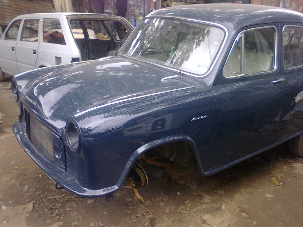

Hi,
What is the White color rounding the Front Glass Beeding. Whether it was a painting job or small steel kind of one.
Feb 19, 2013
109
43
Dubai
Hi,
That is the original Mark II beeding which comes with the aluminium show beeding. nowadays very few people only know how to fix this show beeding the rubber glass beeding. it will enhance the beauty to dark colour painted ambys

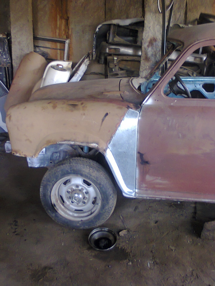

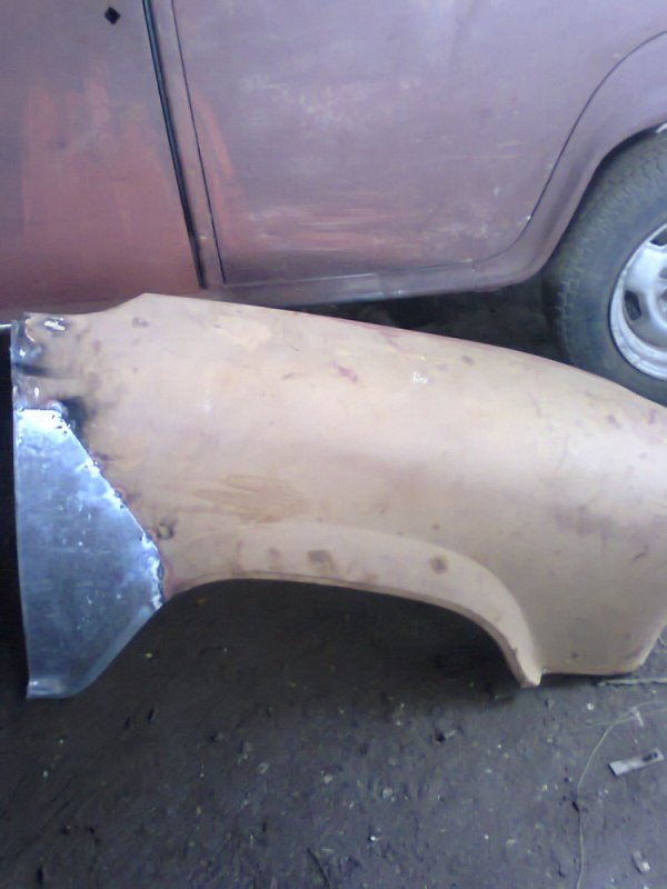

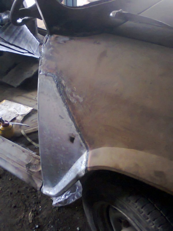

hi, posting update of work as right side fender corner piece patch work is done and mounted to the car and all 4 doors are dismantled and the door hinges have been sent to lathe work for fitting new latch pins/bushes
