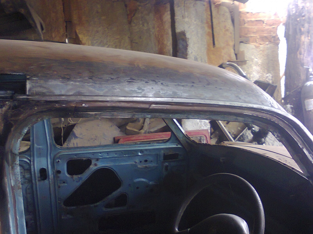

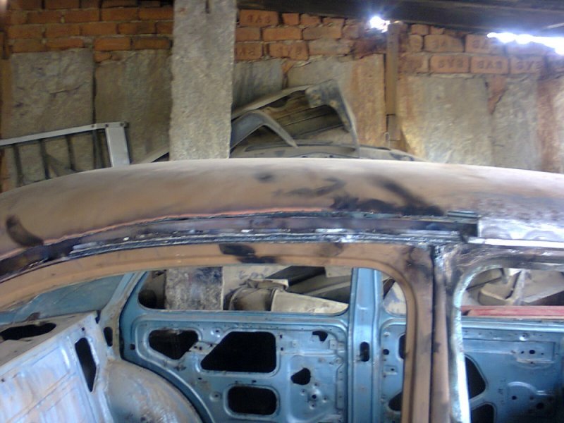

I am uploading few pics of the car work done on right side which include
1. running board
2. mudguard arch doom inner and outer
3. door patch front & rear
4. front glass frame pole
5. water channel completely removed 3 layer and rebuild
6. necessary patch & tapping works

Doing a good job.Appreciate the efforts taken by the Tinker.
So how much is the amount you have finalised for the Tinker.
