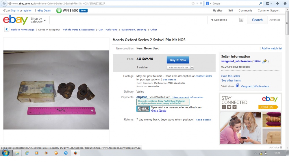

hi excels, to my knowledge swivel pin assembly design has been same from old(morris oxford series 2 to 5) to present models(HM ambassador) only minor changes have taken place ( like bush size and tie-rod end arm), so what is your exact location now ( India/ SA) because if you are in India you can get it pretty easily, if you are in abroad you have to source(shipping is headache)
I am attaching the pic of swivel pin assembly, let me know if its matches to your model
Thank you for the reply. It looks correct. I will confirm later today. I am in South Africa, so postage might be a problem. Regards.

Hi HKS2412. The swivel pins will work. Do you have the contact details for a supplier? Thanks.
hi, the 2 pics of swivel pin assembly which i uploaded in previous post was sourced from two different international websites(suppliers) please check out
swivel assembly - Tony Noonan.com
bush link - www.ebay.com.au(Australia) contact seller for shipping to your location

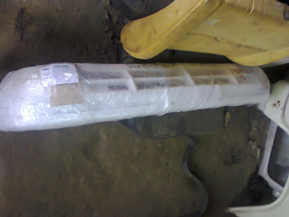

hi guys, posting update on work as boot lid was replaced with a good one(existing was rusted badly), rear chassis was replaced with new one(no pics) and new grand bumper (with fog lamp housing) was shipped from Coimbatore reached yesterday
