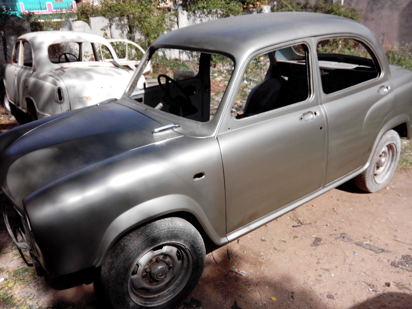

Hi guys, i am updating the last 25 days progress, as i was out of station mean time i have finalized the color, its Vapor Grey (jaguar). The base coat is applied and is ready for final coat but the weather is cooler here and its frequently raining so waiting for appropriate temperatures for final paint.
The color reference( Vapor grey pearl- Jaguar)
Final surface level before base coat
After base coat

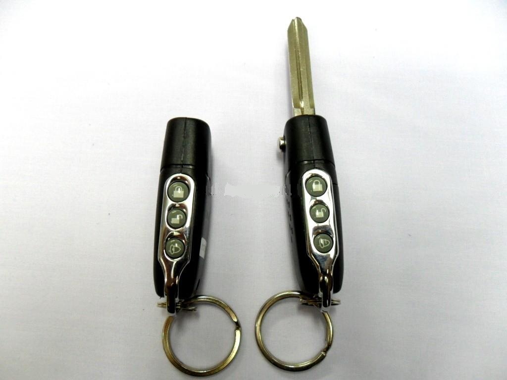

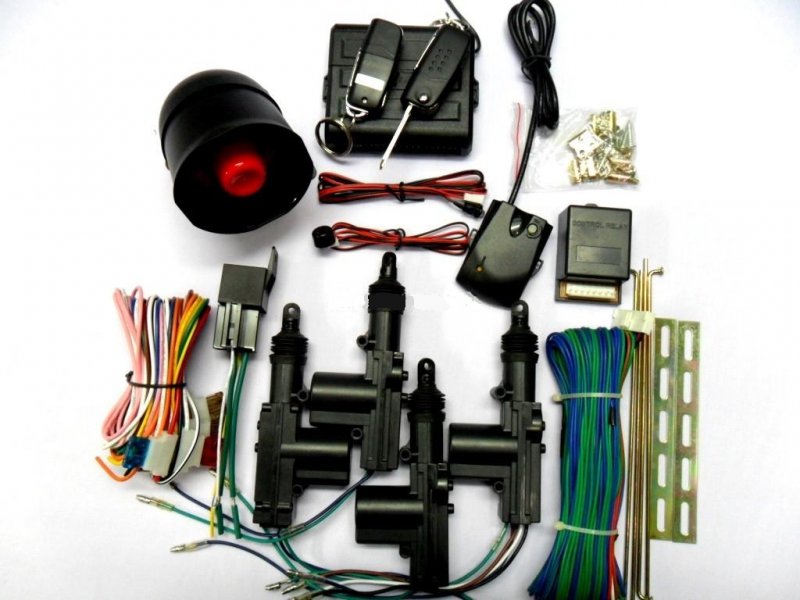

Hi guys, i had ordered for central locking system with remote control flip key option and the kit arrived today through air-parcel, so feeling excited [:)]
As per the pics, it looks really good and tidy![:)]
Taking this much care of an ambassador shows how much love you have towards your car.
Anyways, good luck on getting it fixed[clap]

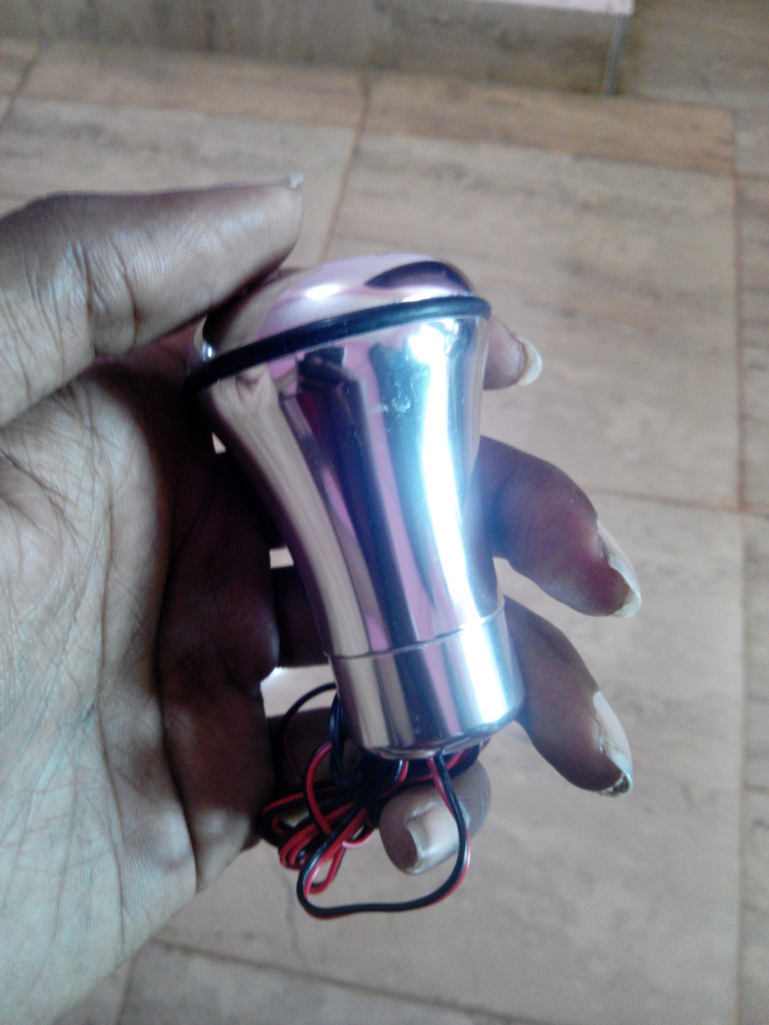

1. Illuminated Gear knob (blue color)
