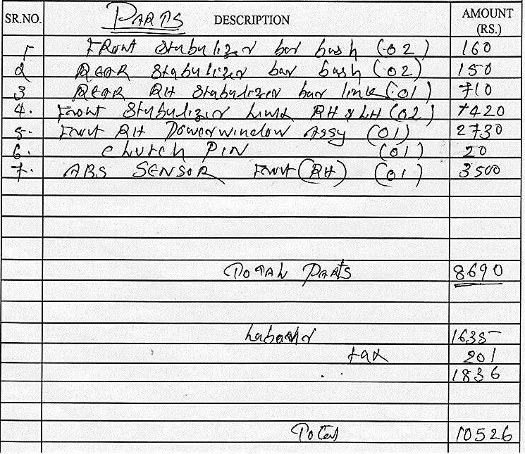

Update:
Got a detailed e-mail from the SM stating the following:,The estimate really is a little "bomb"= Rs. 10,526 including labour and Tax.
  • They detected a faulty RH ABS sensor and a malfunctioning [Stuck]Power Window.
  • All stabiliser bar [front & rear] bushes and Rear [RH] & front stabiliser links needs replacements as the rubber seemed to have got hard and lost flexibility. Blame it partly on the poor quality rubber and also lack of regular exercise for the suspension parts [vehicle rarely used these days].
They have already replaced the faulty ABS sensor and road tested. As I requested I wanted to get the 70,000km service too done this time around. He gave me an estimate of Rs.9,000 including all major oil including that of the differential and filter and re-tightening of all mounts.
But Withyouhamesha.com says differently quoting an estimate of about Rs.2370 for the 70k km for my SUV. Sent an e-mail to him attaching a copy of this estimate and asked him to confirm on this.
He was saying that the service history data only says "repairs" not any recent "scheduled services". Again I took a copy of the last 4 services including the 50k and 60k with multiple check ups in between and sent it to him.
He has only corrected the ABS issue and is waiting for my reply on the remaining works including the suspension bushes, power window and 70k service. I can actually put up with everything except for the critical ABS sensor and I am sure not many Scorpio owners are getting those rubber bushes changed every 5k kms.But it does make a world of difference as far as ride quality is concerned.
Edit: I have also asked him to confirm that the ABS wiring harnes is fine as the other A.S.C at Palakkad was suspecting it to be the culprit.
The total Estimate as of now = 10,526 + 9,000 = Rs.19,526
