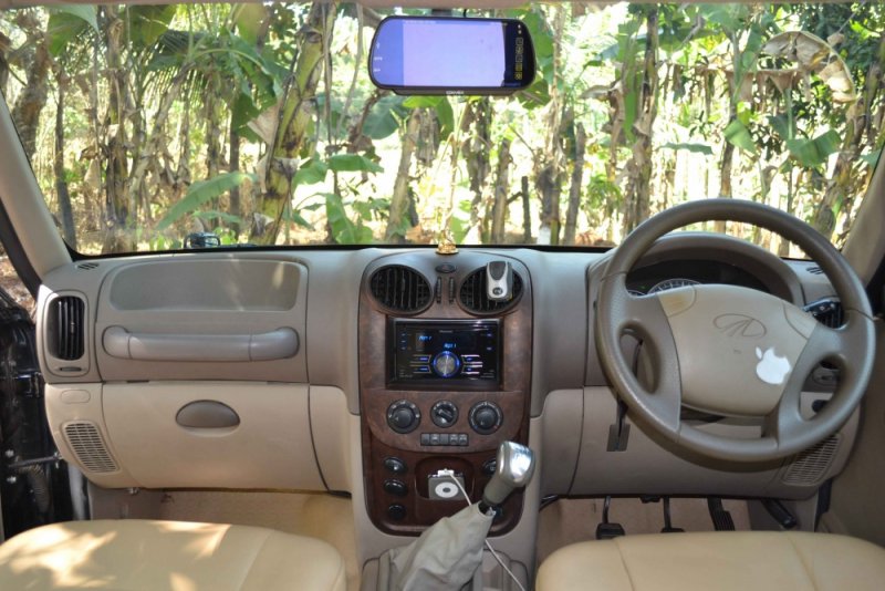

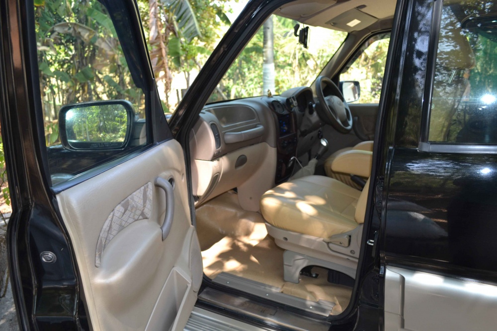

More pictures
8,139
1,792
Re: Powered By M-Hawk: Mahindra Scorpio SLE. 3.5 Years and 50,000 Kms
@Manoj
Welcome to India !! hmm we could have met in Bangalore, but you were in a real hurry to attend to your vehicle it seems, no problem.
That was a wonderful service from M&M it seems.
Hope you are enjoying reaching home as those pics say that.
Wonderful pics and I think your scorpio is maintained so well man !! was looking just brand new after 3+ years and 50000+ kms. I like that black with silver in Scorpio very much.
BTW in which gear it is as two of the pics shown there
Thread Starter #39
Nov 29, 2012
1,642
2,089
K L-9
@Manoj
Thanks Gurrala74. We would meet sometimes in future
yes. A Royal treatment indeed.[clap]
This time I am staying in our old house with my parents, where I spent my childhood in this wonderful place in Palakkad.Enjoying every moment [clap]
Yes. My Scorpio did receive the very best care and treatment from the very first day
In neutral I guess.
