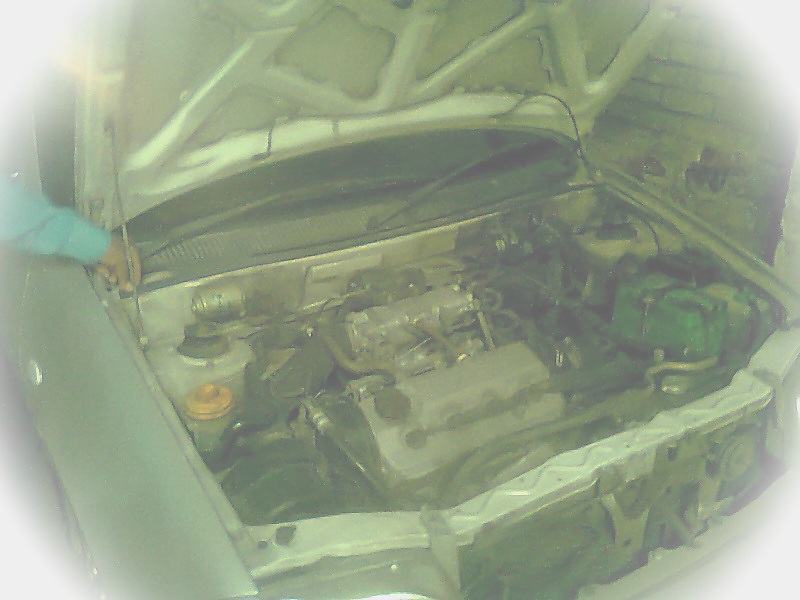

Got the engine oil changed today. The same synthetic oil i.e Liqui moly was used. Total quantity was 4 L.
So, Esteem reached the Fucon Technology workshop located in sector 8, Noida.
The oil has been changed after running the car for 8,300 Kilometers from previous oil change.
The oil filter was purchased by me from Sector 16 market. Did so because the workshop charges extra "commission" on all these items. Hence, did not give them a chance. Used the purolator oil filter.
The preparation of oil change begins!
The old engine oil and oil filter
Fresh engine oil being poured in the engine.
The total expense of oil change is INR 2000 and INR 100 for interior vacuuming. Total time 40 minutes.

Esteem required max 3.5 ltr oil as per the amnual. Is that castrol brand oil you filled?Only Rs.2K for 4 ltr synthetic engine oil? looks like engine room not cleaned for long duration. in maruti ASS, they will do some chemical cleaning in engine room if you instructed. Cost is rs.400 here in kochi.

I used the Liqui moly full synthetic oil for the car. I was under the impression that it uses 4 L since Maruti ASC doesn't use Liqui Moly. Engine bay is actually not cleaned due to my busy schedule. Will get it cleaned in a day or two as I will visit my uncle to know about the under-test Celerio.
Got the engine bay cleaned by air pipe since I was running out of time due to commitments. Will ensure its cleaned by chemical in the scheduled service.
