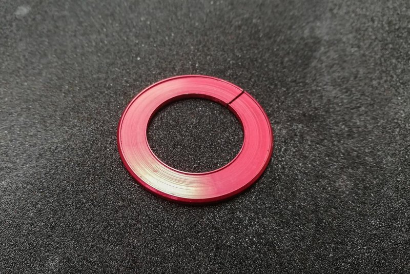

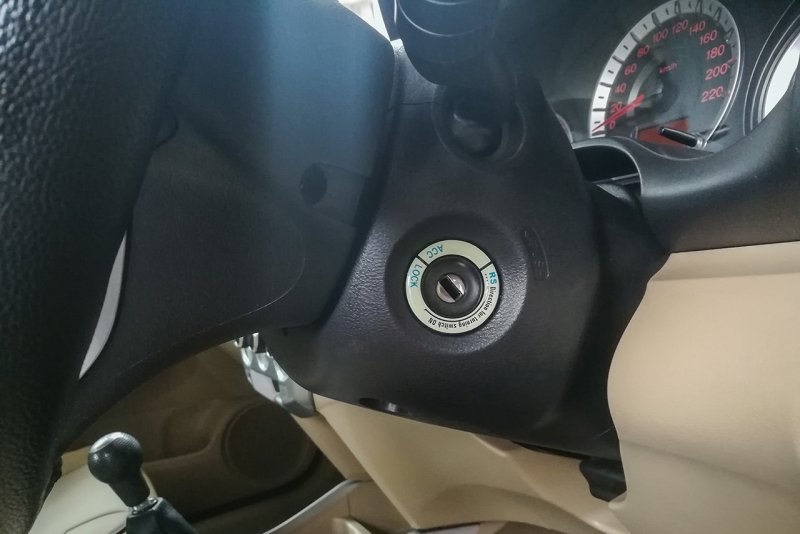

My car gets a new ignition key ring and this time its a self-illuminating. Previously I had non-luminous ring which was cracked in transit and still I was using it (Post #883). It was boring and I thought to try something new.
I received the product today and affixed the same by evening but unfortunately and unexpectedly, it hindered the function of ignition key (There no room left for the key to go in and revert back while turning it from off to ACC position and vice versa). I say unexpected because the listing of the product says that its for Honda cars including City. Link to listing. [frustration]
The red bezel is made of thick aluminum and self-illuminating rubber aka radium is glued on it. First I tried to sand it but it was a hopeless job. So I had to separate them and affix only the radium ring. Finally its looking good and ignition key works fine. The ring requires charging or activation by exposure to bright light and then it will glow in the dark for few mins. I have used mobile flash on it for few secs and it glowed bright in green color. Red bezel would have looked much better like a push button start but I miss it.

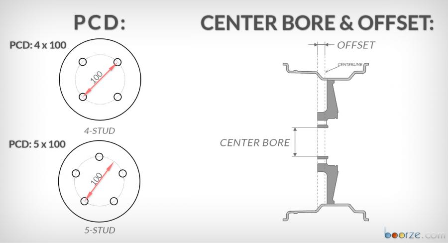

Sorry, I cannot say anything positive or negative about Plati alloy wheels simply because I have not come acoss them. Two things I can say though, one, the rim that you have shown interest in (PR-1410) is not a direct fit for Honda City 2011 because the Offset is too short (ET30) and the Centre Bore dia (CB 67.1) is bigger than ANHC's hub CB of 56.1 mm. Two, I don't see any standards of approval on Plati's website, like certifications from TUV, JAA, ISO, etc. That will be a deterrent for me to buy something from there. So, look for quality assurance certification from any manufacturer because wheels and tyres are critical safety components as far as I am concered.
I have used quite a few alloy wheels between 1979 and 1995. I will approve all them, but they are very expensive and may not have a suitable size for ANHC. These, in progressive order of upgrades are, Alpina, BMW factory alloys, Borbet and last and the best BBS (two sets because one set was stolen). In India my research led me to HRS of Taiwan, who happen have a very decent reputation for quality and reasonable prices. I have not put enough mileage on them to say, close your eyes and buy them. I have earlier mentioned a few brands, brands that I only know from friends and my garage: HRS-Taiwan, Freeman Racing, X2 Wheels, OZ Wheels, MOMO-Italy.
These are the 3 important number you have to hold on to when replacing same diameter wheels with alloys (15") in ANHC (2002 to 2013):
1. PCD : 100 mm / 4 Holes (any deviation here and the wheel WILL NOT FIT).
2. Offset (ET): positive 48 mm* (up to +/- 3% will show no undesired effect)
Note 1 : Offset is based on the rim width, wider the rim lesser the Offset in order to maintain the same or similar profile in relation to the wheel arch profile (so that it does not jut outside the car). I cannot find the specs provided by Honda India. This is a number (+48*) I got from Australian blogs and wheel dealers as OEM and probably refers to 185/55R15 on 5.5J width wheels.

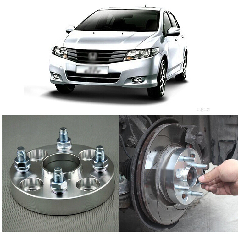

Note 2 : In selecting a wheel with lesser positive offset, one can increase it to the desired level by bolting on a spacer between the alloy wheel and wheel mount hub. Say, if you get a wheel with ET32 offset, then a 6mm to 8mm spacer will bring the wheel out to desired factory settings. Same diameter alloy rim with ET45 will protrude outside by 7mm and nothing can be done to reduce it to factory level. Too much of a wheel/tyre protrusion outside the wheel arch can be DANGEROUS. Such car-model-specific spacers to increase the ET may be available with better wheel/tyre dealers.
Note 3: My HRS alloys specs are 15 x 6,5J, ET+40 and CB 56.1mm with 195/60R15 tyres. Yes it is slightly more outward than stock, but the wheel and tyre combo does not protrude one bit out side the profile of the wheel arches.
3. CB (Centre Bore diameter): 56.1 mm (+1% tolerance may be acceptable. Smaller, it won't fit).
Note 4 : This is the diameter of the hole on the alloy wheel which is inserted into the wheel axle hub.
Note 5 : Similar to the ET offset spacer, a hub ring spacer may be commercially available if the CB diameter is larger than specs (56.1 mm).
Note 6 : Car specific ET spacers will have this dimension incorporated. If a custom made spacer has to manufactured at a local mechanical machine-shop lathe, then this dimensions have to be provided. (I wouldn't take this course)
