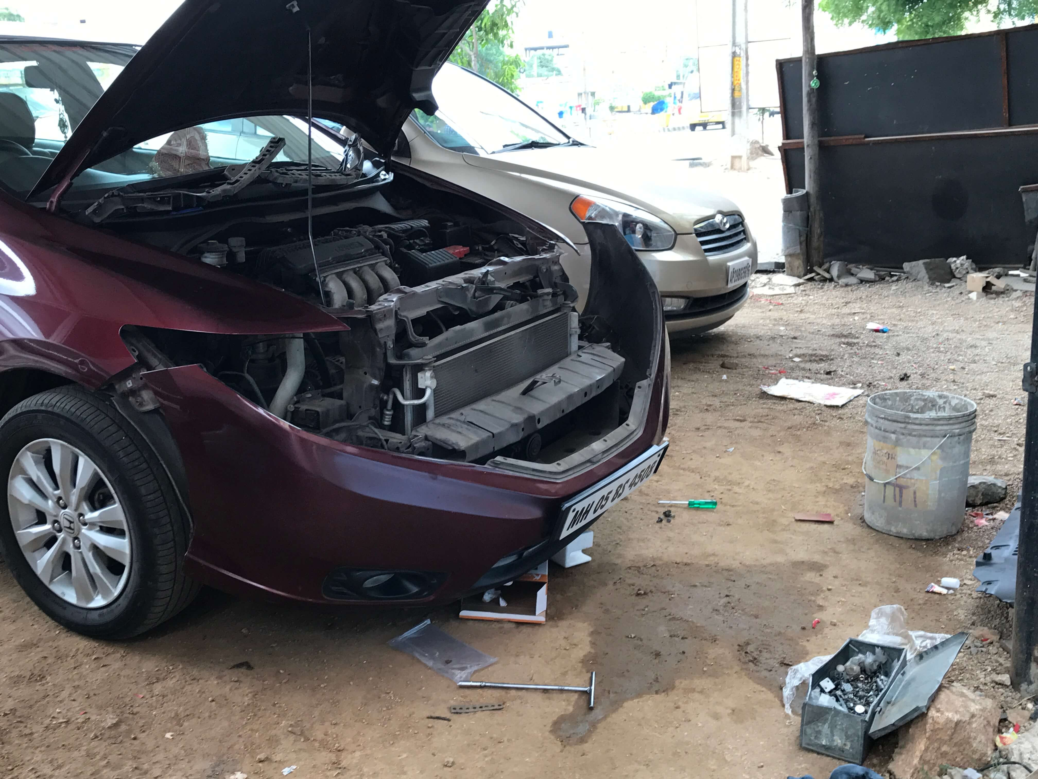

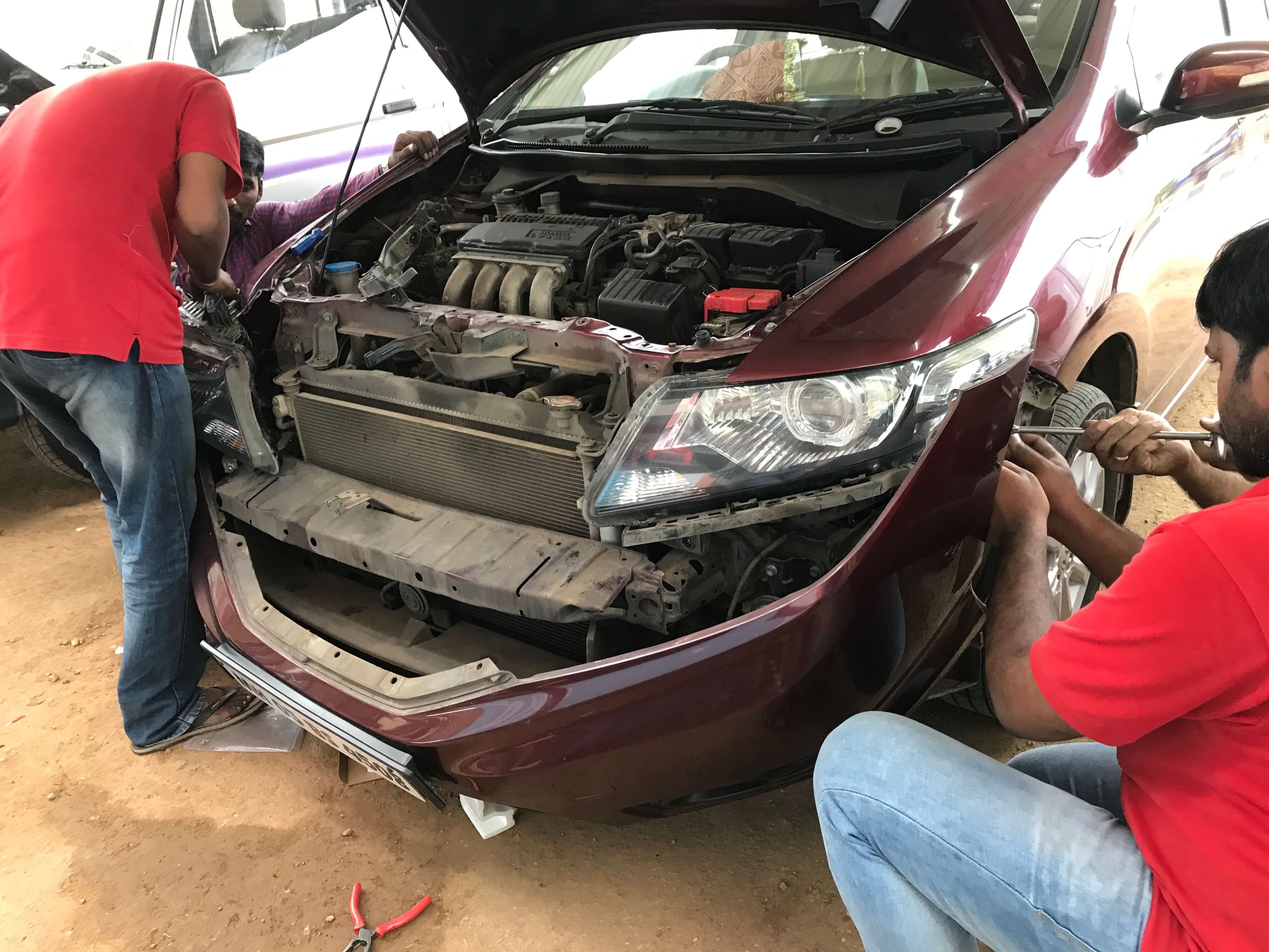

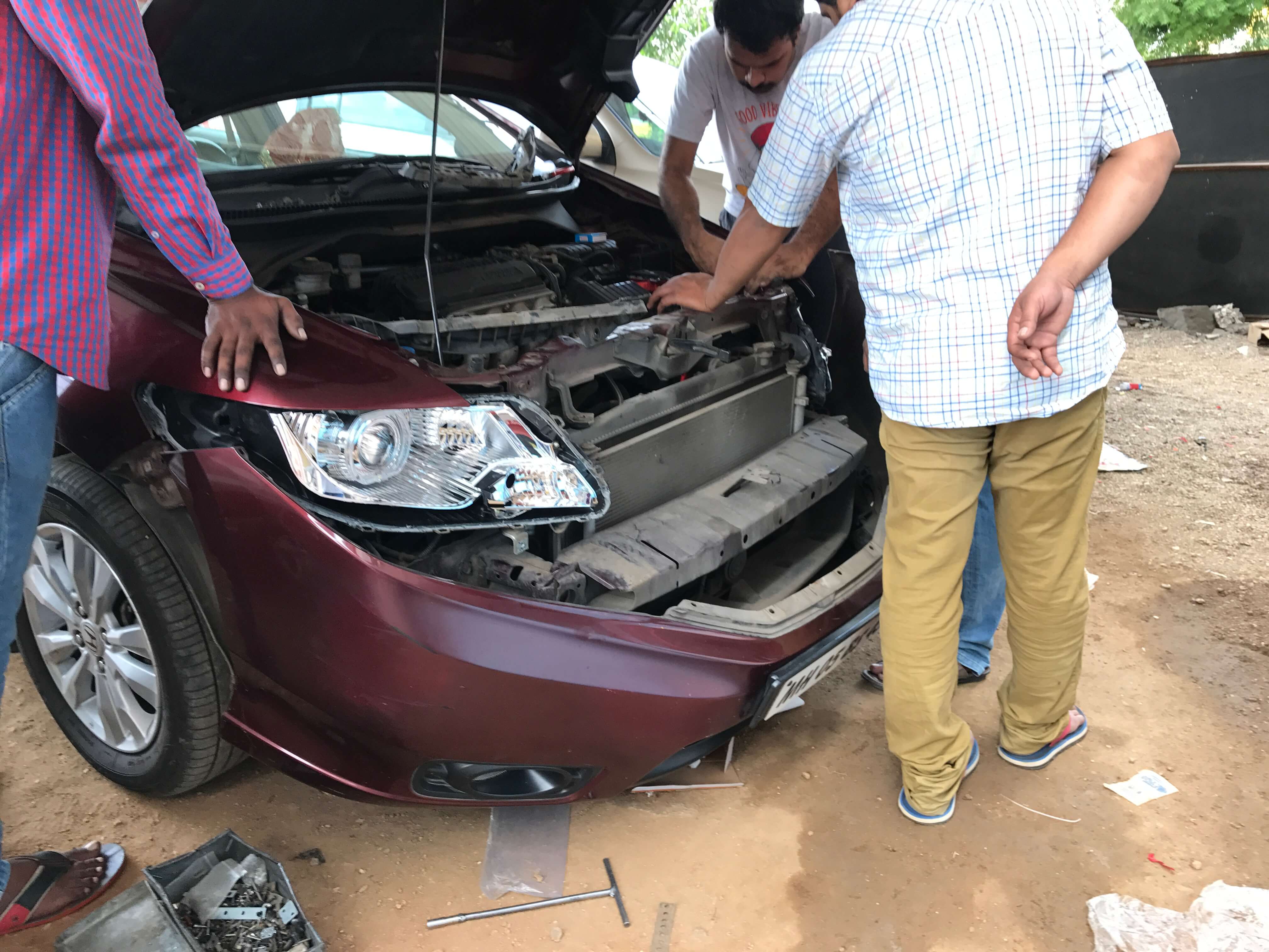

Yesterday finally got it install on the car and here's the pictures from start.
Removal of Bumper & Headlight
Mini Super V3 projector
Headlight assembly opening

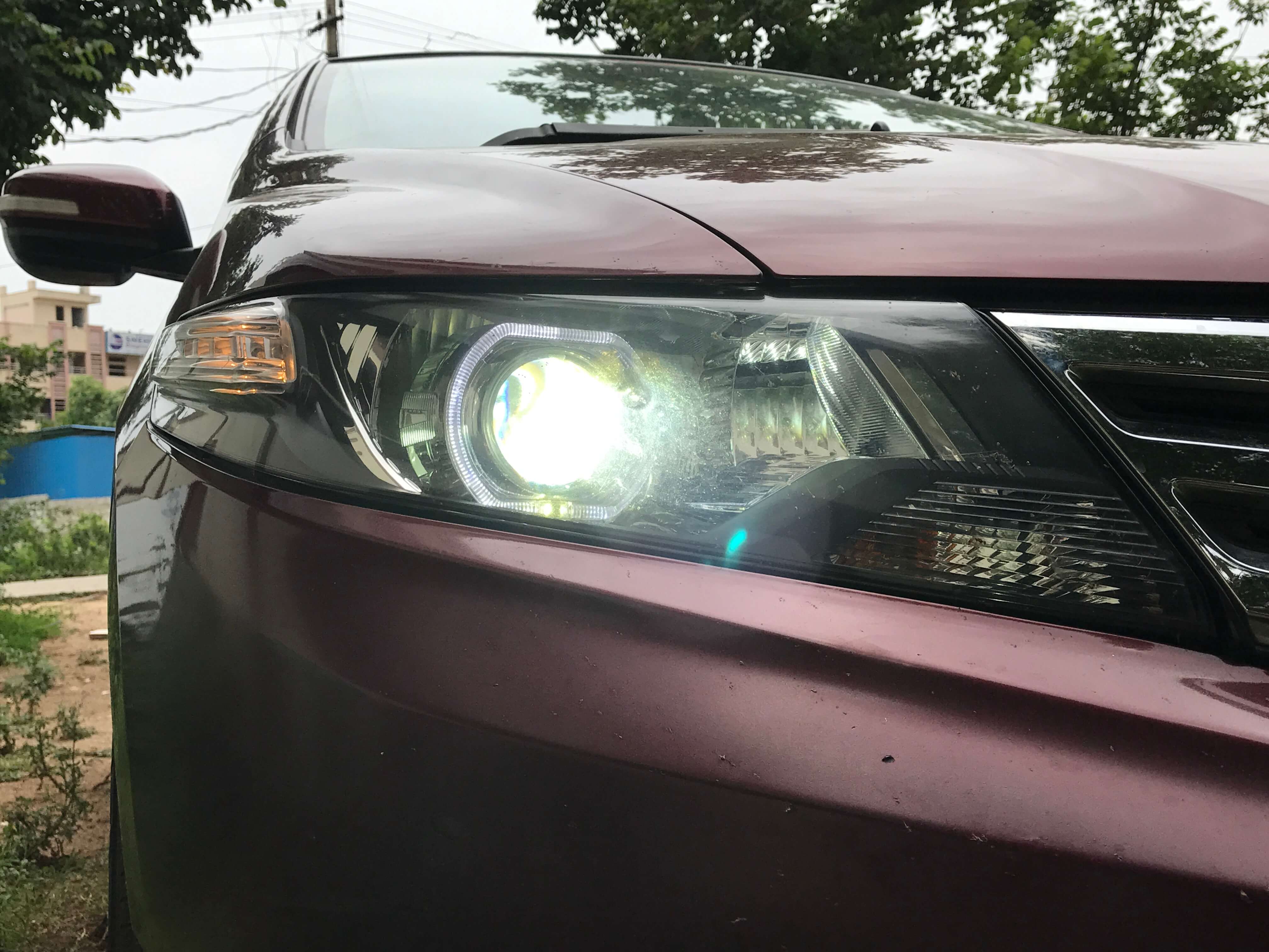

From side
Final Output, Impressive isn't it?
Covering all 3 lanes
Lights from front

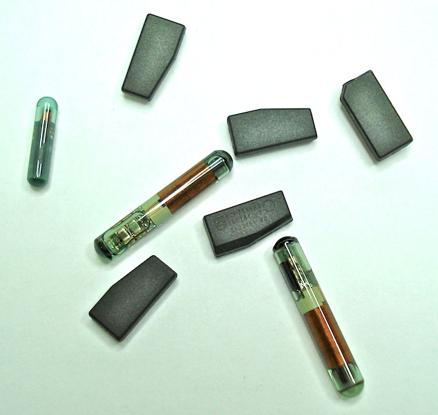

Search on internet for the issue and found out the distance between Immobilizer transponder and key blade is more. Thus it's unable to communicate with car ECU which result car won't start.
So now question is how come this issue in flip key and not in Original key, Here is the answer.
Indian City remote gets integrated transponder on the button circuit where as other car has separate transponder.
The Transponder
Our Car Remote
Other car remote with separate transponder
Flip key housing has grove for separate transponder which is very close to key blade.
But because of integrated transponder in our cars we can't place it at given location which cause this issue. I got very disappointed with this.

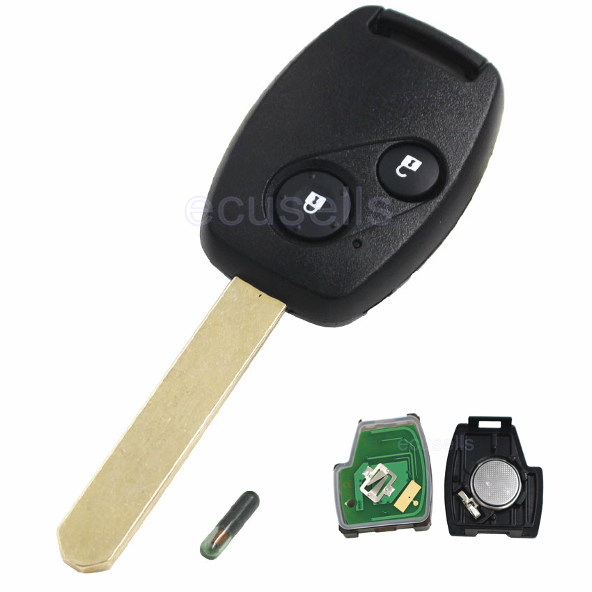

Again started to look more on this and found that separate transponder with remote is available on aliexpress.
Link: https://www.aliexpress.com/item/Rem...5.html?spm=a2g0s.13010208.99999999.264.9U8kum
This may be the solution of the issue but seller mentioned model numbers are not match with the model number of our key.
Out key is, Civic 2button Remote Set and Honda 2 button Remote 313.8MHz-Japan Valeo S0084-A 1-AK 72147-SNB-u010-M2 35111-SNB-306 for 2006 2007 2008 2009 2010 2011 2012 Civic
I am not sure about the frequency but it could be 313.8MHz (From the model number). Transponder used in our key is ID 46.
I am confuse whether to order this key and check because of 2 factors, cost of coding, key cost (although its less) and uncertainty about working.
So please mind that conversion of flip key of our car is not that simple.
